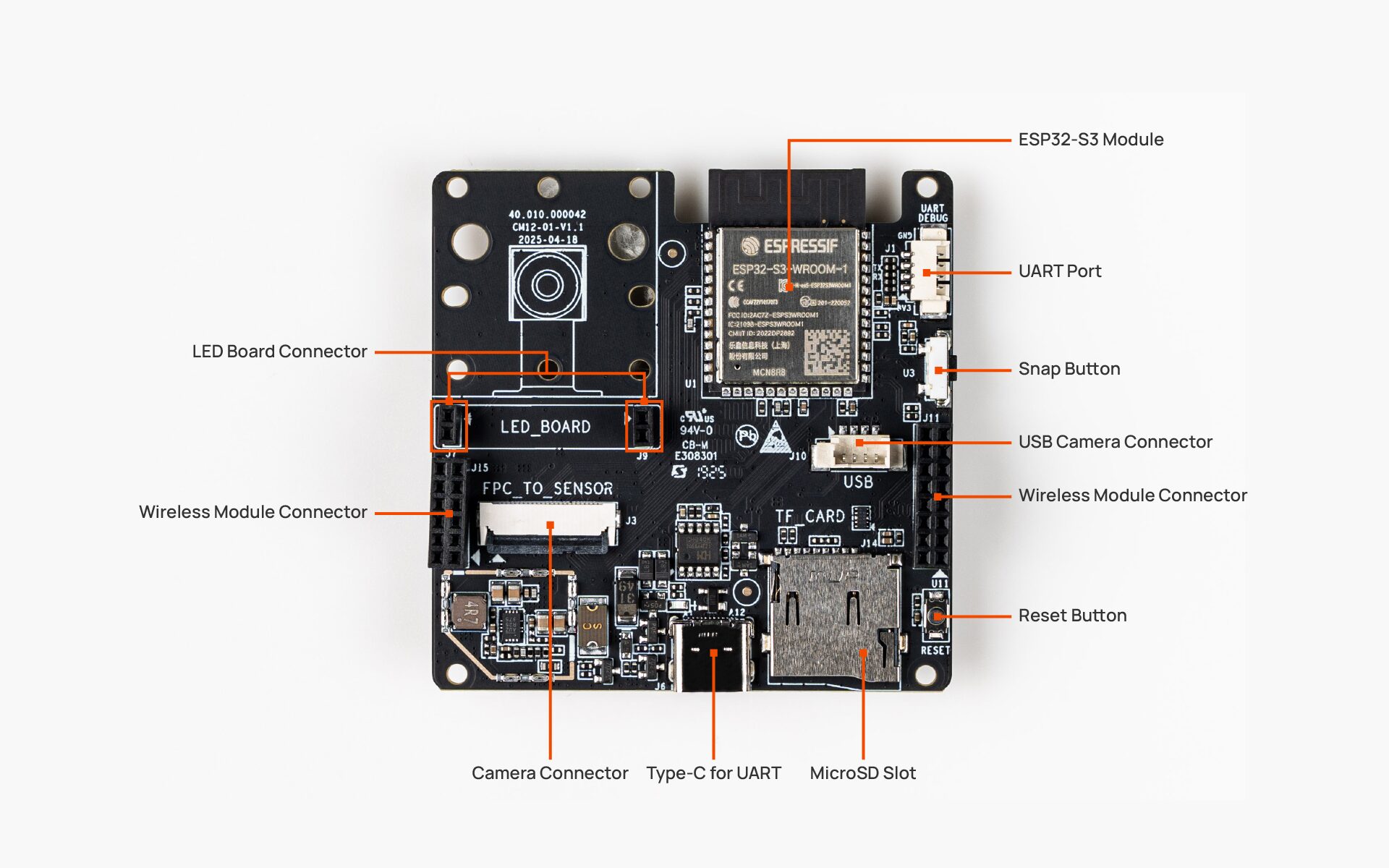

The camera in the device is a 5MP OV5640 sensor with LED flash, microSD storage, USB-C port, PIR and alarm inputs, and a 16-pin header with I²C, SPI, and GPIO expansion capabilities. The lens of the device is replaceable; on top of that, there are also snap/boot/reset buttons for quick access. The device can be powered with 5V USB-C  or up to four AA batteries and comes with a 3D-printable enclosure for easy use.

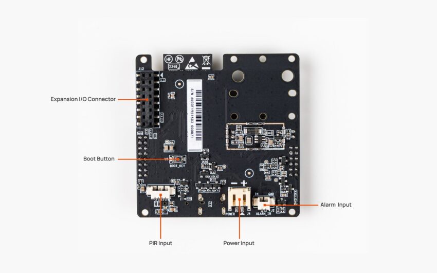

NeoEyes NE101 Overview (Top)
NeoEyes NE101 Overview (Bottom)

    • 4-pin USB camera connector
  • USB: 1x USB Type-C port (power and UART)
  • I/O and expansion:
    • 1x UART connector
    • 16-pin female header with I²C, SPI, GPIO
    • PIR input connector
    • Alarm input connector
    • Snap, Boot, and Reset buttons

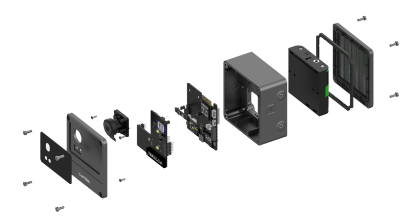

CamThink provides 3D-printable files for the housing along with open-source firmware for custom mounts and features like low-power modes, MQTT data, scheduled capture, and lighting control. There is also a built-in web interface that handles connectivity, image, and capture settings, with documentation and source code available on GitHub.
NeoEyes NE101 Modular Design
