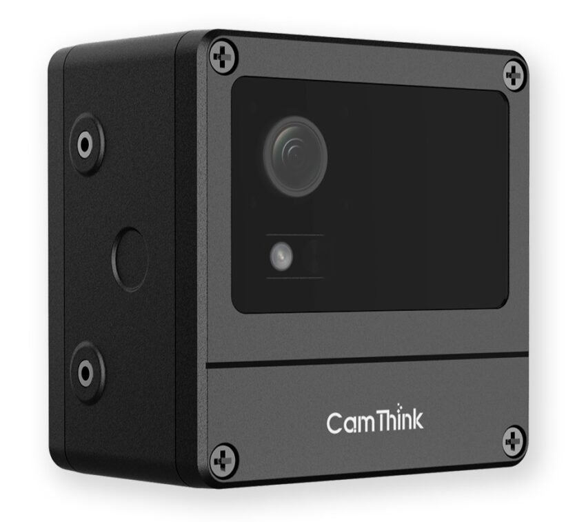

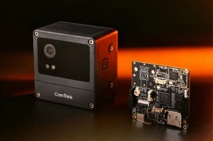

The CamThink NeoEyes NE301 is an ultra-low-power edge-AI camera powered by the STMicro STM32N6 Arm Cortex-M55 MCU with a Neural-ART NPU offering 0.6 TOPS of compute. This enables on-device inference for lightweight tasks such as person detection, gesture recognition, and similar models without relying on cloud processing. It comes with a default 4MP MIPI-CSI sensor and also supports USB camera sensors, while providing 64MB PSRAM, 128MB HyperFlash, Wi-Fi 6, Bluetooth 5.4, audio wafers, USB-C, UART debug, and a 16-pin GPIO header. Power options include USB, battery, or PoE, with an optional 4G LTE module for US or global variants.
Designed for long-term deployment, the edge-AI camera features low power consumption, simple installation, IP67 protection, and strong expansion support. These capabilities make it suitable for Smart Cities (parking occupancy detection, smart advertising), Smart Agriculture (crop and livestock monitoring), and Smart Factory applications such as safety gear inspection and helmet detection.

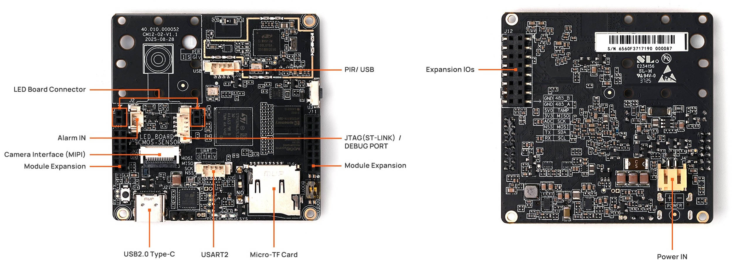

CamThink NeoEyes 301 specifications:
  • Core Processing:
    • MCU: STMicro STM32N6
    • CPU: Arm 32-bit Cortex-M55 @ up to 800 MHz with Arm Helium vector extensions and Arm MVE
    • GPU: Neo-Chrom 2.5D GPU with Chrom-ART Accelerator (DMA2D)
    • NPU: ST Neural-ART accelerator @ 1 GHz, up to 600 GOPS (0.6 TOPS), real-time inference, 3 TOPS/W for fanless operation
    • BPU: Hardware-accelerated H.264 and JPEG encoders up to 1080p@30fps
    • ISP: Dedicated ISP with demosaic and Auto White Balance (AWB)
  • Memory and Storage:
    • 4.2 MB SRAM
    • 64 MB PSRAM
    • 128 MB HyperFlash
    • microSD card slot
  • Camera Features:
    • MIPI CSI-2 connector with 4MP OS04C10 sensor
      • Field of View options: 51° (standard), 88° (wide), 137° (ultra-wide)
    • 4-pin USB/PIR connector for optional SC200AI camera sensor
    • Built-in fill light
  • Audio:
    • 1x Audio Input (Wafer)
    • 1x Audio Output (Wafer)
  • Wireless Connectivity:
    • Wi-Fi 6 and Bluetooth 5.4 (BLE)
    • 12-pin + 16-pin headers for optional Quectel LTE modules:
      • EG912UGL (Global, except North America)
      • EG915QNA (North America)
  • I/O and Expansion:
    • 1x USB-C port (480 Mbps)
    • 16-pin GPIO connector: UART, RS485, I2C, SPI, 2x GPIO, 5V, 3.3V, GND
    • Debug interfaces: USB-C and 4-pin UART
    • Reset, Boot, and Capture/Recording buttons
    • Power (PWR), Status (STS), and Debug LEDs
    • 2-pin wafer for alarm inputs
  • Power and Performance:
    • Power Input: 5V via USB-C
    • Battery support through 2-pin connector (4x AA supported)
    • Optional PoE via add-on
    • STM32U073Kx MCU for independent power management
    • Power Consumption:
      • Sleep: 7–8 µA (via STM32U0 power control chip)
      • Active: 170–180 mA
    • Boot / Wake: Microsecond boot, millisecond wake-up
  • Physical Specs:
    • Dimensions: 77 x 77 x 48 mm
    • Operating Temperature: –20°C to 50°C
    • Humidity: 0–95% RH (non-condensing)
    • Certifications: CE, FCC, RoHS, SRRC
