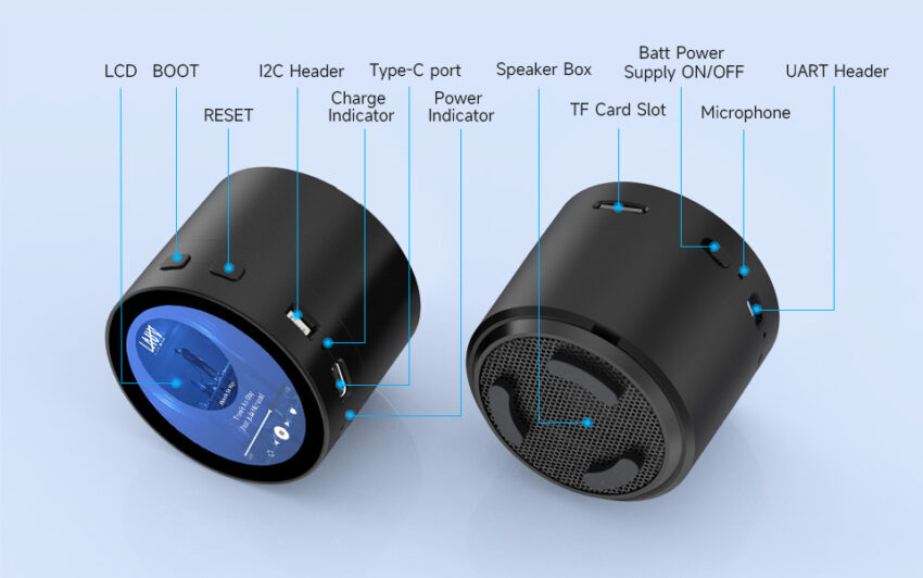

 RP2350-Touch-LCD-1.85C-BOX Interfaces

  • Misc:
    • Reset and BOOT buttons
    • Battery box option (BOX variant)
    • UART connector for debugging

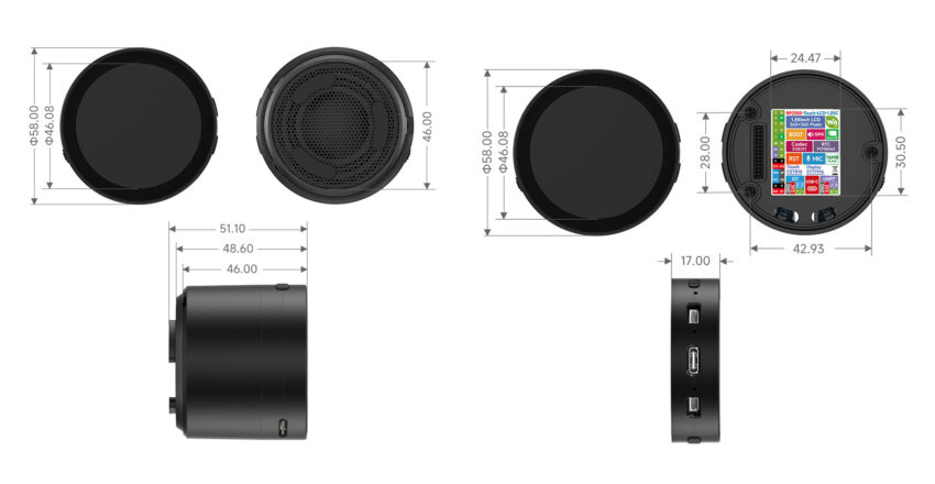

    • RP2350-Touch-LCD-1.85C: 58 mm × 17 mm
    • RP2350-Touch-LCD-1.85C-BOX: 58 mm × 51.1 mm

RP2350-Touch-LCD-1.85C and BOX Dimensions
