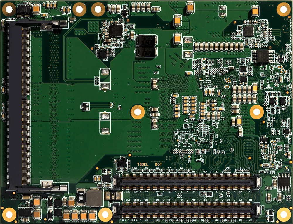

Conga-B7XD & Conga-B7AC COMs
Conga-B7XD
Conga-B7XD
Conga-B7XD board is the first one we will take a look and uses a Xeon D 15xx based core. While, Conga-B7AC, the second one is an Atom C3xxx based. It has an inbuilt memory of DDR4 type, ranging up to 96 GB DDR4 SODIMMs which are available via 3x 32GB-ready sockets. The 12 virtual machines on the system now can use 8GB RAM on each partition.
These new set of modules will excel in applications like augmented reality, airborne platforms for connected aircraft, passenger infotainment, Big Data applications, video surveillance, cloud-based flight data recordings, AI-based virtual assistants for improving pilot productivity and efficiency, and similar because of their demand for higher performance and memory, which is something the new Congatec easily cater for.
Due to its use in highly sophisticated devices, like the cockpit and streaming devices, their durability for temperature ranges and vibrations have builtin. Temperature range is matched from 0 to 60°C or an industrial -40 to 85°C, depending on the processor type. While hard sort of vibration and shockproof material is used, all of this together makes it a powerful device to have.
The modules can be integrated with Intel chips ranging from 4x up to 16x core. Xeon system based module supports the 2.1 GHz Xeon D1577 (Conga-B7XD) whereas, Atom provides 2.0 GHz Atom C3958 (Conga-B7AC) processor configuration. The 3x SODIMM sockets are available for both with an ECC or non-EEC DDR4 2400 MT/s RAM ranging up to 48GB for the Conga-B7XD and 96GB for the Conga-B7AC.
