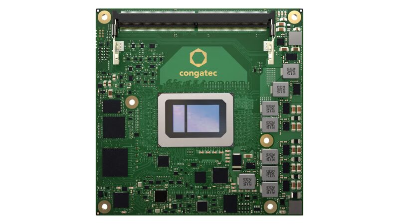

Congatec’s new conga-TC300 is a COM Express compact computer-on-module powered by the Intel Core Series 3 processor
Congatec’s new conga-TC300 is a COM Express compact computer-on-module powered by the Intel Core Series 3 processor. Image used courtesy of Congatec
