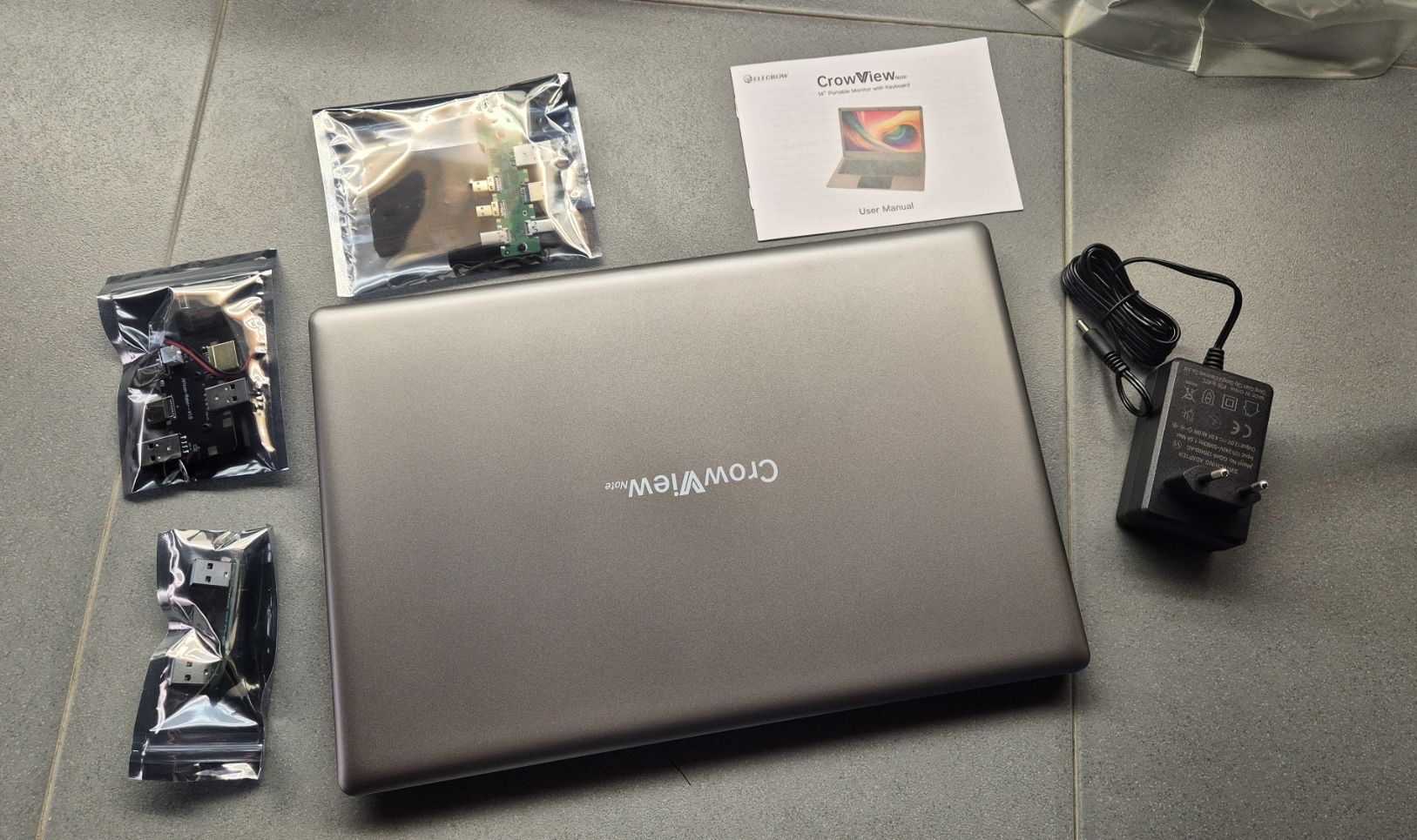

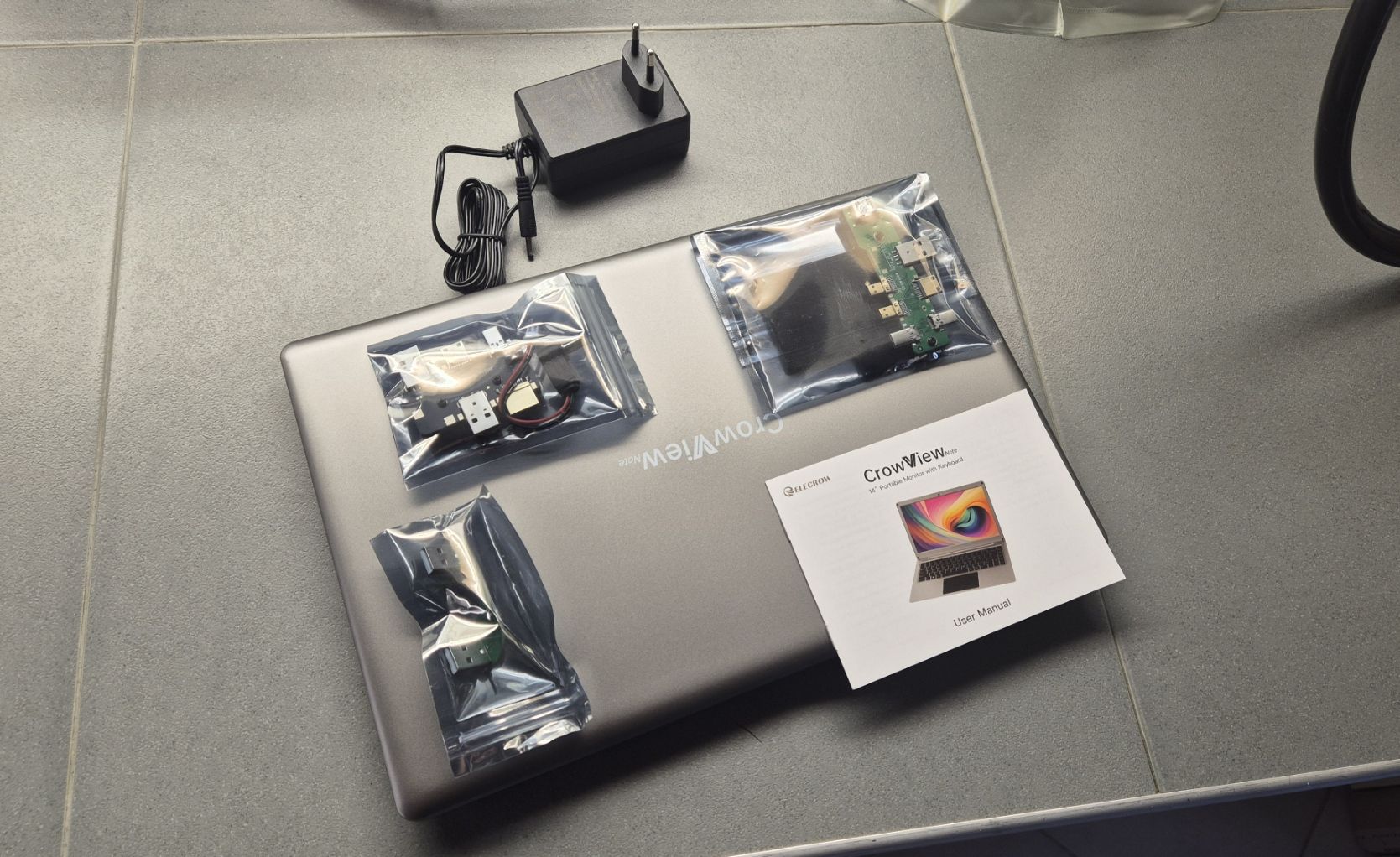

Packaging
The CrowView Note package comes complete with everything you need to get started. In the box, you’ll find the CrowView Note, a handy user manual to guide you through setup and features, and a convenient adapter to ensure compatibility with your devices.
Front view of the packaging
Back view of the packaging
Design and Build
Talking about the design and build quality of the device, it has a sleek and modern design, resembling a compact laptop, this all-in-one design includes an integrated screen, keyboard, touchpad, and speakers. Which makes it a good choice for those users who require a multifunctional portable display. The plastic case quality seems robust and has a nice gray paint finish, which it’s uncertain if it will last for the lifetime of the product. Overall quality feels like a mid-range laptop, and for sure you have to pay attention while carrying it from one place to another.
The package contents and bridge boards

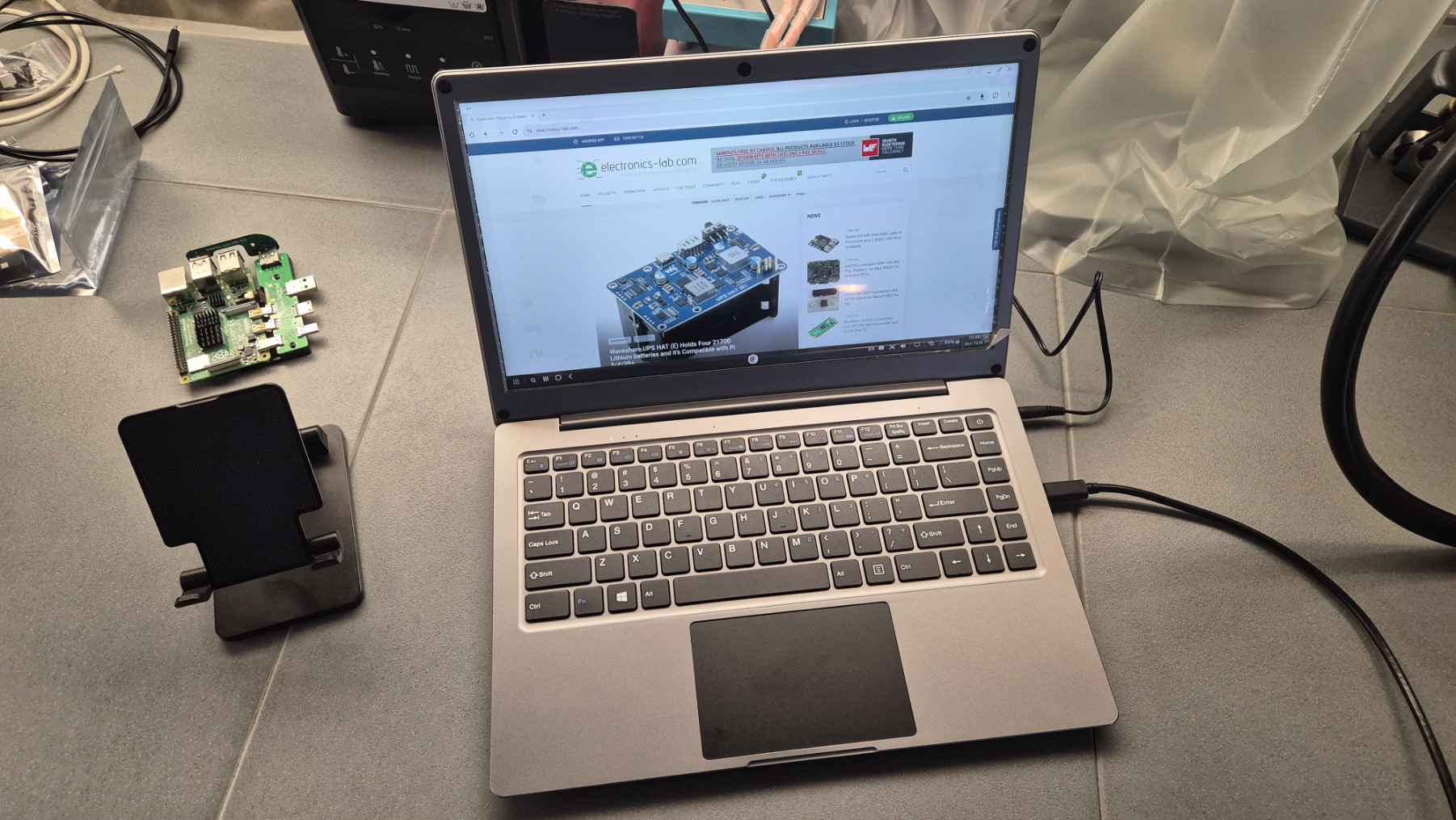

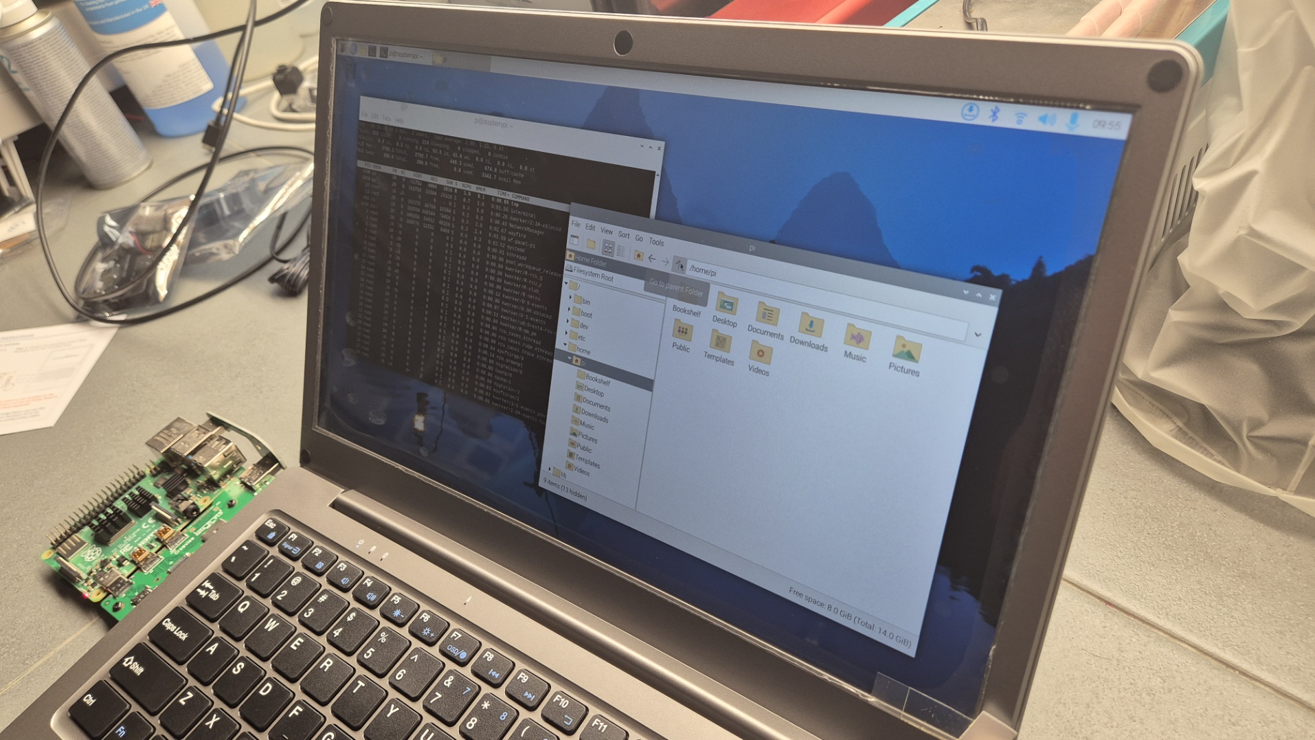

Display Quality
The CrowView Note -14” has a 14-inch Full HD (1920×1080) IPS display with a 100% sRGB color gamut, which translates to vibrant colors and sharp visuals. The screen brightness is 300 cd/m2, which makes it easy to see in different lighting conditions. The standard aspect ratio is 16:9 like most modern displays, providing enough screen for multitasking and media consumption. One effective feature is connecting this device to a smartphone and using it like a desktop, basically turning it into a computer. This is basically for those people who use their phones for work and need a bigger screen to do more things. The quality of the display is sharp and crisp and you would enjoy working on it.
CrowView’s IPS display is clear even from a side view

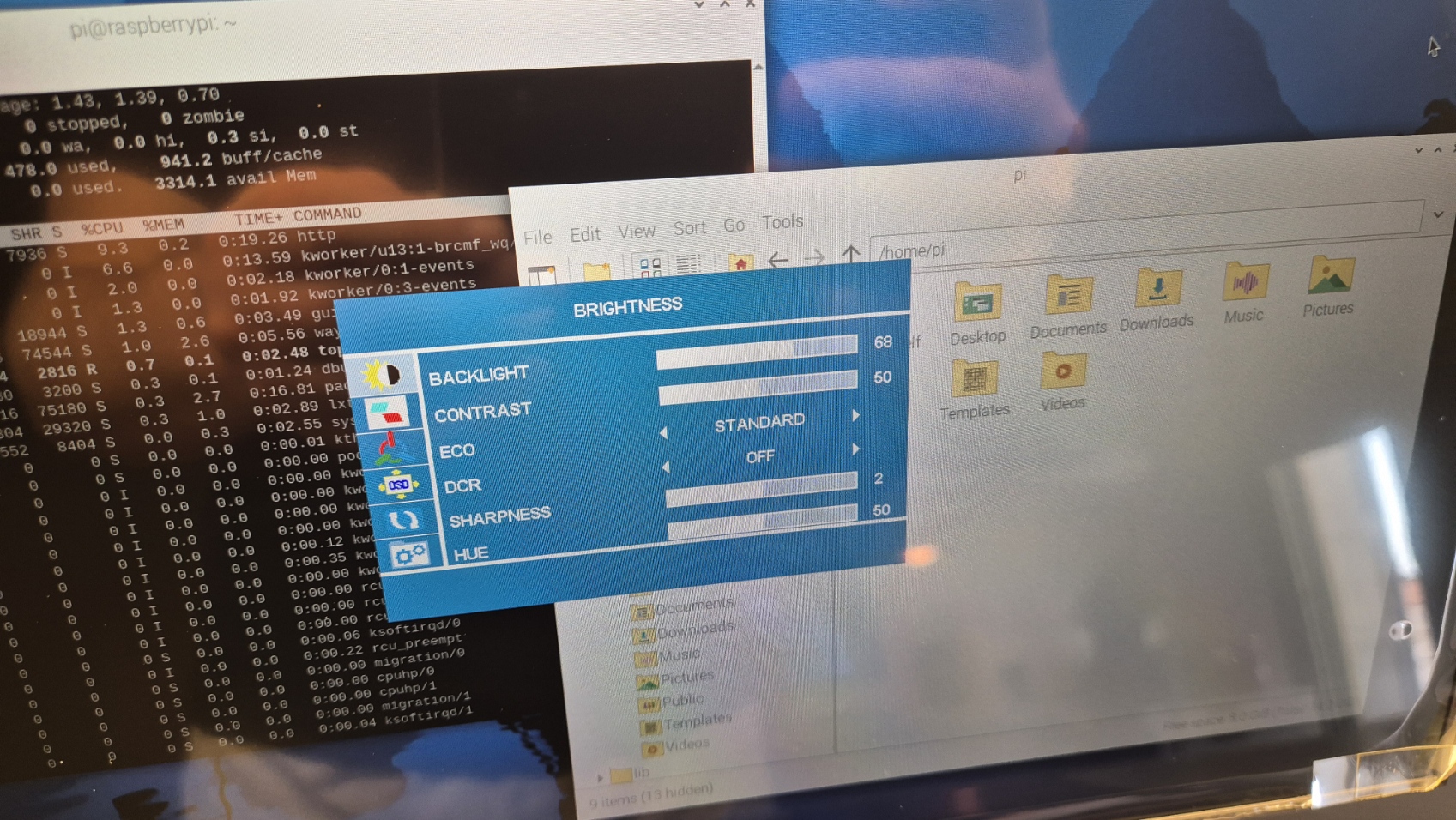

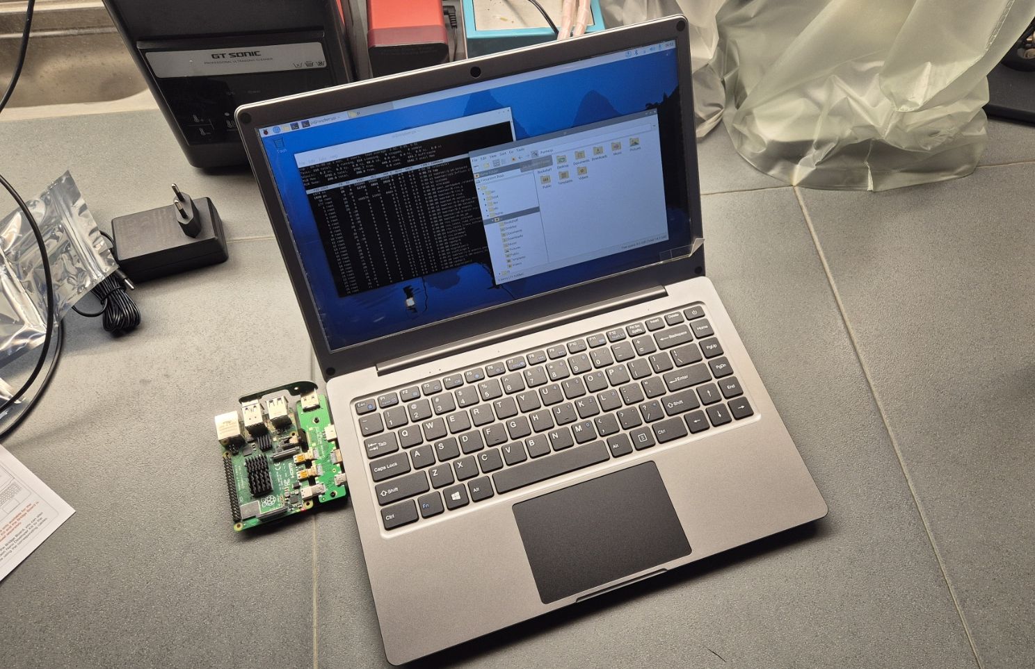

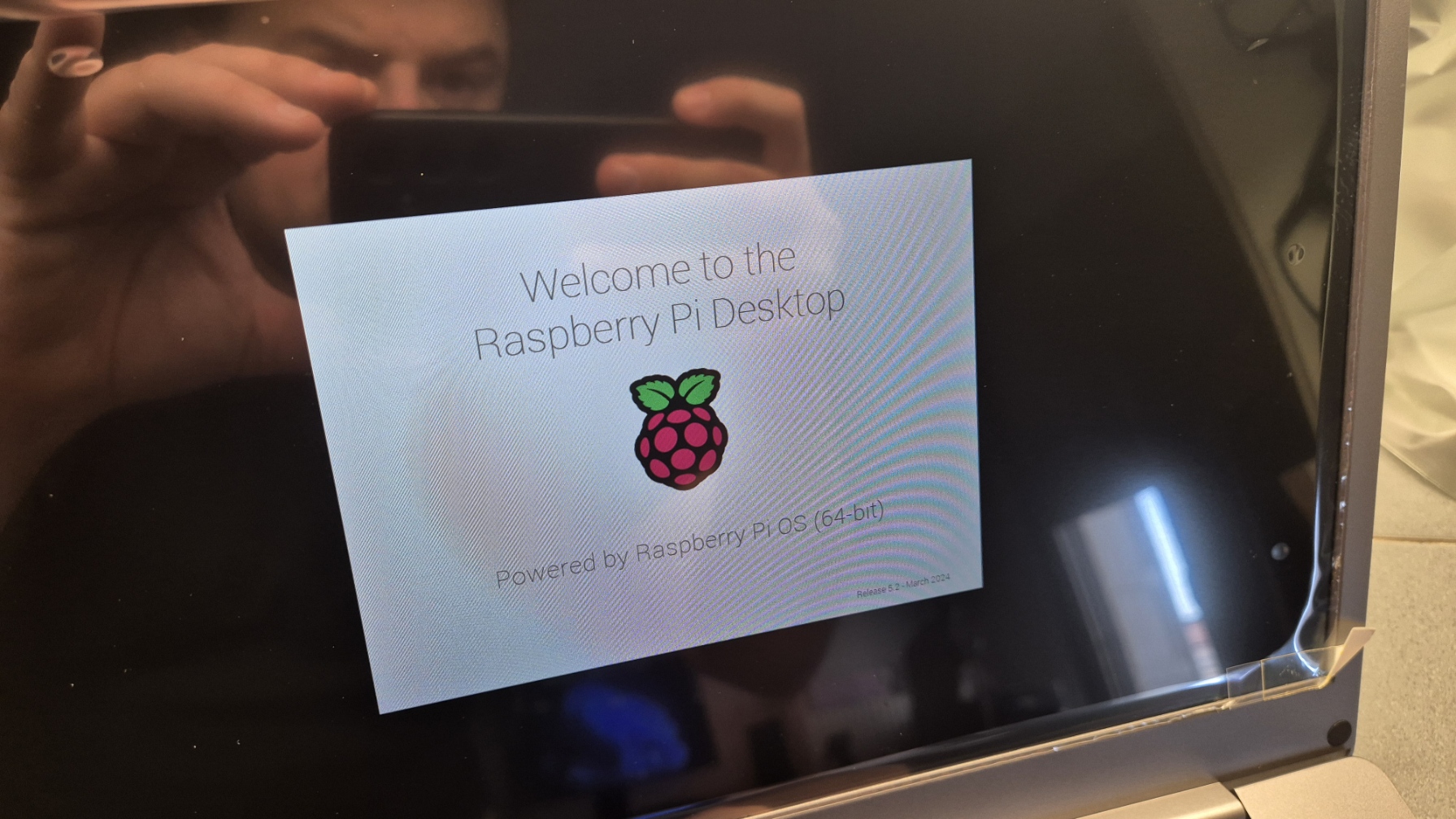

Booting on Raspberry Pi OS (64-bit)
The device supports multiple operating systems, including the latest version of Windows, Mac, Chrome, Linux, Android, Switch, PS4/PS5, and Raspberry Pi. On top of that, the notebook can connect via USB Type C (with DisplayPort Alt Mode) or Mini HDMI, which means you can connect your laptop, Mini PC, and other compatible devices. The list of compatible devices makes this device usable for those who need a portable screen with a keyboard and touchpad for work, Gaming, or Entertainment.

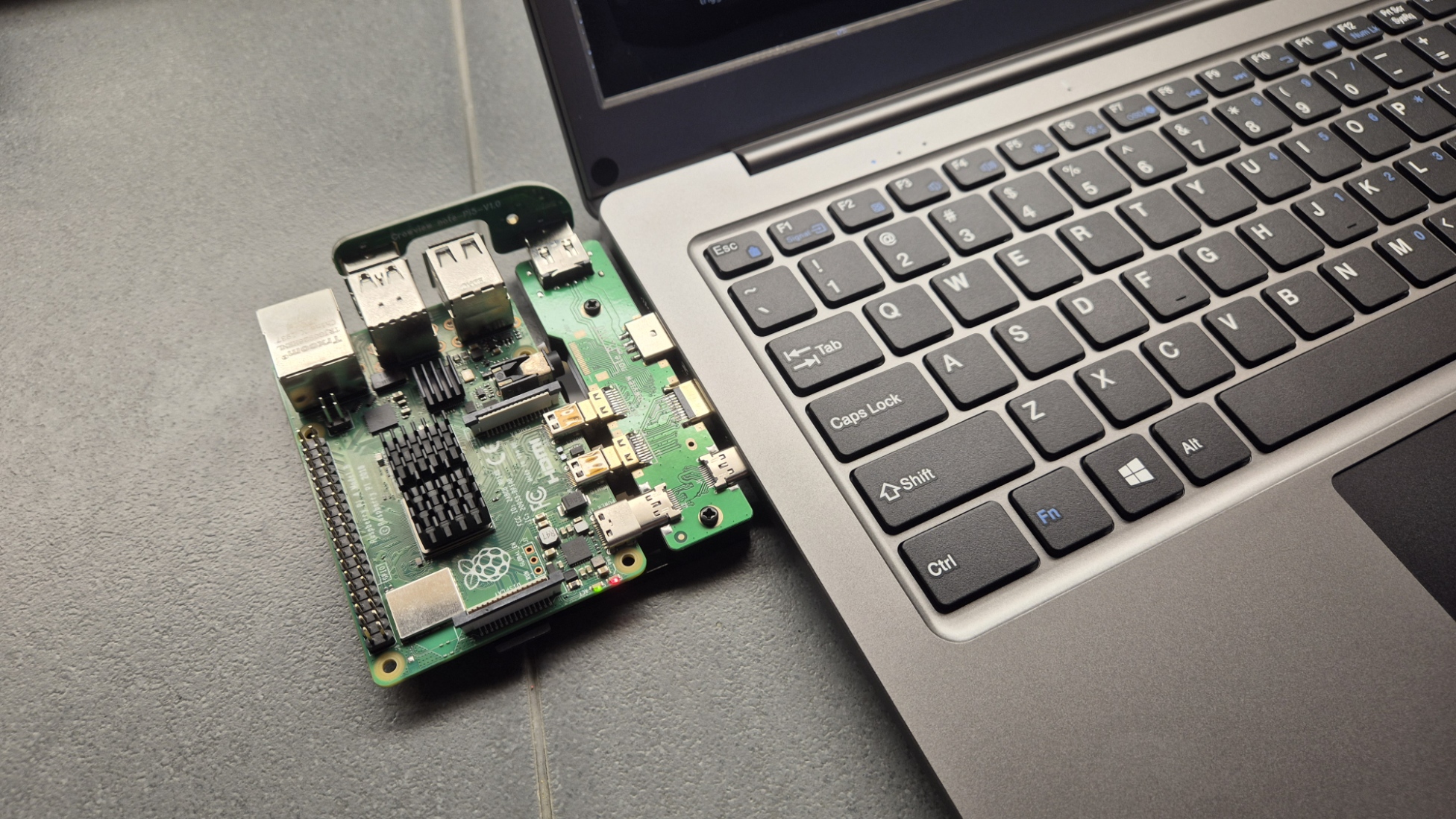

Connectivity

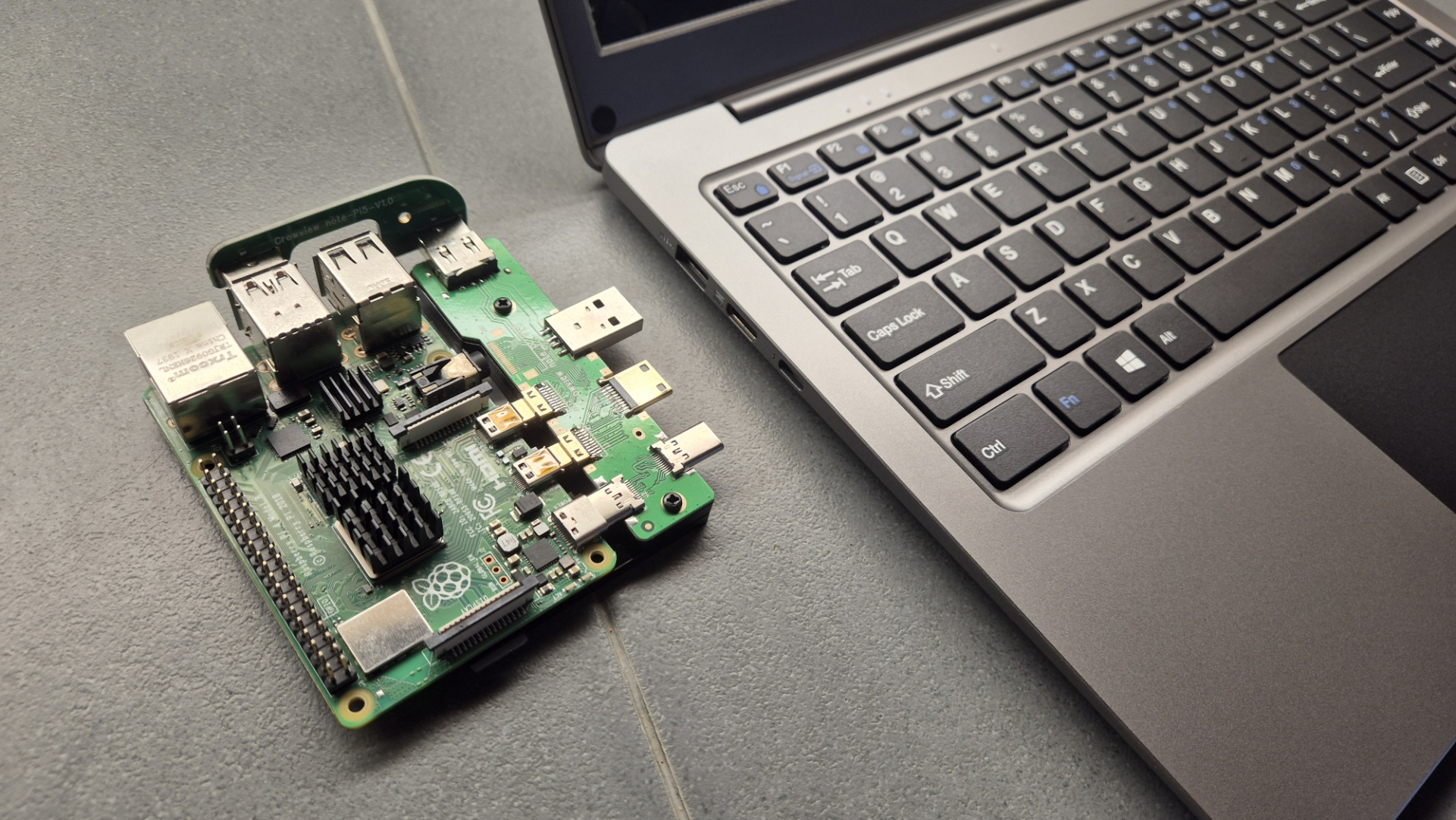

Raspberry Pi 4B connected to Bridge Board
Not only multiple operating systems, the device also supports various SBCs making it a great choice for those using devices like Raspberry Pi, Rock Pi, Beagle Bone, Latte Panda V1, Nvidia Jetson Nano, Orange Pi 4B, and Banana Pi MS. The monitor’s support for HDMI and USB Type C connections ensures that it can easily interface with SBCs that feature these ports. This device works smoothly with other gadgets like gaming consoles and laptops, you can use it for different purposes. It’s also great for people who use those tiny but powerful computer boards called SBCs. Programmers, hobbyists, and teachers can use this device for coding, building projects, or watching videos. The display is very handy because it connects easily to most devices with HDMI or USB-C and gives you a practical solution for increasing your workspace.
Raspberry Pi 4B + Bridge Board connected to the CrowView Note 14″
The CrowView Note connects with multiple devices, making it a very flexible tool for everyone in daily life. It has ports for USB-A (to connect devices and your main computer), Mini HDMI (for video), and Type-C (for both power and data). You can even plug in your headphones for audio and use a separate power supply if needed. This device works smoothly with all sorts of gadgets like laptops, smartphones, and Mini PCs from well-known brands like Apple, Samsung, Huawei, Dell, HP, and Lenovo. Whether you’re super tech-savvy or just starting, the CrowView Note is super handy.
OSD menu is full-featured

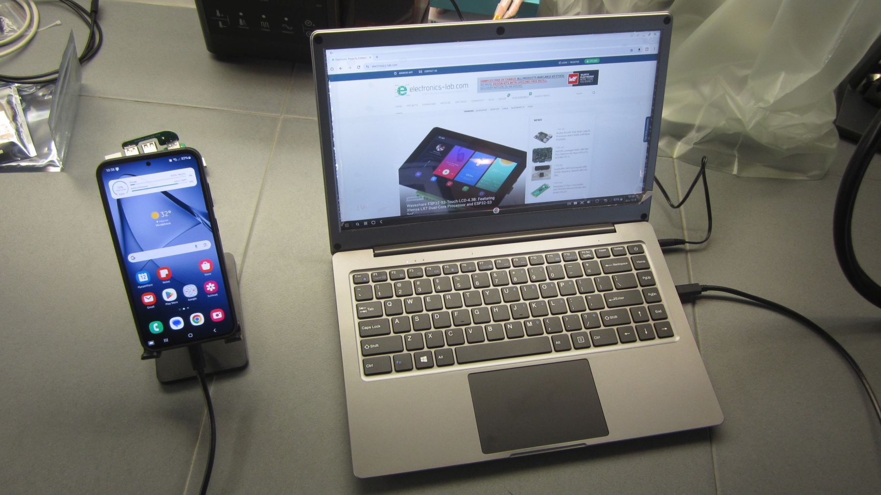

Samsung DeX Mode Support
CrowView Note -14” supports Samsung DeX mode to enable a full-featured Android desktop computer on the go. To use this feature you will need a USB-C cable that supports video/data transmission along with power.
CrowView running on Samsung DeX mode
Samsung DeX mode enables a full featured desktop mode of your mobile device

Samsung DeX running Chrome on Galaxy S24+
