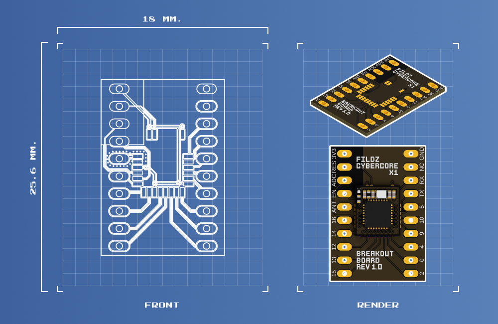

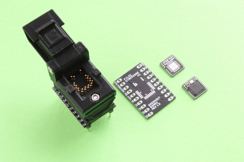

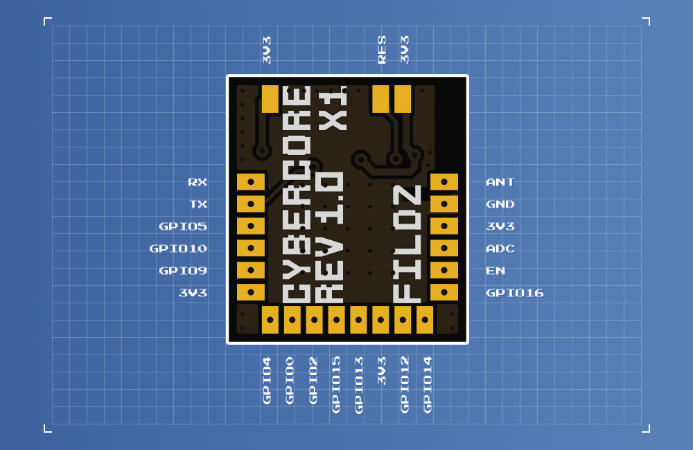

  • Cybercore X1 is just 8.6mm x 9.6mm x 1.8mm and the PCB thickness is just 0.8mm which makes it ultra lightweight.
  • It is powered by Espressif’s ESP8285 highly integrated Wi-Fi SoC. Espressif’s ESP8285 delivers a highly integrated Wi-Fi SoC. It’s the solution that fulfills demands for efficient power usage and compact design in the Internet of Things industry.
  • Cybercore X1 has an integrated antenna for wireless programming and has a range of applications in projects like remote-controlled robots and drones. The Antenna works efficiently up to 20 meters.
  • The Wi-Fi module includes 1Mb memory. Cybercore X1 operates upon a 2.7-3.3V voltage source.
  • The module comes with the latest version of Wi-Fi 6 which enables it to connect various Wi-Fi-enabled devices seamlessly.
Connectivity and Ports

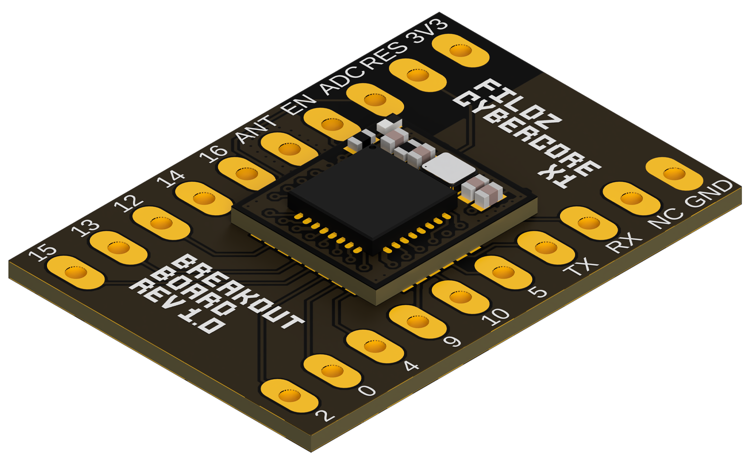

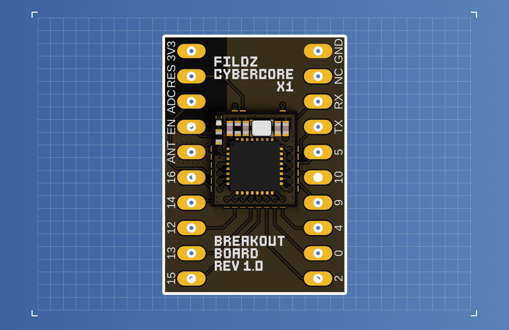

In terms of connectivity, CybercoreX1 has 13 GPIOs which gives many options to users to attach various types of sensors to the module. The module features UART and Wi-Fi for programming and flashing. The users will receive a fully assembled module with all soldered parts and a breakout board. This breakout board will enable Cybercore X1 in various breadboards which are compatible with a 2,54mm pitch. All things considered, users are able to use a development board for adding more features to their projects.
