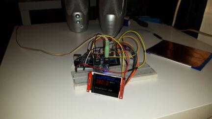

This project is very simple. Here we are using an array of six LEDs and a 128×64 LCD to display the alcohol level. The presence of alcohol is sensed by an MQ-3 alcohol sensor and then analyzed by an Arduino board. We are using Arduino UNO in this project, but any model can do the job.
Three Green LEDs represent that alcohol level is OK and within the safe limit. Two Yellow LEDs are used to describe that safe limit is going to be reached, and you know it well why the Red LED is there. In fact, those LEDs are used just to give you a quick idea. If you want to know the exact value, the display is there for you.
You can tweak the program and re-calibrate the breathalyzer. But you must remember that breathalyzer doesn’t precisely measure your blood alcohol content, rather it estimates a value from the amount of alcohol in your breath.

Breathalyzer Circuit On Breadboard
You can make the circuit also on PCB or Veroboard. But for the prototyping purpose, the breadboard is the best choice. You can see how straight forward the connections are.

Test It:
I must not recommend you to drink alcohol just for testing the breathalyzer. Rather get a towel and spray alcohol on it. Now hold the towel in front of the sensor. Move it back and forth to observe the change in reading. It may take a while for the breathalyzer to stabilize.
