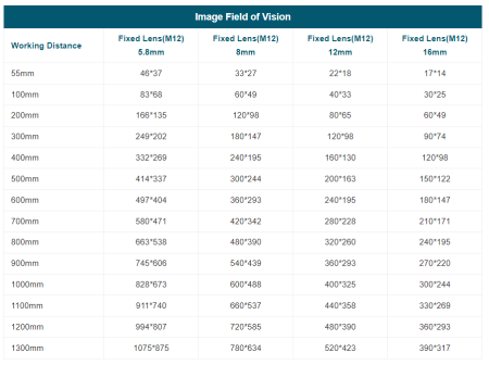

The camera uses a 2.0MP sensor with a 2.3MP upgrade option. The sensor is capable of taking monochrome images with its global shutter. This sensor has a capture speed of 70 frames per second, making it ideal for quick image capture in industrial areas. It also offers optional polarizers in half or full-setup configurations.
Now looking at the ED-AIC2100 mode it features an optional liquid module zoom and supports various C-Mount lenses, ensuring versatile focus adjustments. This device also has a 2.0MP monochrome global shutter sensor capable of recording at 60 Frames Per second. They come with adjustable and fixed lenses, controlled LED lighting, and optional polarizers, making them very adaptable for different uses.

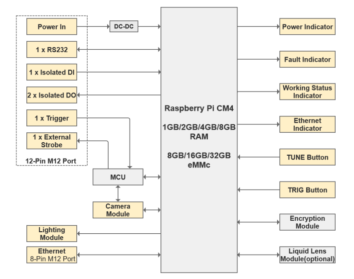

  • Memory: Up to 8GB LPDDR4
  • Storage: Max 32GB eMMC
  • I/O: 4 isolated GPIOs, 1 RS232, 1 Ethernet (M12 port)
  • LEDs: Status, Power, Fault, Read, Ethernet Status
  • Operating Temperature: 0℃ to 45℃
  • Power: 10-30 VDC, Max 30W
  • Certifications: FCC, CE
  • Mechanical: 70x54x50mm, Weight: 150g
  • Housing: Industrial Aluminum
