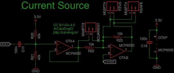

Orlando Hoilett has built his new biomedical Arduino 101 shield: Biomed Shield, in order to allow students, educators, and hobbyists to learn about bio-medicine by monitoring heart rate, temperature, and other physiological metrics. To build this shield he used the following components: AD5933 MLX90614 Microchip Rail-to-Rail Input/Output Dual Op-Amp MAX30101: a specialized integrated circuit that is able to perform reflectance photoplethysmography Photocell Thermistor AD8227 Orlando measured heart beats using transmission photoplethysmography using MAZ30101, where a light shines through an extremity such as a finger and a detector measures the amount of light that passes through.

Orlando measured heart beats using transmission photoplethysmography using MAZ30101, where a light shines through an extremity such as a finger and a detector measures the amount of light that passes through. When the heart pumps blood through the body,  a momentary increase in blood volume in the fingers happens. As a result, the amount of light that passes through the finger changes with this changing blood volume and is detected by the photodetector.
Bioimpedance Measurement
Bioimpedance is can be another class of bioelectrical measurements where we measure the impedance of the body instead of measuring the electrical signals produced by the body with the help of AD5934 impedance analyser chip. He is also measuring body temperature with the MLX90614 and measuring the amount of light using  a CdS Photocell.
