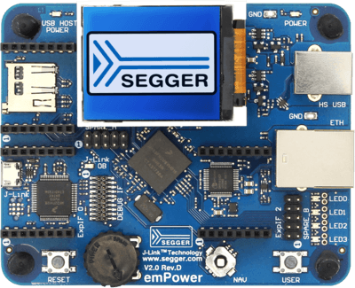

SEGGER Evaluation Software for SEGGER emPower
