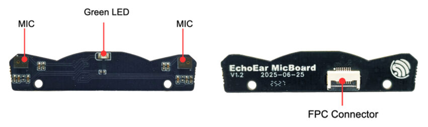

Espressif EchoEar AI chatbot EchoEar MicBoard
EchoEar MicBoard

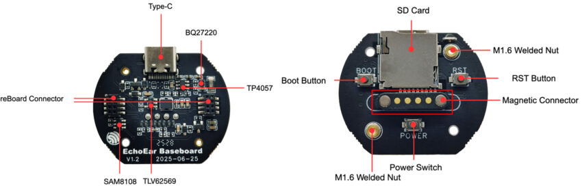

Espressif EchoEar AI chatbot EchoEar BaseBoard
EchoEar BaseBoard

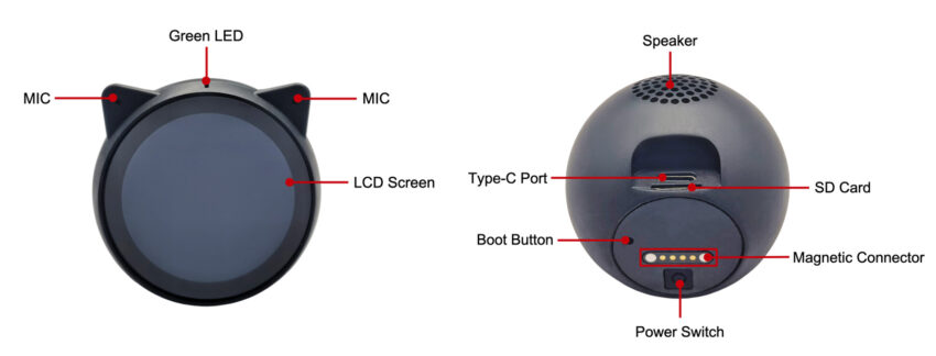

EchoEar Front and Back
