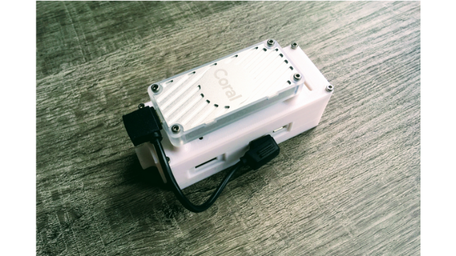

There have been several designs using Google’s Edge TPU, but this specific project, Maple Syrup Pi Camera, an AIoT smart camera has caught the eye of the makers’ community due to its use of Raspberry Pi Zero W for AI inference at the edge. We don’t usually see these SBCs used to run inference at the edge due to their low processing capabilities. For specific AI purposes, we have several powerful SBCs in the market designed for this use case. [Ricardo] has developed this smart camera that uses a Coral USB accelerator that is connected with the Raspberry Pi Zero W.

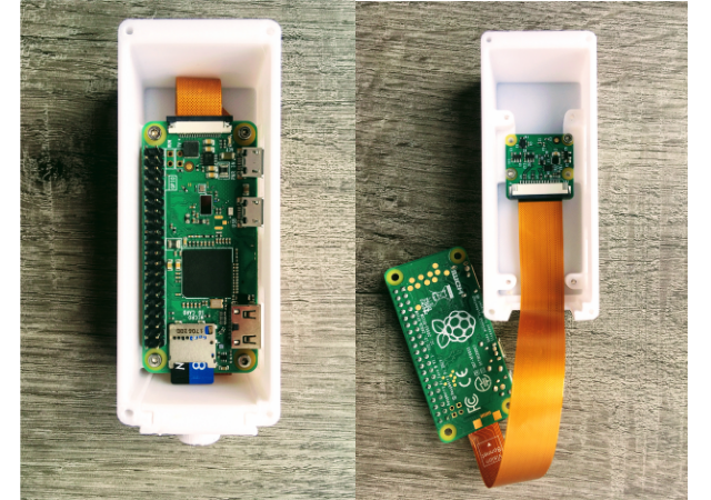

This interesting project of exploring the power of Raspberry Pi Zero W has employed the Raspberry Pi Camera along with the Raspberry Pi Zero flat cable. The software provided by the designer on GitHub, recommends you to use 8GB of storage Micro SDCard but it depends on the firmware you will be using. Since the SBC does not come with a power protection circuit, the board connects the USB power directly to the power supply. “That means the Coral USB Accelerator will be directly connected to the power supply, allowing it to drain as much current as of the power supply and impedance of microUSB + PCB traces allow it,” [Ricardo] explains:
In my experiments, the Maple-Syrup-Pi-Camera consumes around 160mA at 5V when idle (800mW).
