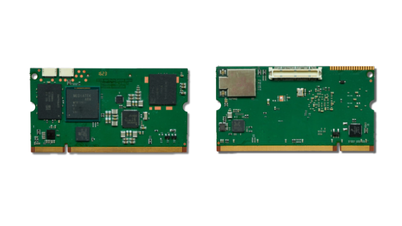

SECO has built its SOM-Trizeps-X-Genio360/360P in a compact 67.6 mm × 36.7 mm form factor
SECO has built its SOM-Trizeps-X-Genio360/360P in a compact 67.6 mm × 36.7 mm form factor. Image used courtesy of SECO

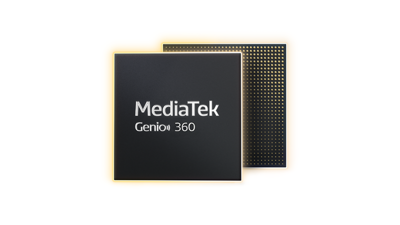

MediaTek’s Genio 360 and 360P are 6 nm, value-tier IoT processors designed to deliver practical edge AI capabilities for cost-sensitive embedded applications. Their integrated NPU delivers over 8 TOPS of AI performance, allowing local inference for tasks ranging from image classification to generative AI—no cloud connection required. The two SoCs are electrically pin-to-pin compatible, providing developers with a straightforward upgrade or substitution path without hardware redesign.
SECO’s SOM-Trizeps-X-Genio360/360P modules are built on MediaTek's Genio 360 and Genio 360P IoT processors
SECO’s SOM-Trizeps-X-Genio360/360P modules are built on MediaTek’s Genio 360 and Genio 360P IoT processors. Image used courtesy of MediaTek

The SOM-Trizeps-X-Genio360/360P SOMs measure 67.6 mm × 36.7 mm and connect to carrier boards via a standard low-cost SODIMM connector, a deliberate choice to keep both the BOM cost and mechanical complexity down in price-sensitive designs. Typical power consumption sits below 5 W, which simplifies thermal management in fanless or sealed enclosures.
The module supports a temperature range of -40°C to 85°C (industrial version), making it suitable for deployment in environments where commercial-grade components would fall short. SECO also emphasizes long-term pin and software compatibility across the Trizeps family, which matters for designs with extended production lifetimes.
