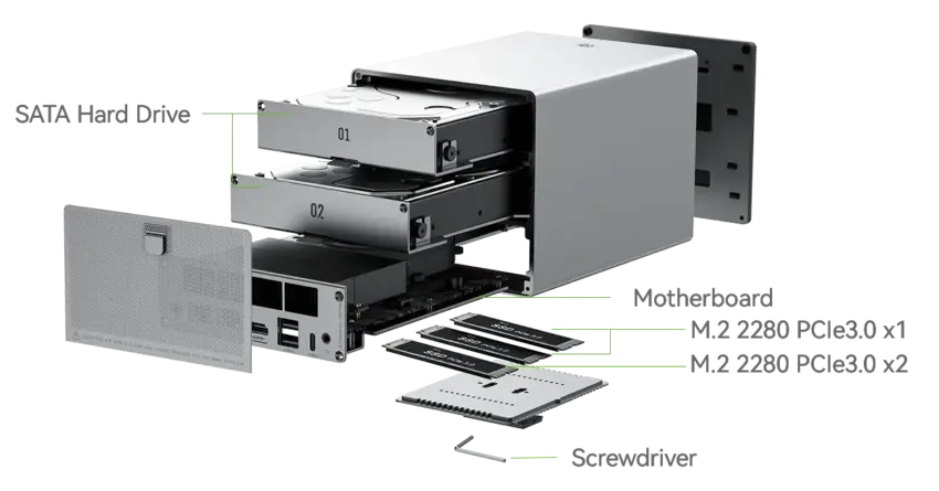

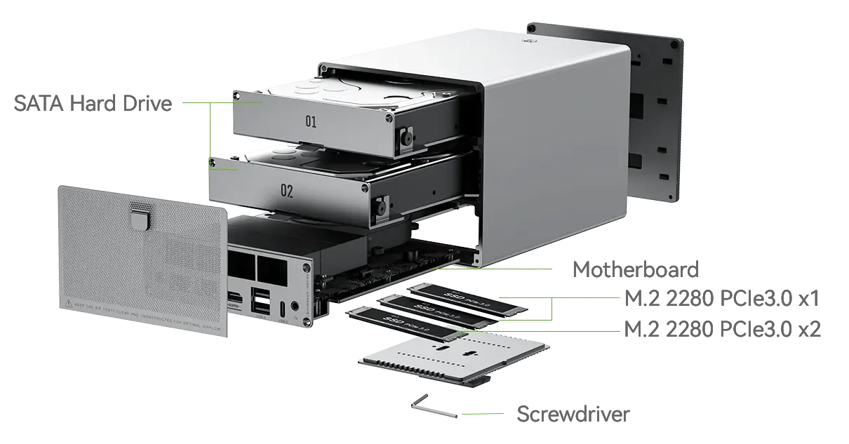

The Beelink ME Pro Hybrid NAS Mini PC expands Beelink’s hardware lineup with a modular storage-focused design built around the Intel N95 (Alder Lake-N) or Intel N150 (Twin Lake) processor. This compact two-bay hybrid NAS and Windows 11 mini PC combines computing and high-capacity storage in a single chassis, featuring three M.2 2280 NVMe SSD slots and two 3.5-inch/2.5-inch SATA drive bays with support for up to 30TB drives. Designed for users who need higher storage density without moving to traditional rack-mounted NAS systems, the ME Pro offers both two-bay and four-bay NAS configurations while maintaining a small footprint. Its unique “DIY drawer” structure allows motherboard upgrades, making it a flexible solution for home labs, media servers, small office storage, and edge computing deployments.
Three M.2 NVMe slots—two with a PCIe 3.0 x1 interface and one with a PCIe 3.0 x2 interface—are available on the ME Pro with the Twin Lake SoCs. In addition, the system has a 3.5 mm audio jack, USB-C (10 Gbps), USB-A, HDMI 2.0, Wi-Fi 6, Bluetooth 5.4, and up to 16 GB of LPDDR5 memory. Better thermals and noise control are made possible by an internal blower-based cooling system, an aluminum chassis with thermal pads, and anti-vibration drive mounts. Home NAS, media server, Proxmox/TrueNAS host, small office file server, lightweight virtualization, backup appliance, and small desktop PC are among the target applications.

    • 2× 2.5-inch or 3.5-inch SATA bays for HDDs (up to 30 TB per drive, 60 TB total)
    • 1× PCIe 3.0 x 2 NVMe slot M.2 2280 (up to 4 TB)
    • 2× PCIe 3.0 x1 NVMe slots M.2 2280 (up to 4 TB each)
    • Comprehensive storage of up to 72 TB (depending on configuration)

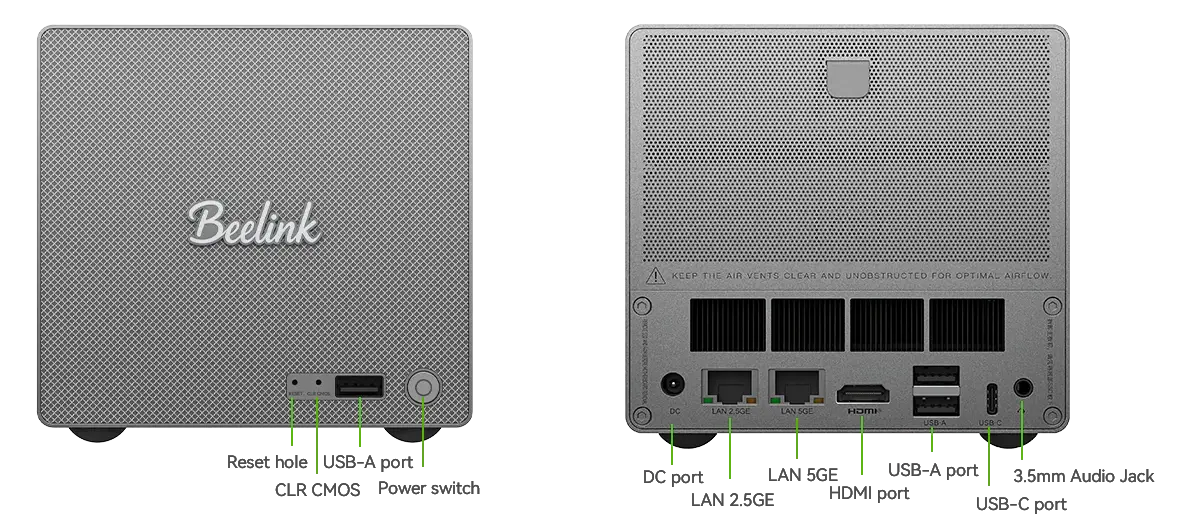

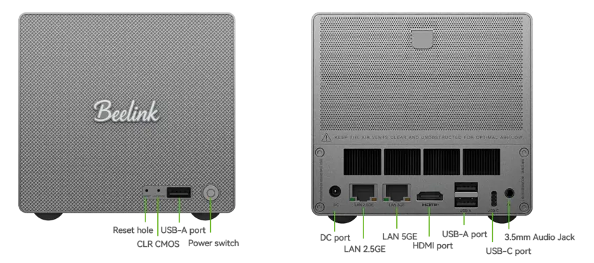

  • Networking:
    • 5GbE RJ45 jack via Realtek RTL8126 controller
    • 2.5GbE RJ45 jack via Intel i226-V controller
    • Wi-Fi 6 and Bluetooth 5.4
    • Supports link aggregation, virtualization, and software routing
  • USB:
    • 1x USB 3.2 Gen 2 (10Gbps) Type-C port
    • 1x USB 3.2 Gen 2 (10Gbps) Type-A port
    • 2x USB 2.0 Type-A ports
  • Misc:
    • Power button, Reset and CLR CMOS pinhole buttons

    • Tool-free slide-out motherboard for upkeep and dust removal
