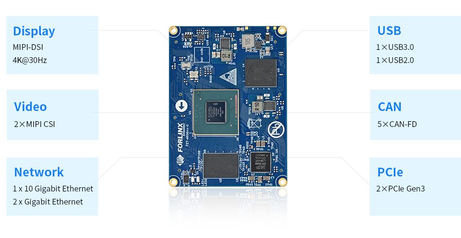

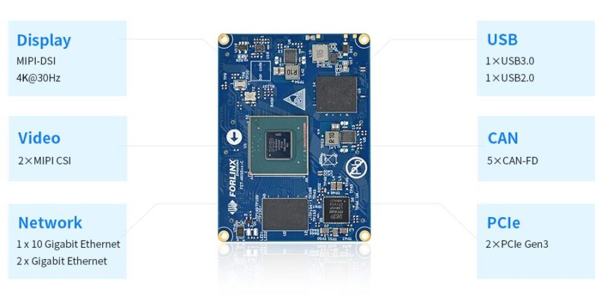

Forlinx has introduced the FET-MX9596-C, a compact and high-performance NXP i.MX95 SoM designed for next-generation edge computing and industrial applications. Built around the NXP i.MX9596 processor, this module targets demanding workloads in automation, automotive systems, and AI-driven embedded platforms. It combines heterogeneous processing, integrated AI acceleration, and extensive I/O in a small 50mm × 68mm form factor.
At its core, the NXP i.MX95 SoM uses a multi-domain architecture with six Cortex-A55 cores clocked at 1.8GHz for application processing, alongside a Cortex-M7 core at 800MHz for real-time control and a Cortex-M33 core at 333MHz for security tasks. This architecture allows developers to run high-level applications, deterministic control loops, and safety functions in parallel without resource conflicts.

FET-MX9596-C SoM Specifications:
  • NXP i.MX9596 processor (6x Cortex-A55 @ 1.8GHz + Cortex-M7 + Cortex-M33)
  • Integrated 2 TOPS NPU for edge AI inference
  • Mali-G310 GPU with OpenGL ES 3.2, Vulkan 1.2, OpenCL 3.0
  • 8GB LPDDR4x RAM and 64GB eMMC storage
  • Video support: H.264/H.265 encode/decode up to 4K@30fps
  • Dual MIPI CSI-2 camera input and MIPI-DSI display output
  • Up to 2x Gigabit Ethernet + 1x 10Gb Ethernet with TSN
  • 2x PCIe Gen3 interfaces for high-speed expansion
  • Up to 5x CAN-FD interfaces for automotive and industrial networks
  • USB 3.0 and USB 2.0 support (host/device mode)
  • Wide operating temperature range: -40°C to +85°C
  • 320-pin board-to-board connector (4x 80-pin, 0.5mm pitch)
FET-MX9596-C SoM Interfaces
The module focuses heavily on AI and multimedia processing. The integrated 2 TOPS NPU handles machine learning inference directly on-device, which reduces latency and removes cloud dependency. The Mali-G310 GPU supports modern graphics APIs, while the ISP and VPU enable high-quality image processing and 4K video handling. These capabilities make the NXP i.MX95 SoM suitable for applications like smart vision systems, robotics, and advanced HMIs.

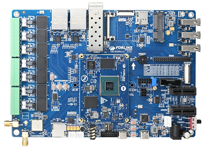

OK-MX9596-C Single Board Computer
Forlinx also offers the OK-MX9596-C development board built around the same NXP i.MX95 SoM, designed to speed up evaluation and prototyping. The board follows a SoM + carrier architecture using four 80-pin connectors (320 pins total), which exposes all major interfaces and simplifies custom carrier design.
OK-MX9596-C SBC Specifications:
  • Based on NXP i.MX9596 SoM (Cortex-A55 + M7 + M33 architecture)
  • 10G SFP (XFI) interface + 2x Gigabit Ethernet (RJ45)
  • 2x PCIe Gen3 x1 slots (RC/EP support)
  • MIPI-DSI (4-lane, up to 4Kp30) and LVDS (1080p60) display outputs
  • MIPI CSI camera interface with OV13850 support
  • 3x USB 2.0 host + 1x USB Type-C (OTG)
  • Type-C debug ports for A55/M33/M7 cores
  • Onboard Wi-Fi 5 + Bluetooth 5.0 (AW-CM358SM module)
  • 5x CAN-FD, 2x RS485 (isolated), SPI, I2C, UART expansion
  • Audio: headphone jack, MIC input, dual-channel speaker
  • Mini PCIe slot for 4G modules (EC20/EC25 supported)
  • RTC, buzzer, fan header, JTAG, QSPI flash
  • Multiple user keys and programmable LEDs
The development board exposes industrial and high-speed interfaces directly, including CAN-FD, RS485, PCIe, and 10Gb Ethernet. This setup allows quick testing for automotive gateways, industrial controllers, and edge AI systems without designing a custom baseboard.
The FET-MX9596-C and its development board run Linux 6.6.3 with a vendor BSP. Forlinx plans to upgrade to Linux 6.12 with the production silicon. The software stack includes support for AI acceleration, multimedia frameworks, and industrial communication interfaces, enabling faster deployment of edge computing applications.
Forlinx currently offers both the NXP i.MX95 SoM and the OK-MX9596-C development board for order with Alpha-version silicon. More details available on their product page and press release.
