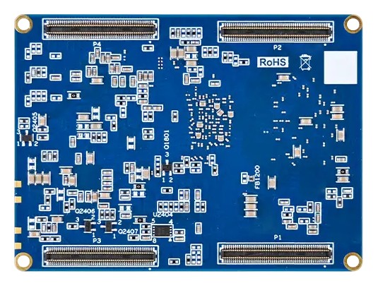

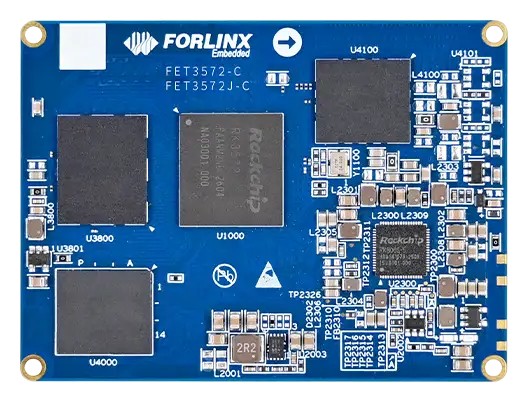

Forlinx FET3572-C SoM Specifications:
  • SoC: Rockchip RK3572 / RK3572J (8nm process)
  • CPU:
    • 2× Cortex-A73 cores @ up to 2.2GHz
    • 6× Cortex-A53 cores @ up to 2.1GHz
  • GPU:
    • Arm Mali-G310V2 MC1
    • OpenGL ES 1.1/2.0/3.2
    • OpenCL 3.0
    • Vulkan 1.4
  • AI Accelerator:
    • 4 TOPS NPU
    • Supports INT4, INT8, INT16, FP4, FP8, FP16, and BF16
  • Video Engine:
    • H.264/H.265 encoding up to 4K@60fps
    • H.264, H.265, VP9, AV1, and AVS2 decoding up to 8K@30fps or 4K@120fps
  • Memory: 2GB, 4GB, or 8GB LPDDR5
  • Storage: Up to 64GB eMMC flash
  • Display Interfaces:
    • HDMI 2.1 or eDP 1.3 up to 4K@60Hz
    • MIPI DSI 1.2
    • RGB parallel display up to 1920×1080@60Hz
    • E-Ink display support up to 1872×1404
  • Camera Interfaces:
    • 2× MIPI CSI-2
    • DVP interface
  • Networking: 2× Gigabit Ethernet interfaces
  • Expansion and I/O:
    • PCIe 2.1, SATA 3.1, and USB 3.0 combo interfaces
    • 2× USB 2.0 OTG
    • Up to 12× UART
    • Up to 4× CAN FD
    • Up to 9× I2C
    • 1× I3C
    • Up to 5× SPI
    • Up to 16× PWM
    • Up to 8× ADC
    • DSMC parallel bus
  • Dimensions: 68 × 50 mm
  • Temperature Range:
    • Commercial: 0°C to +80°C
    • Industrial: -40°C to +85°C
Forlinx FET3572-C (Bottom)
The Rockchip RK3572 SoM fills the gap between the RK3568 and RK3576 processors. It combines a heterogeneous CPU architecture with a 4 TOPS NPU and modern multimedia capabilities, making it suitable for machine vision, edge AI inference, industrial gateways, smart displays, and embedded control systems. The module also includes a DSMC parallel bus that enables direct communication with FPGA and DSP devices for applications that require low-latency data transfer.

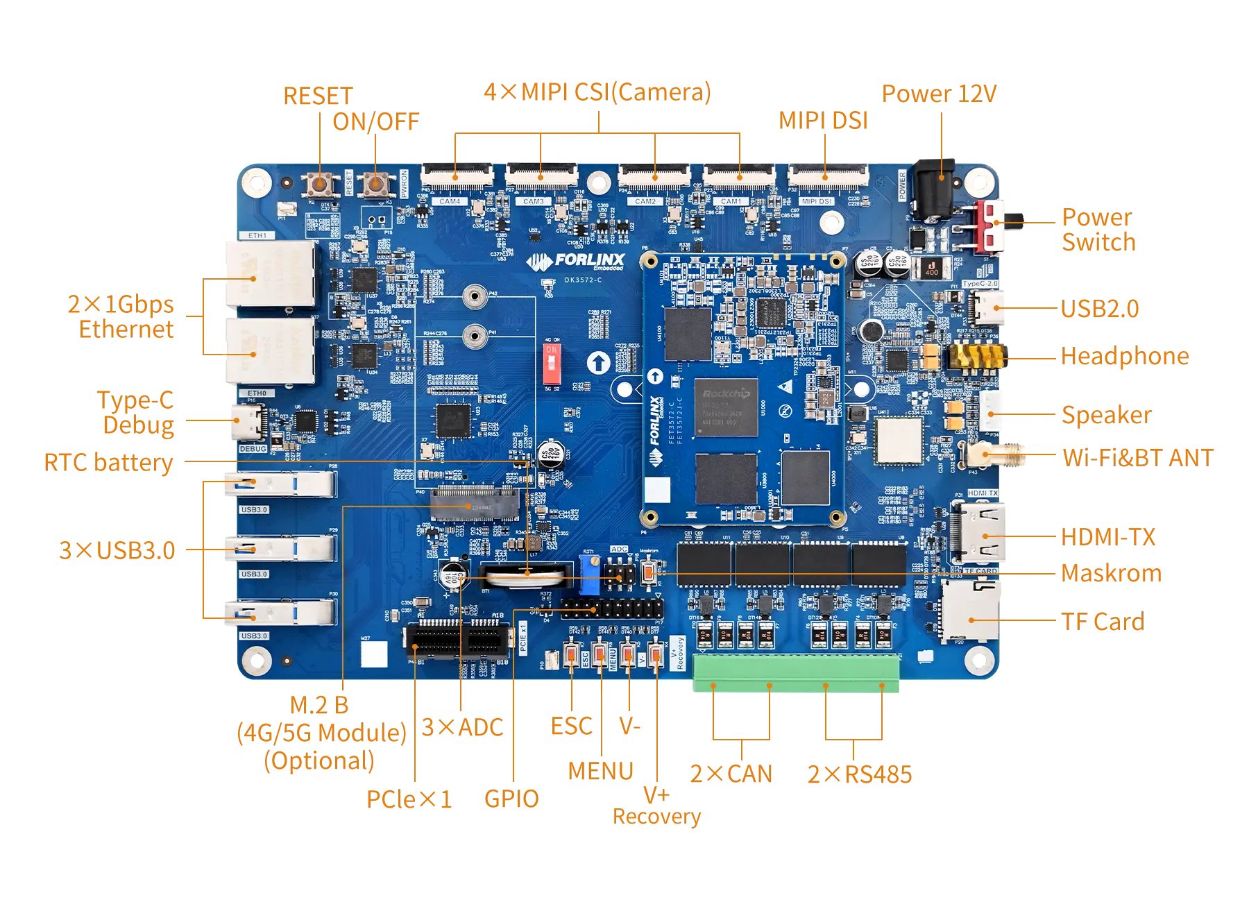

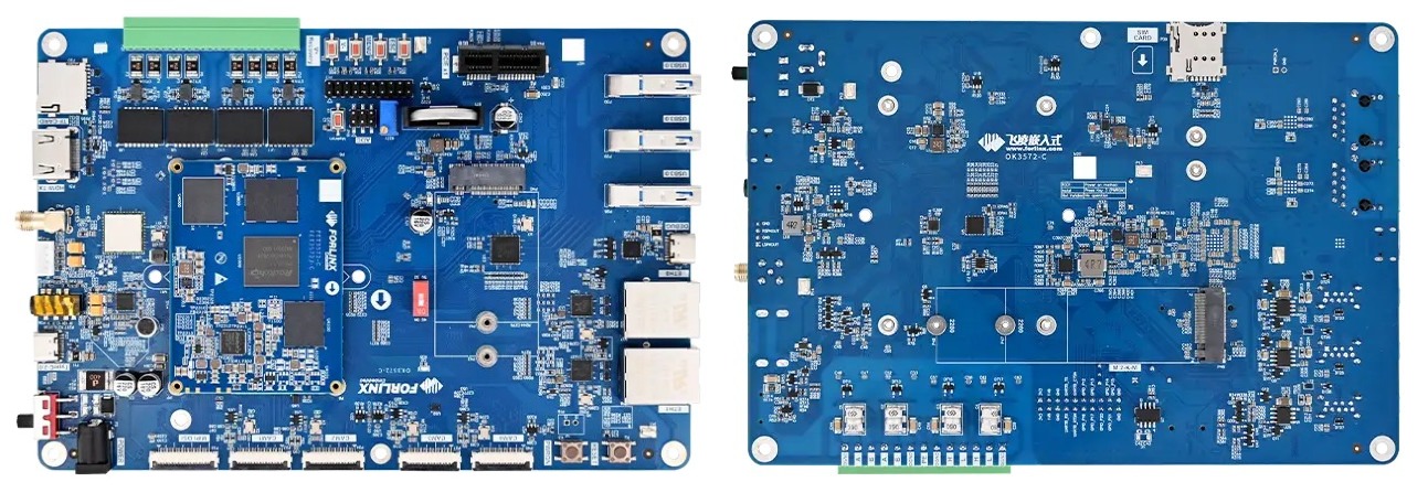

OK3572-C Single Board Computer
OK3572-C Carrier Board

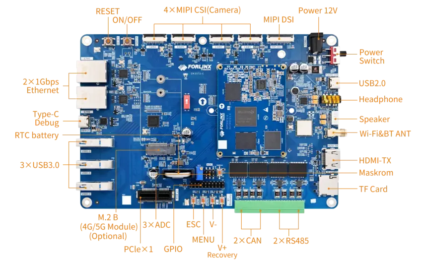

OK3572-C Carrier Board Specifications:
  • Module Support: FET3572-C SoM
  • Storage:
    • MicroSD card slot
    • M.2 Key-M socket for NVMe SSD
  • Display Output:
    • HDMI 2.1 up to 4096×2160@60Hz
    • MIPI DSI up to 2560×1600@60Hz
  • Camera:
    • 4× MIPI CSI connectors
    • Supports 2× 4-lane or 4× 2-lane camera configurations
  • Audio:
    • Onboard audio codec
    • Headphone and microphone jack
    • Speaker connector
  • Networking:
    • 2× Gigabit Ethernet ports
    • AzureWave AW-CM358SM Wi-Fi 5 and Bluetooth 5.0 module
    • M.2 Key-B slot for optional 4G/5G modules
    • Nano SIM slot
  • USB:
    • 3× USB 3.0 Type-A
    • 1× USB Type-C OTG
  • Industrial Interfaces:
    • 2× RS-485
    • 2× CAN FD
  • Expansion:
    • PCIe 2.1 x1 slot
    • M.2 Key-M interface
    • GPIO header with UART and GPIO pins
    • ADC header
  • Additional Features:
    • RTC battery socket
    • Power and reset buttons
    • Recovery and function buttons
  • Power Input: 12V DC
  • Dimensions: 190 × 130 mm
The OK3572-C development board provides a complete evaluation platform for developers working with the Rockchip RK3572 SoM. It supports multi-camera configurations, dual Gigabit Ethernet networking, PCIe expansion, NVMe storage, and optional cellular connectivity, making it suitable for prototyping AI vision systems, industrial controllers, and edge computing devices.
