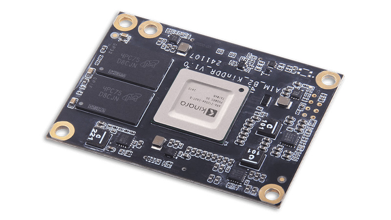

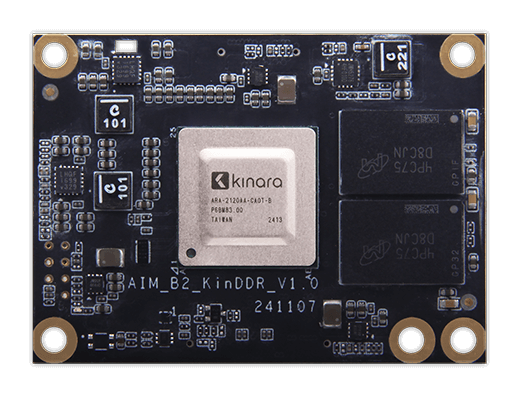

Geniatech has introduced the AIM-B2, a compact NXP AI Accelerator module powered by the NXP Ara240 processor with Kinara Ara-2 edge AI architecture. The module targets edge AI, generative AI, robotics, industrial automation, and smart city applications. It combines the NXP Ara240 AI processor with a PCIe Gen4 interface in a compact 40 × 55 mm form factor, designed for systems that require high AI throughput with low power consumption.
The AIM-B2 delivers up to 40 TOPS INT8 AI performance while consuming around 12W of power. Geniatech designed the module for workloads including object detection, semantic segmentation, pose estimation, facial recognition, and transformer-based AI models. The platform also supports multi-chip scalability, allowing developers to expand AI processing performance for larger edge deployments.
Geniatech AIM-B2 Top

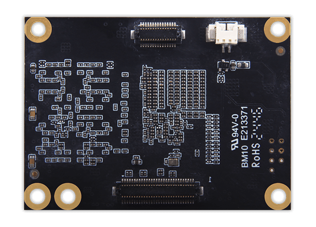

The module exposes PCIe Gen4 lanes, USB signals, UART, I2C, reference clocks, and control interfaces through dual B2B connectors. This layout allows system integrators to embed the accelerator into robotics controllers, AI gateways, industrial PCs, smart cameras, and autonomous drone systems. The design focuses on stable high-speed connectivity and long-term industrial deployment.
Geniatech AIM-B2 Bottom
