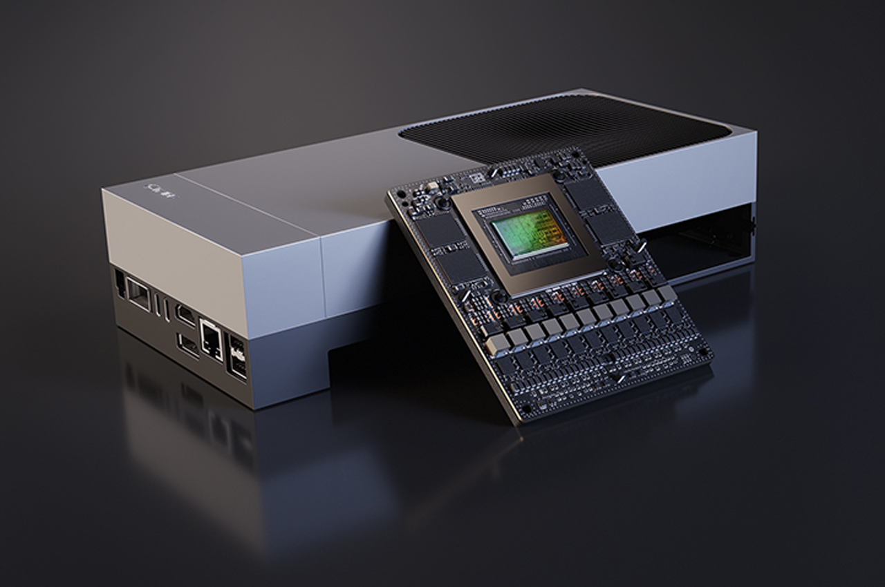

NVIDIA Jetson Thor Developer Kit with Jetson T5000

NVIDIA Jetson AGX Thor Developer Kit Specifications:
  • Module: Jetson T5000
  • AI Performance: Up to 2070 TFLOPS (FP4, Sparse)
  • GPU: 2560-core NVIDIA Blackwell architecture GPU with 96 Tensor Cores, Multi-Instance GPU (MIG) with 10 TPCs, up to 1.57 GHz
  • CPU: 14-core Arm Neoverse-V3AE 64-bit CPU @ up to 2.6 GHz
    • 1 MB L2 cache per core
    • 16 MB shared L3 cache
  • Memory: 128 GB 256-bit LPDDR5X, 273 GB/s bandwidth
  • Storage: 1TB NVMe (M.2 Key M), support for external SSDs (USB 3.2)
  • Display: HDMI 2.0b, DisplayPort 1.4a, 4x shared HDMI 2.1
  • Vision Accelerator: 1x PVA v3
  • Video Encode: up to 6x 4Kp60 (H.265/H.264), 24x 1080p60 (H.265)
  • Video Decode: up to 4x 8Kp30, 10x 4Kp60, 92x 1080p30 (H.265/H.264)
  • Camera Interfaces:
    • Up to 20 cameras via HSB
    • Up to 6 cameras via 16-lane MIPI CSI-2
    • Up to 32 cameras with Virtual Channels
    • C-PHY 2.1 (10.25 Gbps), D-PHY 2.1 (40 Gbps)
  • Networking:
    • 1x 5GbE RJ45
    • 1x QSFP28 (4x 25GbE)
    • 4x 25GbE
  • PCIe Expansion:
    • M.2 Key M (x4 PCIe Gen5)
    • M.2 Key E (x1 PCIe Gen5)
    • Additional Gen5 support up to x8 lanes
  • USB:
    • 2x USB-A (3.2 Gen2)
    • 2x USB-C (3.1)
    • 3x USB 3.2
    • 4x USB 2.0
  • Other I/O:
    • CAN, SPI, I2C, UART, PWM, GPIOs, Audio headers, JTAG
    • Connector: 699-pin B2B
  • Power Consumption: Configurable 40W to 130W
  • Cooling: Integrated Thermal Transfer Plate (TTP), optional fan or heatsink
  • Dimensions: 243.19 x 112.40 x 56.88 mm (board), 100 x 87 mm (module)
NVIDIA Jetson Thor hardware overview
