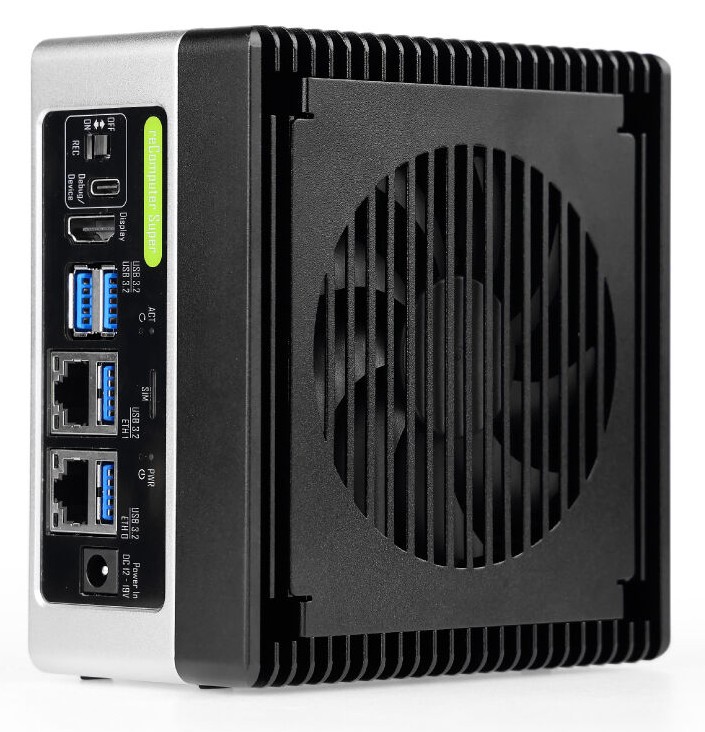

reComputer Super J3011 Edge AI PC Features NVIDIA Jetson Orin Nano with up to 67 TOPS AI Performance in Super Mode
Seeed Studio’s reComputer Super J3011 advanced Edge AI PC is built around the NVIDIA Jetson Orin Nano module, which offers up to 67 TOPS AI performance (67 TOPS in MAXN Super Mode), with up to 8GB LPDDR5 memory, and a pre-installed 128GB NVMe 2280 SSD for storage. The mini PC features four USB 3.2 Type-A ports and one USB 2.0 Type-C port, HDMI 2.1 video output, two RJ45 Gigabit Ethernet slots, M.2 slots for SSD and Wi-Fi, a mini PCIe socket for LTE 4G module, a 40-pin GPIO header, and a 12-pin control and UART header.
The mini PC features four USB 3.2 Type-A ports and one USB 2.0 Type-C port, HDMI 2.1 video output, two RJ45 Gigabit Ethernet slots, M.2 slots for SSD and Wi-Fi, a mini PCIe socket for LTE 4G module, a 40-pin GPIO header, and a 12-pin control and UART header. With a compact aluminium case and active cooling, it has an operating temperature range of -20 to 65°C and can be powered via a DC 12-19V 5525 Barrel input. These features make this device useful for demanding applications like Robotics, vision AI, generative AI, IoT, and Edge Computing applications, such as AMR, smart retail, industrial automation, and video surveillance, smart video analysis scenarios, and more.

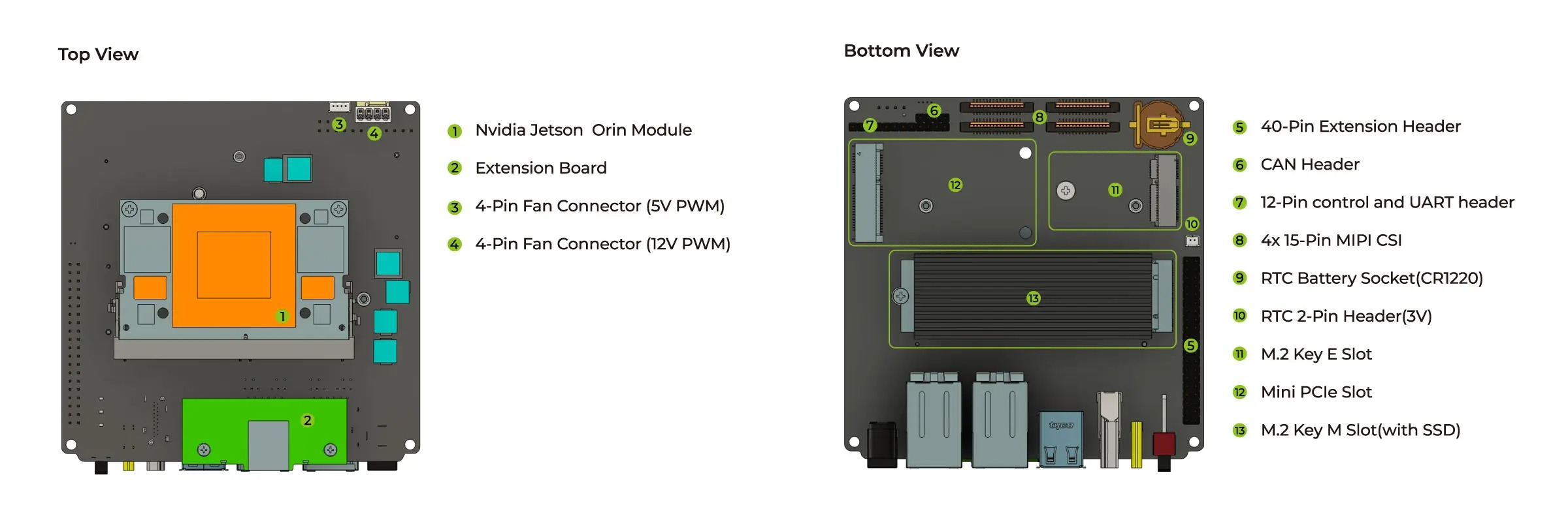

reComputer Super J3011 advanced Edge AI PC top and bottom specifications
