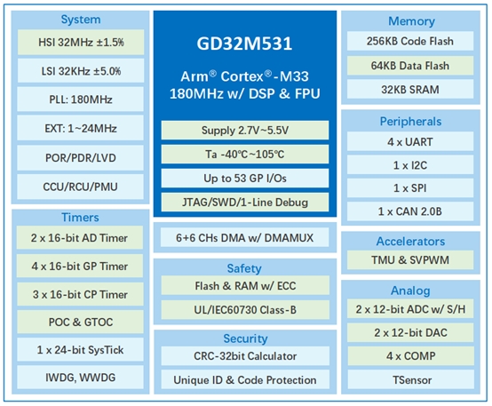

GD32M531: An MCU Built Around Motor Control
The GD32M531 series 32-bit MCU is built on an Arm Cortex-M33 core running at up to 180 MHz, with DSP extensions and a floating-point unit. It scores up to 705 CoreMark and 267 DMIPS, and ships with 256 KB of Flash, 64 KB of Data-Flash, and 32 KB of SRAM — all with ECC coverage. The device supports a supply voltage range of 2.7 V to 5.5 V and is rated from -40°C to 105°C, with a junction temperature limit of 125°C.
The peripheral set covers four UARTs, one I2C, one SPI, one CAN 2.0B interface, two ADC modules with independent sample-and-hold circuits, and a DAC. Three dedicated CP-Timers and four GP-Timers are included for control tasks. A one-line single-wire debug interface is supported for development and production testing. The device is available in LQFP64 and LQFP48 packages.
Block diagram of the GD32M531 MCU
Block diagram of the GD32M531 MCU. Image used courtesy of GigaDevice Semiconductor
Hardware Acceleration for Field-Oriented Control (FOC) Applications
The distinguishing feature of the GD32M531 is its built-in hardware support for field-oriented control. Dedicated accelerators handle trigonometric functions and SVPWM generation, reducing the CPU cycles required for FOC algorithms. Two enhanced AD-Timers support independent dual-motor FOC drive, and hardware phase-shifted ADC trigger linkage enables synchronous current and voltage sampling without software delays.
Overcurrent protection is handled by an integrated POC&GTOC block that responds at the microsecond level without requiring CPU intervention. The device’s STL is IEC 60730 Class B certified, making it suitable for home appliance safety requirements. ESD performance is rated at HBM ±4kV and CDM ±1kV, with latch-up resistance up to ±200mA at 125°C.
Target applications include outdoor air conditioner units, heat pumps, washing machines, dishwashers, multi-burner induction cookers, industrial inverters, and photovoltaic MPPT inverter systems. Samples and development boards are available now, with mass production scheduled for April 2026.
