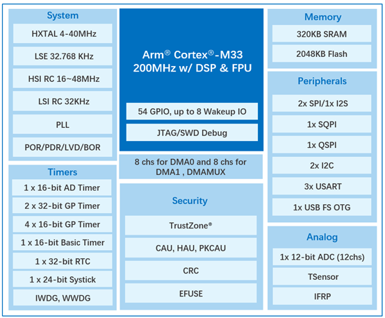

The GD32F5HC series MCUs incorporate a TrustZone-enabled architecture with dual-level access control via MPU and SAU. Hardware security resources include 2 k bits of eFuse for key storage alongside a full cryptographic accelerator suite covering TRNG, SHA, DES/3DES, AES, RSA/DH, and ECC. Secure boot, secure storage, secure debugging, and secure upgrade capabilities round out the protection model, covering firmware integrity across the device lifecycle, which is a meaningful consideration as regulatory requirements for embedded security continue to tighten.
Peripherals and Power
The peripheral set is practical for multi-interface designs. Communication options include 2x SPI/1x I2S, 1x SQPI, 1x QSPI, 2x I2C, 3x USART, and 1x USB FS OTG. The QSPI and SQPI interfaces support external PSRAM and Flash at up to 45 MHz.
A 12-bit ADC, an integrated temperature sensor, and an infrared interface handle analog signal acquisition, while a timer subsystem comprising one 16-bit advanced timer, two 32-bit general timers, four 16-bit general timers, and one 16-bit basic timer handles waveform generation and multi-axis motor control. An eight-channel DMA controller with DMAMUX helps keep CPU overhead low during data-intensive operations.
The GD32F5HC series integrates a rich set of high-speed peripherals and communications interfaces to optimize data throughput
The GD32F5HC series integrates a rich set of high-speed peripherals and communications interfaces to optimize data throughput. Image used courtesy of GigaDevice
