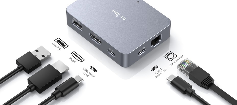

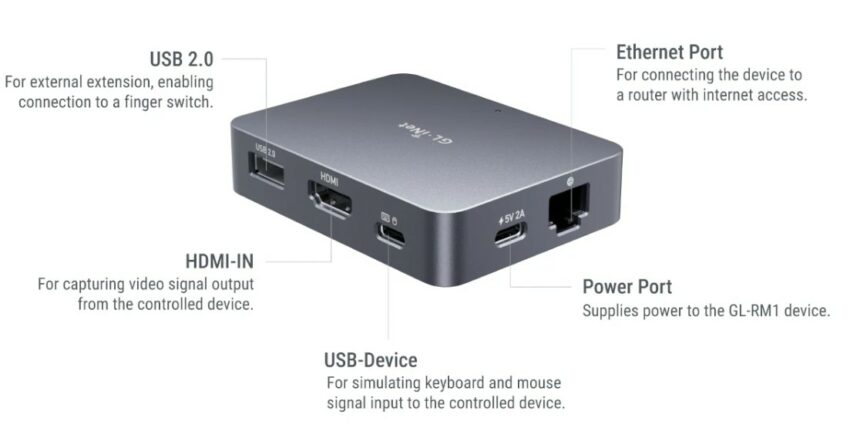

Comet GL-RM1 specifications:
  • Processor: Quad-core CPU @ 1.5GHz
  • Memory and Storage:
    • 1GB DDR3 RAM
    • 8GB eMMC flash storage
  • Video and Audio:
    • HDMI-IN with support for up to 2K (2160×1440) @ 60 FPS
    • H.264 hardware encoding with 30-60ms ultra-low latency
    • Remote audio output
  • Networking:
    • Gigabit Ethernet RJ45 port (10/100/1000Mbps)
    • DHCP support
  • USB Interfaces:

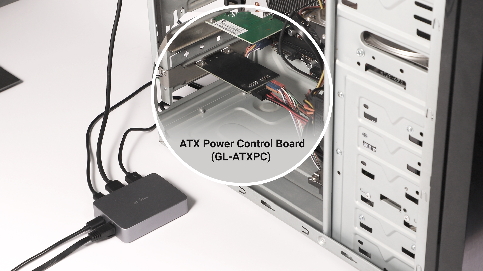

    • 1x USB 2.0 Type-A for peripherals (e.g., Fingerbot, ATX power control)
    • 1x USB 2.0 Type-C for mouse/keyboard emulation
  • Misc:
    • Reset button
    • Dual-color LED indicator for power and device status
  • Power:
    • Power input: USB Type-C, 5V/2A
    • Power consumption: 3W
  • Dimensions: 80 x 60 x 17.5mm
  • Weight: 85 gm
  • Operating temperature: 0 ~ 40°C (32 ~ 104°F)
  • Certifications: CE, FCC, RoHS, WEEE

The GL.iNet Comet (GL-RM1) remote KVM comes with an Ethernet cable, a USB cable, a warranty card, and a user manual. It is now available for pre-order at $69 with free shipping. After the pre-order period, the price will increase to $89. A bundle including the Comet (GL-RM1) and the ATX Power Control Board is also available for $80.9, discounted from the regular price of $104.9.
