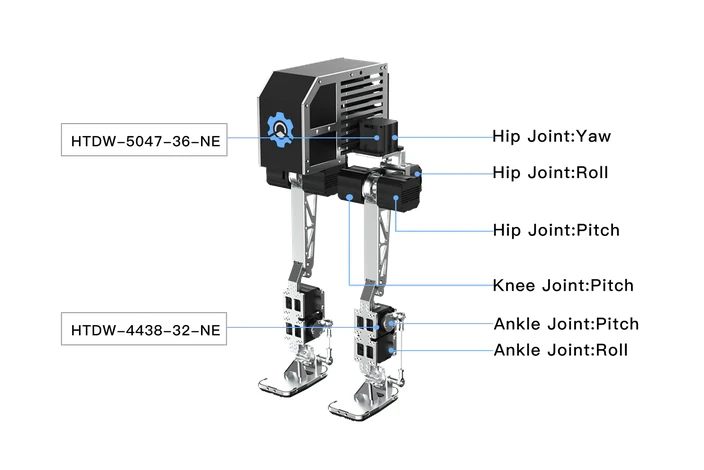

High Torque Robotics Mini π is a 54cm tall bipedal robot built around the Orange Pi 5 SBC with Rockchip RK3588S for better performance and control. The robot has 12 degrees of freedom(DOF) with 12 custom joint motors, allowing it to walk, dance, run, jump, and flip.
High Torque Robotics Mini π is a 54cm tall bipedal robot built around the Orange Pi 5 SBC with Rockchip RK3588S for better performance and control. The robot has 12 degrees of freedom(DOF) with 12 custom joint motors, allowing it to walk, dance, run, jump, and flip. Designed for research and education, it supports advanced algorithms like ZMP(zero moment point), MPC(Model Predictive Control), reinforcement learning, and ROS SLAM for navigation.

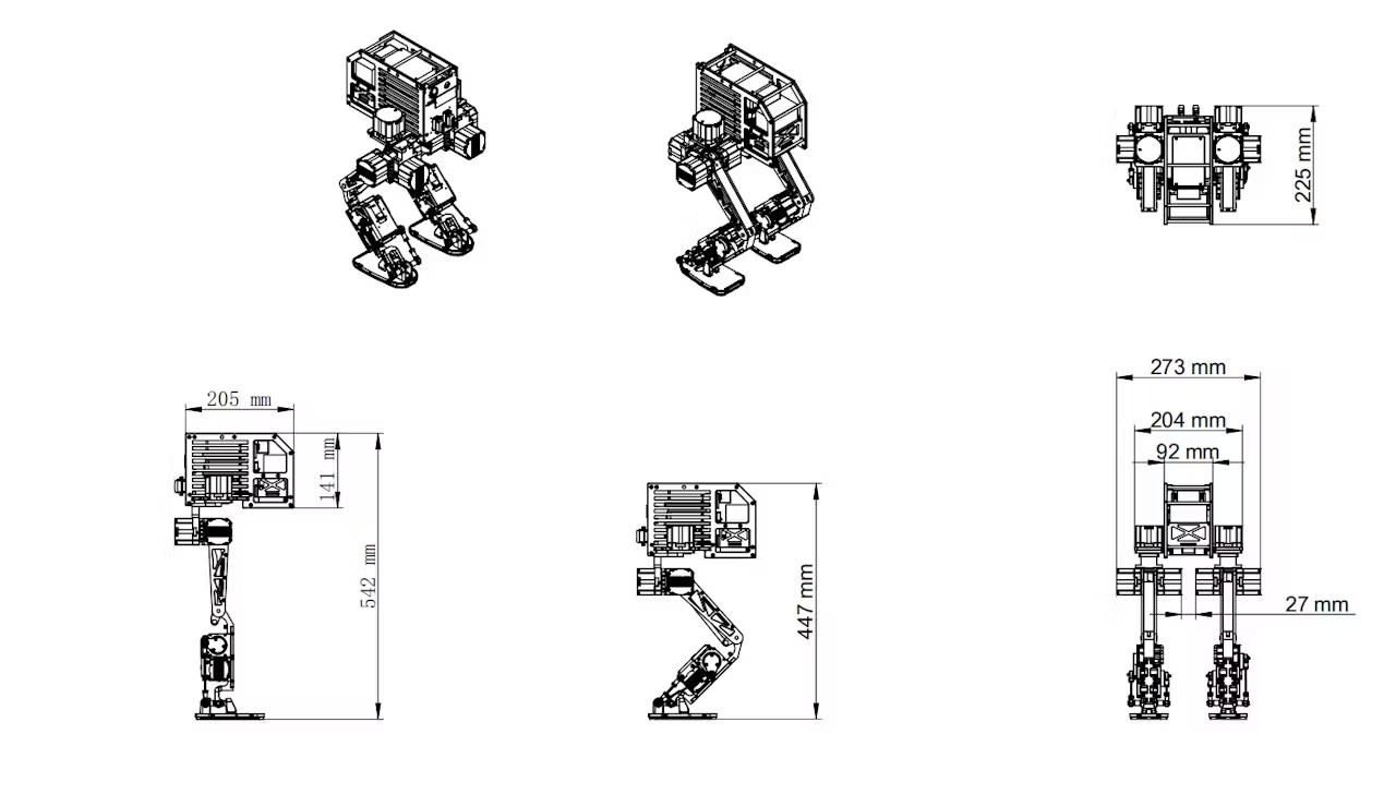

  • Standing height: 542 mm
  • Weight: 7 kg with battery
High Torque Robotics said the Mini π comes with a robot test stand and trolley case. For more details, visit the Hackster.io project page. There, you can find the schematic, locomotion control algorithm code, and more information about the joint motors. High Torque Robotics says the robot is open-source, and the algorithm is simulated and verified on the 12 DOF Mini π. The open-source code is available on GitHub.
