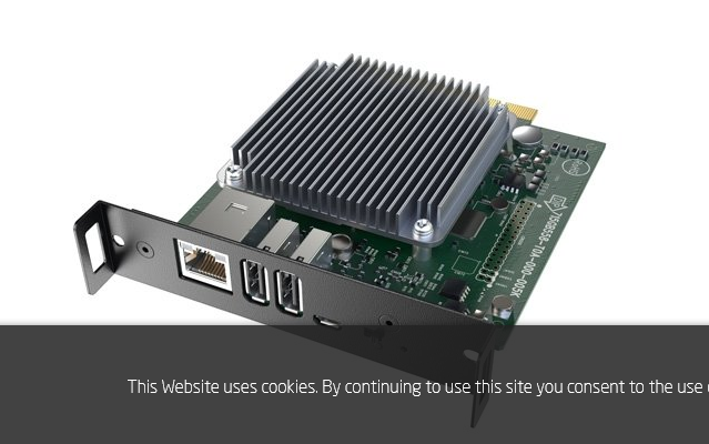

iBase launches the 2.5-inch Pico-ITX (IBR115) and 3.5-inch (IBR117) SBCs that both run Linux  (ships with BSPs for Yocto Project 2.0) or Android and provides GPIO support just like other SBCs. At the core of the boards is the NXP i.MX 6 SoC. The i.MX 6 series of applications processors offer performance and scalable multicore platform including the single, dual, and quad-core families based on the Arm® Cortex® architecture. The IBR115 is powered by the NXP Cortex™-A9, i.MX 6 Dual-Lite 1GHz processor and the IBR117 is powered by the slightly higher NXP Cortex™-A9, i.MX 6 Dual 1GHz processor. The difference is very minimal though.
The IBR115 will be the first of its SBC to adopt the smaller Pico-ITX form factor measuring at about 100 x 72 mm also known as the 2.5-inch and the IBR117 measures about 147mm x 102mm called the 3.5-inch form factor.
IBR115 SBC
The two products offer similarly identical features. They both provide display interface support like HDMI and LVDS, 1GB of DDR3 RAM, 4GB eMMC, a mini-USB OTG port, a USB 2.0 host port,  USB headers, a GbE port, plus an optional WiFi/Bluetooth module that plugs into an M.2 E-Key (2230) slot, and SD slot. The IBR117 supplies a full-sized SD slot instead of the microSD slot on the IBR115, a dual LVDS interface as compared to the single LVDS interface on the IBR115.
IBR117
