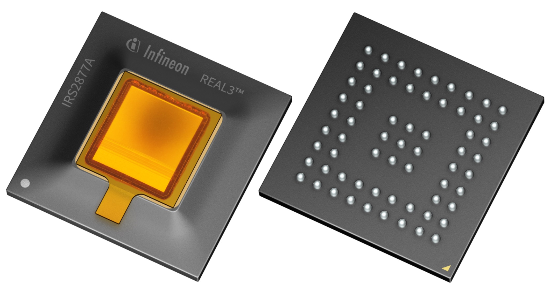

The sensor comes in a 9 x 9 mm² plastic BGA package and offers a VGA system resolution of 640 x 480 pixels with a tiny image circle of 4 mm. This allows lens sizes similar to those known from smartphones, but now also for automotive applications. The high resolution of the REAL3 sensor also makes it suitable for camera applications with a wide field of view, such as complete front-row occupant monitoring systems. The resulting 3D body models enable accurate estimates of occupant size and weight, as well as highly precise passenger and seat position data, which is key information for intelligent airbag deployment and restraint systems. In addition to its small size, the single-chip solution is qualified to AEC-Q100 Grade 2 and is the first of its kind being developed according to the ISO26262 (ASIL-B) standard.

Development samples of the new 3D image sensor chip (IRS2877A) are available now and series production has begun. The ISO26262 compliant variant IRS2877AS will be available for series production by the end of 2022.
