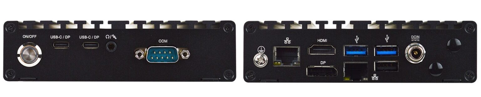

The B420UADN1 – INTEL N97 Fanless Box PC Front and Back Side

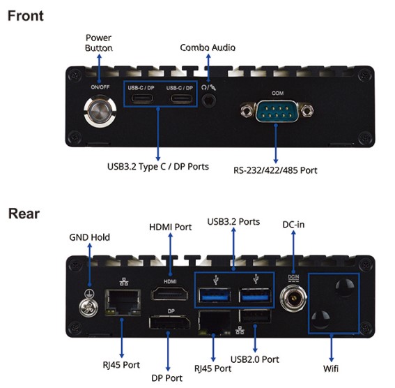

Jetway B420UADN1 Peripheral Breakout
