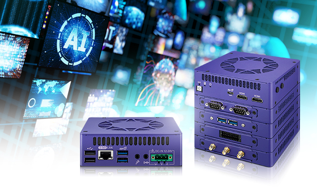

TGS-1000 and TGS-1500
The system can be mounted on a wall using a bracket, with VESA or DIN Rail mounts also available. Vecow supports Windows 11/10 and Linux on the fanless TGS-1000 Series. Optional software includes VHub AI Developer, VHub ROS, and VHub EtherCAT, with OpenVINO toolkits supporting over 500 AI models optimized for AI computing.
Vecow stackable embedded computer is available in four variants: TGS-1000-165H/135H and TGS-1500-165H/135H. The company hasn’t provided availability or pricing details.
