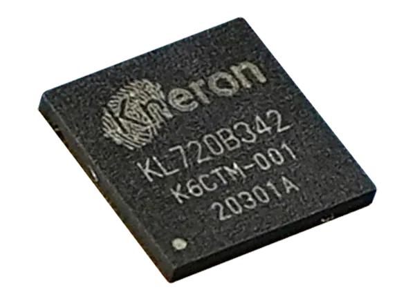

Kneron KL720 AI SoCs
Kneron KL720 AI SoC (System on a Chip) offers an ideal balance of performance, power saving, and cost for hardware makers who are looking to benefit from on-device edge Artificial Intelligence (AI). Powered by Kneron’s Neural Processing Unit (NPU) that accelerates neural network models, the KL720 SoC makes possible endless AI applications for smart devices.
The NPU core is of the KL720 is designed to accelerate major computing layers inside the Convolutional Neural Network (CNN) and Recurrent Neural Network (RNN) to off-load heavy computing from the traditional CPU or GPU structure.

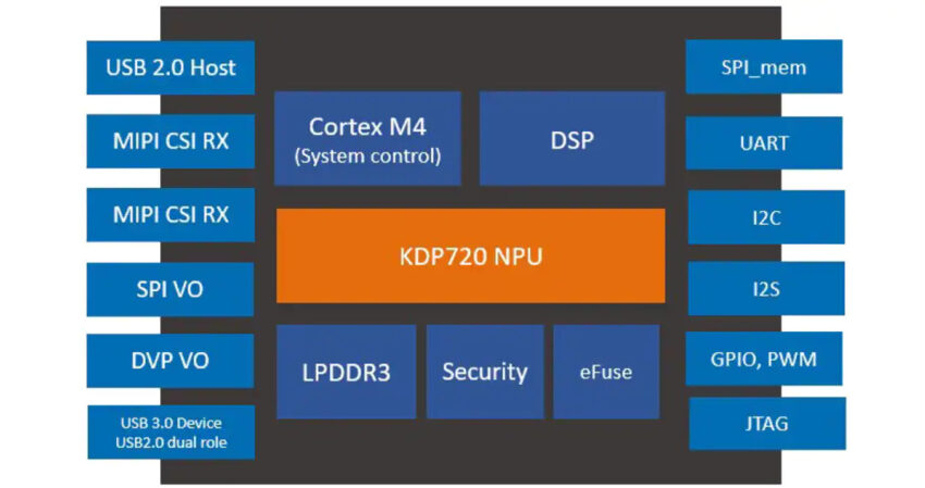

Block Diagram
