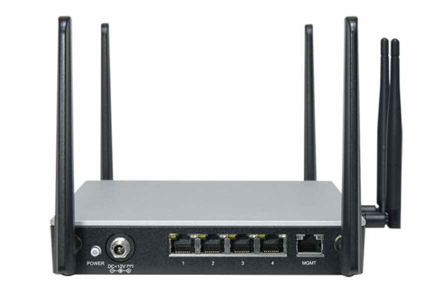

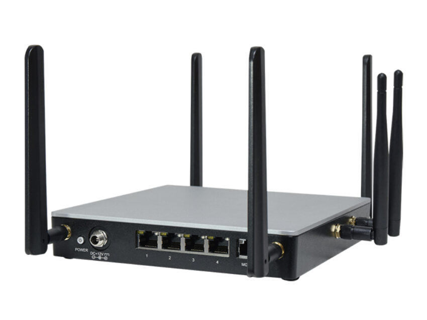

The Lanner NCA-1050 is a fanless gateway appliance designed for small and medium-sized businesses (SMBs), offering advanced network security and edge computing capabilities. It is powered by Intel Atom X7835RE, X7405C, and X7203C processors, which integrate Intel AES-NI for enhanced data encryption and secure networking. This platform is suited for applications such as routing, VoIP, VPN, firewall, IPS/IDS, and email servers, addressing the increasing demand for secure edge computing in mobile device-driven environments.
The appliance supports up to 8 cores, 16GB DDR5 4800MHz memory, and offers a variety of connectivity options, including 1x 2.5GbE RJ45, 4x 1GbE RJ45, and wireless signal support via 6x SMA antenna holes. Additional features include 1x USB 3.1, 2x M.2 slots, 2x Nano SIM slots, and an optional PoE+ port. With support for high-speed networking, storage, and wireless applications, the NCA-1050 delivers reliable performance for edge security and network management tasks.

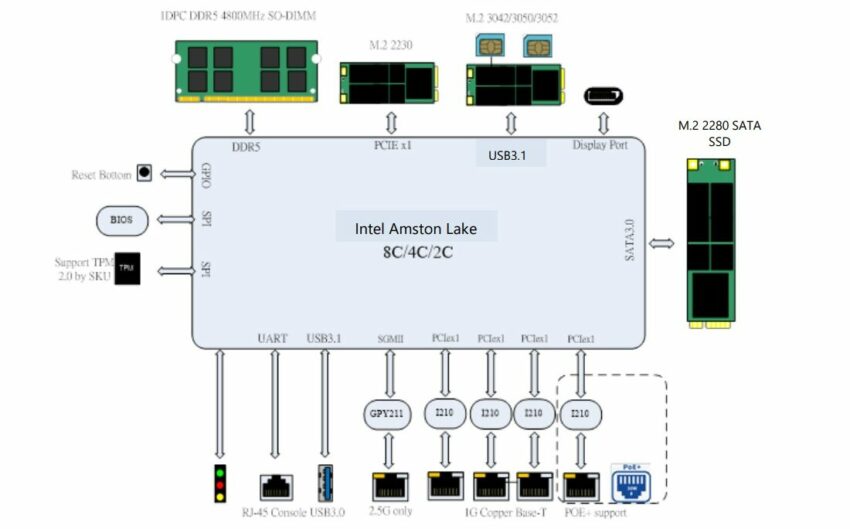

    • NCA-1050A: Intel Atom x7835RE 1.3GHz octa-core processor with 6MB cache, 32EU Intel UHD graphics; TDP: 12W
    • NCA-1050B: Intel Atom X7405C 2.2GHz quad-core processor with 6MB cache; TDP: 12W
    • NCA-1050C: Intel Atom X7203C 2 GHz dual-core processor with 6MB cache; TDP: 12W
  • System Memory: Up to 16GB DDR5 4800MHz Non-ECC SODIMM with 262-pin SODIMM socket
  • Storage: M.2 2280 B-Key socket for SATA III module
  • Display: SKU-A DisplayPort 1.2 connector (for NCA-1050A only)
  • Networking:
    • 5GbE RJ45 port via Maxlinear GPY211 controller
    • 4x GbE RJ45 Ports via Intel I210-AT controller
    • Optional LTE module (Sierra EM7590, Quectel EM060K-GL, Telit LN920A6-WW), 5G module (Telit FN980, Telit FN990A28, Telit FN990A40, Quectel RM520N-GL)
    • Option Wi-Fi and Bluetooth (Intel AX210.NGWG.NV) module
    • 6x SMA antenna holes for Wi-Fi/4G LTE/5G
  • USB: 1x USB 3.0 port
  • Expansion:
    • M.2 2230 E-Key (PCIe x1) socket for Wi-Fi
    • M.2 3042/3050/3052 B-Key (USB 3.1) socket and 2x Nano SIM card slot for LTE/5G connectivity
