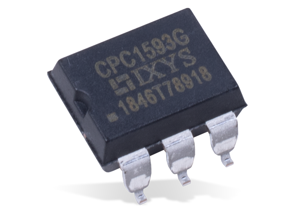

Littelfuse, Inc. a global manufacturer of leading technologies in circuit protection, power control, and sensing, announced the PLA172P OptoMOS® Relay, an 800 V normally-open single-pole 6-pin solid-state relay (SSR).
Littelfuse, Inc. a global manufacturer of leading technologies in circuit protection, power control, and sensing, announced the PLA172P OptoMOS® Relay, an 800 V normally-open single-pole 6-pin solid-state relay (SSR). It is the first solid-state relay in the Littelfuse product portfolio that comes with guaranteed electrical parameters at 105 °C ambient operating temperature.
“The PLA172P is an extension to our OptoMOS solid-state relay product line, offering our highest voltage rating (800V) in a surface mount SSR Flatpack package,” said Steve Andrezyk, Global Product Manager at Littelfuse. “It also has our highest temperature range in a solid-state relay, extending our operational temperature range from 85 ºC up to 105 ºC, enabling hardware engineers to precisely design their circuits at very challenging temperatures.”
