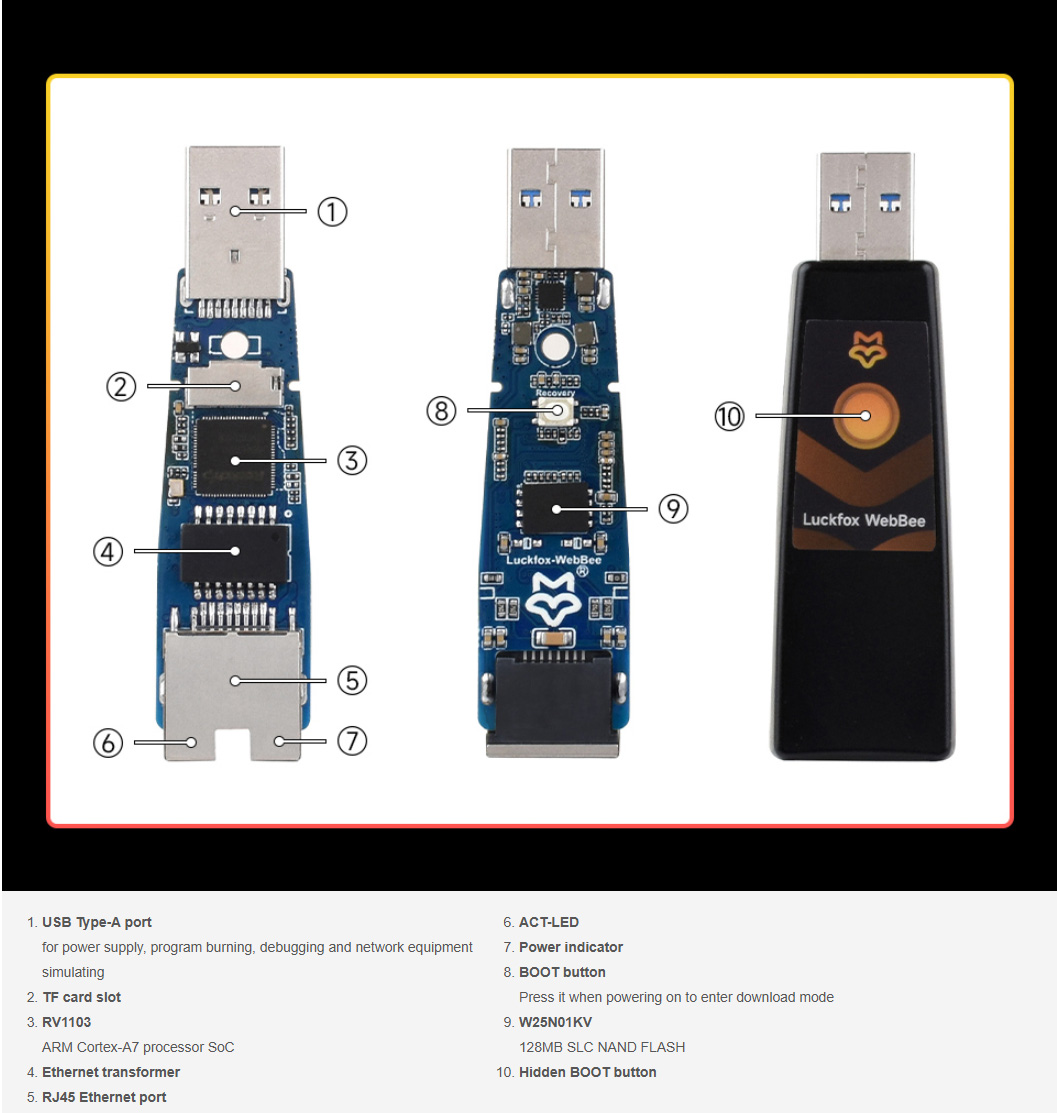

Luckfox recently released the Pico WebBee RV1103, a compact Linux micro development board powered by the Rockchip RV1103 processor. It is built around a single-core ARM Cortex-A7 processor running at 1.2GHz alongside a RISC-V microcontroller with NEON and FPU support.
It has 64MB DDR2 RAM and 128MB SLC NAND flash storage and supports booting via a MicroSD card. Designed for lightweight web servers, USB scripting tools, and smart home devices, it includes a 10/100Mbps Ethernet RJ45 port with an embedded PHY and MAC controller for network connectivity, a USB Type-A port for power, programming, and debugging, an ACT-LED power indicator, and a hidden BOOT button for download mode.

  • SoC – Rockchip RV1103
    • CPU – Single-core ARM Cortex-A7 @ 1.2GHz with NEON and FPU
    • MCU – RISC-V microcontroller
  • Memory & Storage
    • 64MB DDR2 RAM
    • 128MB SLC NAND flash
    • MicroSD card slot (for storage expansion or booting)
  • Networking
    • 10/100Mbps Ethernet RJ45 port with embedded PHY & MAC
  • USB
    • 1x USB Type-A port (for power, programming, and debugging)
  • Misc
    • ACT-LED power indicator
    • Hidden BOOT button (for download mode)
  • Power Supply – 5V via USB Type-A port
  • Enclosure – ABS protective shell
  • Dimension – 61.5mm x 22.9mm x 15.10mm
This compact device runs a Linux-based operating system and supports booting from SPI NAND flash or a MicroSD card. Using tools and software on the Luckfox Wiki page, you can burn images to them.
Users can burn images to these storage options using tools provided in the Luckfox Wiki, which supports Windows, Linux, and macOS. The board allows network configuration via Ethernet and enables remote access through ADB (Android Debug Bridge) and SSH, making it useful for headless operation. Additional software features include auto-start configuration, file management, and the ability to execute Linux shell commands for scripting and automation. These capabilities make it a compact and versatile platform for embedded Linux development, IoT applications, and lightweight networking tasks.
