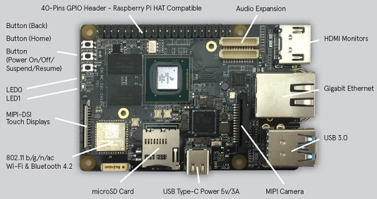

We have written about a host of i.MX8M based SBCs, like Seco’s SBC-C20, Boundary Devices’ Nitrogen8M, Arrow’s 96Boards CE Extended Thor96, SolidRun’s HummingBoard Pulse, and the armStone MX8M from F&S. However, we have come across another i.MX8M based SBC. Embest has launched a $60 “MaaxBoard” SBC which runs Yocto Linux or Android 9.0 on a quad -A53 i.MX8M, and features 2GB to 4GB DDR4, 4K playback, and a Raspberry Pi-like layout and 40-pin header.
Embest is a Chinese manufacturer that switched to Avnet when it acquired Premier Farnell. They have begun selling the Raspberry Pi-like SBC. Typical applications for the SBC include Human-Machine Interfaces (HMI), entertainment, AI device, building automation, education, machine vision, medical imaging, and embedded computing.
We realize that often times, most individually priced SBCs under $100 ship with open hardware specs and community support features, but it appears to be a different case with the MaaxBoard. However, Embest offers hardware and software documentation, and also an image and source code for a Yocto Project based distribution based on Linux 4.14.78. It also offers support for Android 9.0. It’s uncertain if the lone $60 package offers you the i.MX8M Dual, QuadLite, or Quad model. The 1.5GHz Cortex-A53 i.MX8M also includes a Cortex-M4F real-time core and a 4K-ready Vivante GC7000Lite/GC7000VLX GPU. Embest clocks the SoC at 1.4GHz.
The $60 price seems to include 2GB RAM and an empty eMMC socket. The product page mentions “up to” 2GB DDR4 SDRAM and “0 ~ 64GB” eMMC, but Embest’s SlideShare preview presentation from June lists a default of 2GB RAM but no specific eMMC listing. The MaaxBoard is also equipped with a MicroSD slot, an 802.11ac/Bluetooth 4.x module, and a GbE port. Available also is 2x USB 3.0 ports, a power-only USB Type-C port, MIPI-DSI and CSI connectors, and some high-end SPDIF and SAI digital audio interfaces.

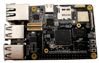

Maaxboard mini
By the end of the year, MaaxBoard will be joined by a very similar MaaXBoard Mini SBC equipped with NXP’s i.MX8M Mini SoC, that should be even more efficient thanks to the 14nm processor, but the price has not been announced yet. Embest has already posted a teaser page with some photos but no details. The image indicates that the HDMI port has been removed and replaced with one of the dual USB 3.0 ports. The i.MX8M Mini offers up to four faster, 1.8GHz Cortex-A53 cores with lower power consumption but is limited to HD video.

Specifications listed for the MaaxBoard include:
  • Processor — NXP i.MX8M Dual, QuadLite, or Quad (2x or 4x Cortex-A53 @ up to 1.4GHz); Vivante GC7000Lite GPU; VPU on all but QuadLite; Cortex-M4F @ 266MHz
  • Memory/storage – 2GB to 4GB DDR4
  • eMMC socket for up to 64GB
  • MicroSD slot
  • Networking/wireless:- 10/100/1000 Ethernet port, 802.11ac with Bluetooth 4.x with ant. connector.
  • Media I/O: HDMI 2.0a port with audio for up to 4k@60, MIPI-DSI, MIPI-CSI, SPDIF/UART and SAI audio connectors plus SAI/I2S on 40-pin, Supports more than 20 audio channels each @384KHz with DSD512.
  • Other I/O: 2x USB 3.0 host ports, USB Type-C port with 5V power input only, 7x and 8x GPIO connector.
  • Expansion — 40-pin GPIO connector (“partially” RPi HAT compatible) with I2C, SPI, UART, I2S, etc.
  • Other features — Power and user buttons; 2x LEDs
  • Power — 5V/3A via USB Type-C
  • Operating temperature — 0 to 70°C with 20% ~ 90% humidity resistance
  • Dimensions — 85 x 56 x 12mm
  • Operating system — Yocto image with Linux 4.14.78 and source code; Android 9.0 support
