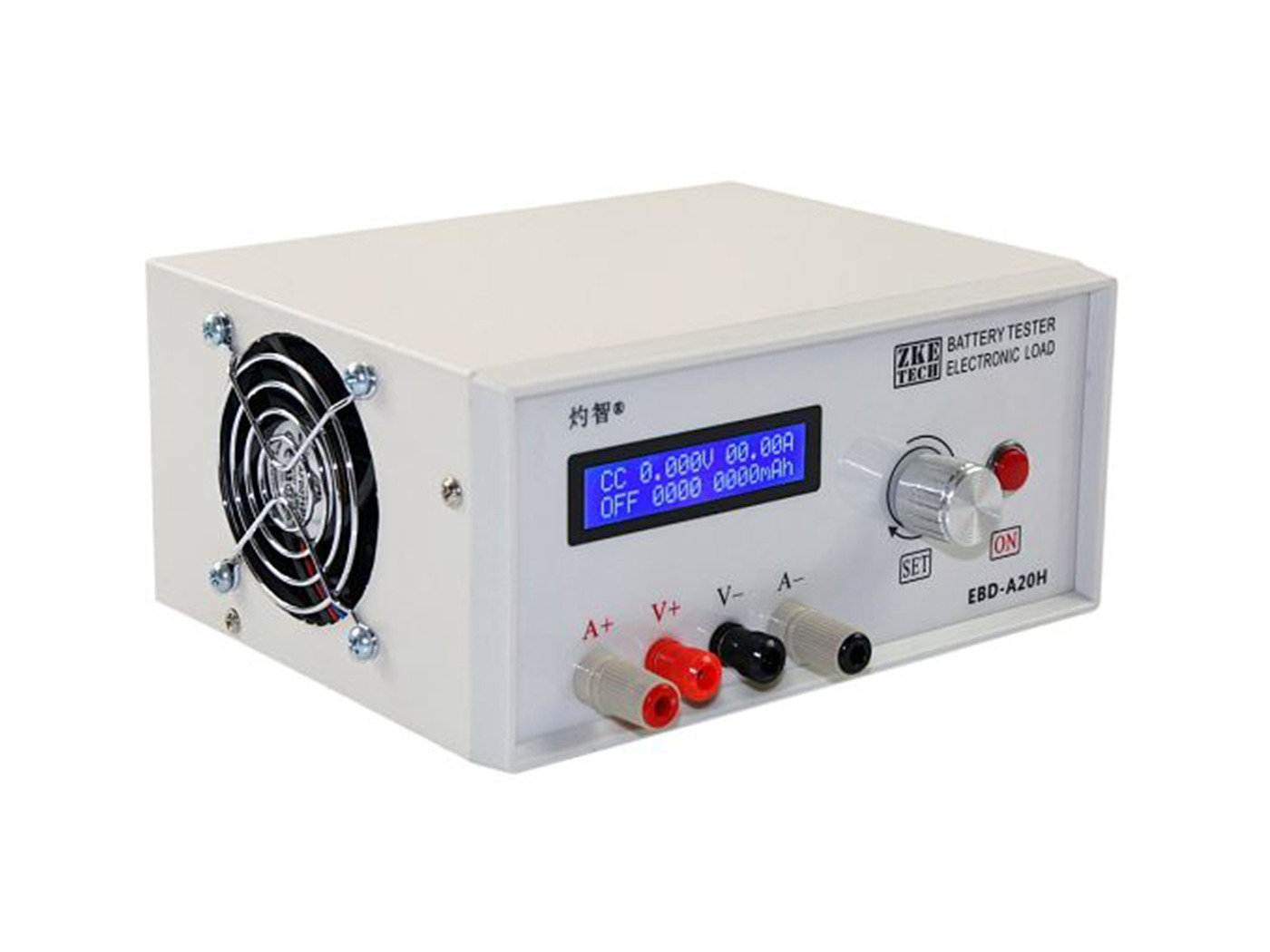

Spotting the kind of professional look that will fit right on the workbench in any lab (Professional or DIY home lab), the ZKETECH EBD-A20H is essentially a DC electronic load with multiple, controlled, battery discharge modes, that can be used to conduct various battery capacity and other power-related tests.
Some specifications of the EBD-A20H include:
  • Power Supply: DC 12V/1A
  • Voltage Setting: 0.00-30.00V, minimum step is 0.01V
  • Current Setting: 0.1-20.00A, minimum step is 0.01A (Current automatically limits when power is overrun)
  • Test mode: DSC-CC: constant discharge current for testing battery capacity or supply current/ DSC-CP: Constant discharge power for simulating constant power equipment or testing power supply
  • Voltage Test: 0.000-4.500V (low pressure) accuracy to 0.003V, error ±0.5% / 4.50V-30.00V (high pressure) accuracy to 0.01V, error ± 0.5%
  • Current Test: 0.10-20.00A, accuracy to 0.01A, error ± 0.5%
  • Capacity Test: Within 10Ah, resolution is 0.001Ah/ 10Ah-100Ah resolution is 0.01Ah/ Above 100Ah resolution is 0.1Ah
  • Discharge Power: Max 200W (It should be controlled within 90% for a long time working)

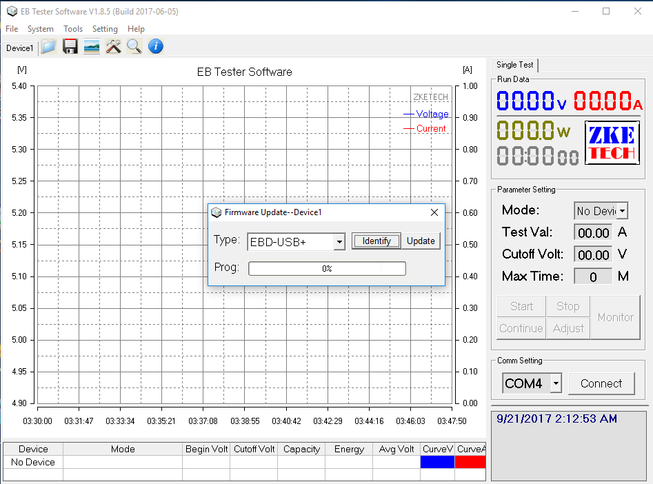

To make the visualization and analysis of test data easier, asides the LED display where the test data including voltage, current, capacity, time, power, energy, are displayed, the device also works with the “EB software” which precisely displays and can be used to plot curves, perform calibration benchmark tests, automatic current testing and also push firmware upgrades to the Battery tester device.
EB Tester Software UI
