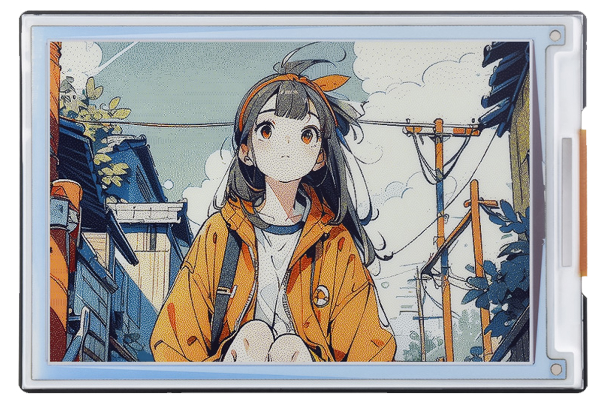

Waveshare has recently launched the 4-inch E-Ink Spectra 6 (E6) Full-Color E-Paper Display, designed to work with Raspberry Pi 5. It is a flexible and low-power display with a resolution of 600×400 pixels.
Waveshare has recently launched the 4-inch E-Ink Spectra 6 (E6) Full-Color E-Paper Display, designed to work with Raspberry Pi 5. It is a flexible and low-power display with a resolution of 600×400 pixels. It uses SPI communication so it is compatible with several platforms such as Jetson Nano, RDK X3, Arduino, and STM32. In addition, the display has high contrast and saturation, with E-Ink Spectra 6 technology offering full-colour images by using red, yellow, and blue as primary colours. It can maintain its last image without power and requires minimal energy for refreshing. Besides, this display is perfect for things like price tags, shelf labels, etc and other tools used in factories.

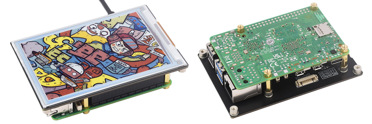

It supports the Raspberry Pi HAT+ standard so that you can enhance collusion and simplify development. This display has a wide viewing angle(over 170°), so you can see it clearly from almost any angle. And then its matte finish display makes it easy to see even in daylight. The optional driver board further expands its capabilities with a 40PIN GPIO header for easier integration with various controller boards.

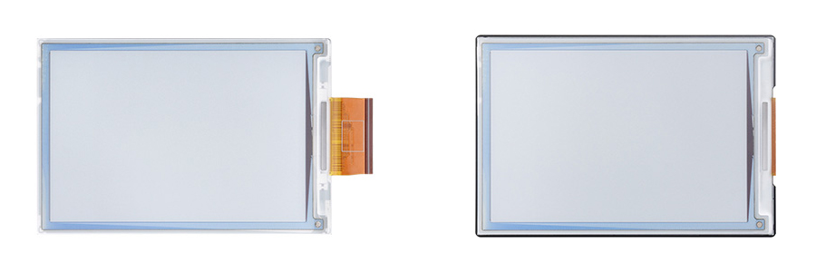

4inch e-Paper (E) raw display, without driver board (left), 4inch e-Paper HAT+ (E) with driver board (right)

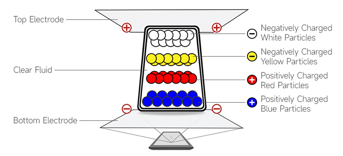

As far As I understand, the E-Ink Spectra 6 is a full-colour E-Paper technology that improves colour, resolution, and contrast using red, yellow, and blue as primary colours. In addition, it features Micro-cups with suspended particles for sharper, more vibrant images. Due to its up to 200 ppi resolution, faster refresh rates, and low power consumption, it follows that it’s energy-efficient. What’s more, this display creates six colours using blue particles and dithering for rich visuals. Besides, the E-paper uses microcapsule electrophoresis to reflect light like printed paper, working well in natural or artificial light with a wide viewing angle, often seen in e-readers for a paper-like experience. For further information like, picture processing, working with Raspberry Pi, and resources you can visit the product’s Wiki page.
