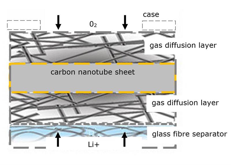

In Japan, and especially at the NIMS (National Institute for Materials Science), another research is working to create a Lithium-air battery that has the highest theoretical energy density because it uses oxygen in air. Its capacity reaches 15 times of the conventional Lithium batteries.
The electrode material has an enormous surface area thanks to ​​carbon nanotubes. Researchers achieved 30 mAh/cm² capacity in the lab, which will be amazing if realized in a commercial product. Work is ongoing to produce real practical samples with high energy density and a system to filter impurities from the air.
