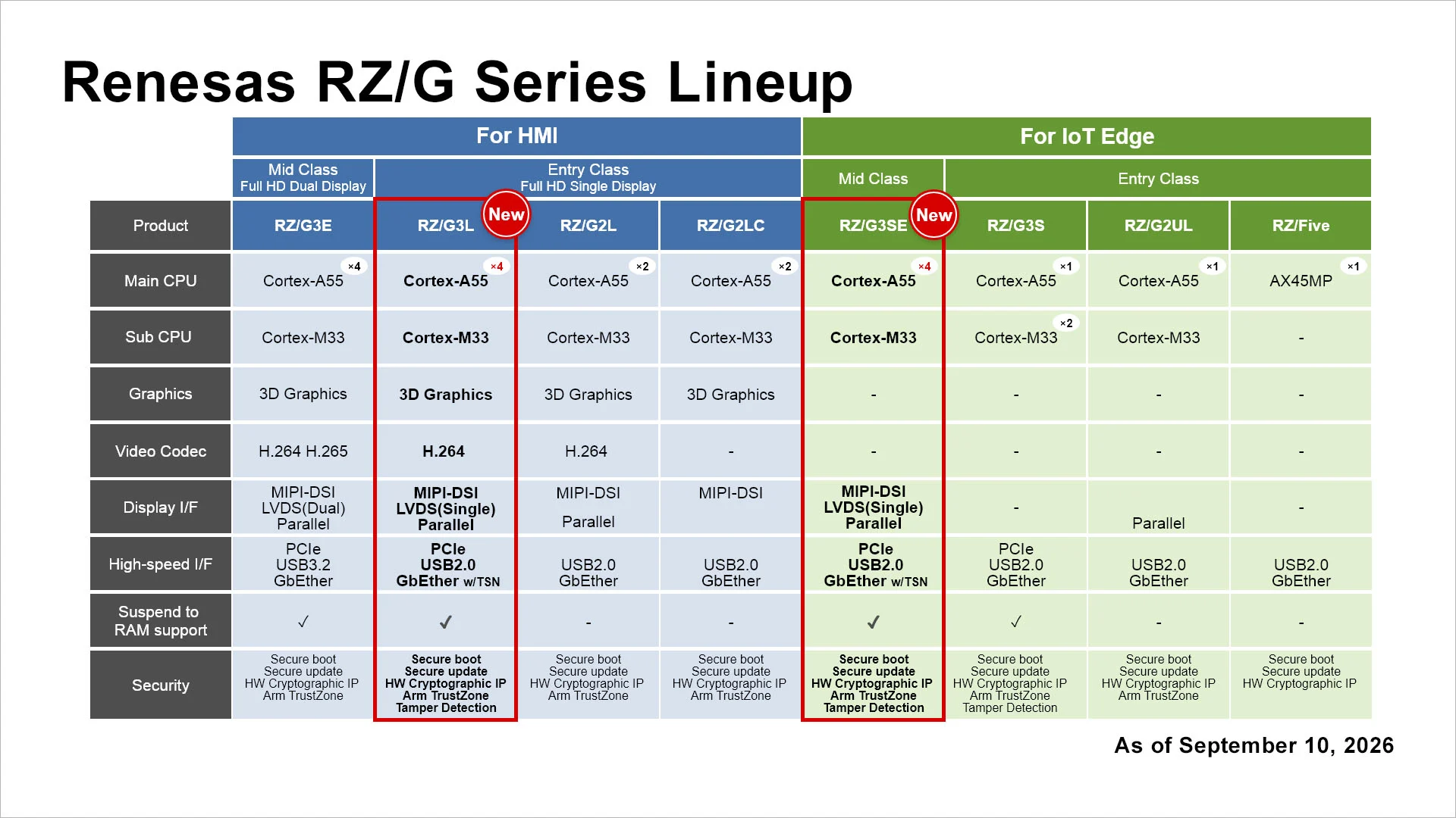

Renesas RZ/G Series Lineup

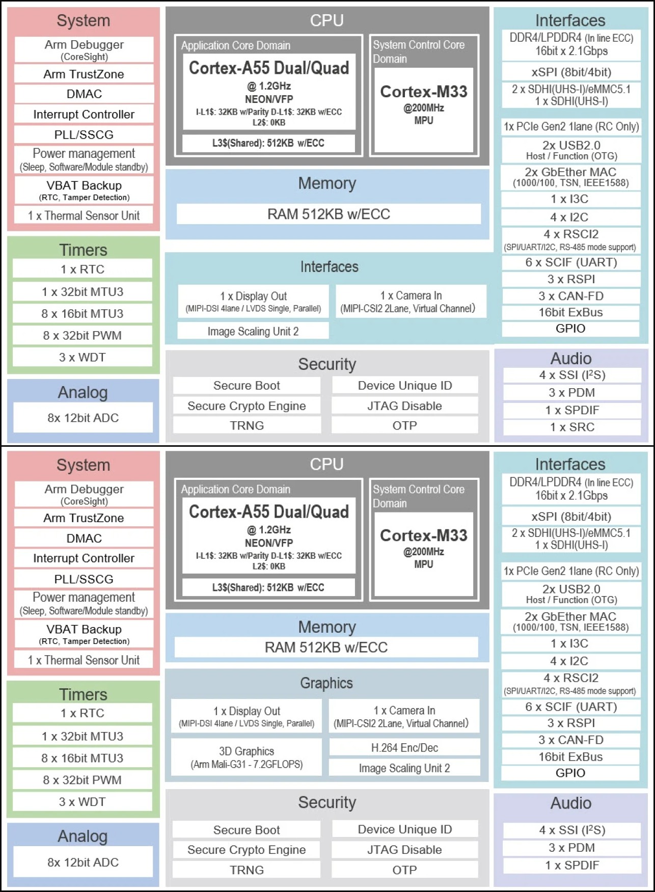

RZ/G3L and RZ/G3SE Block Diagram
RZ/G3L and RZ/G3SE 64-bit microprocessor units Block Diagram

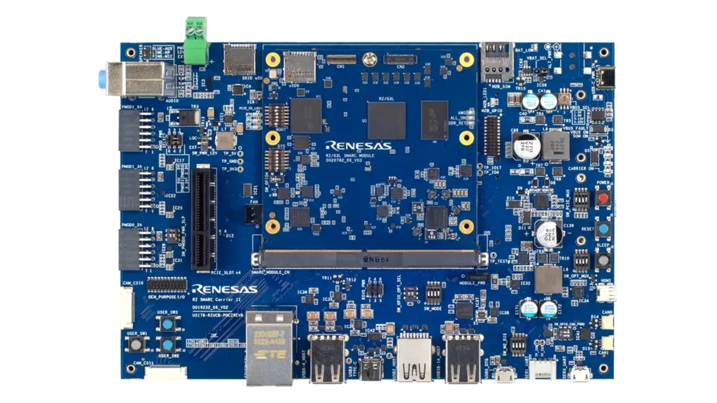

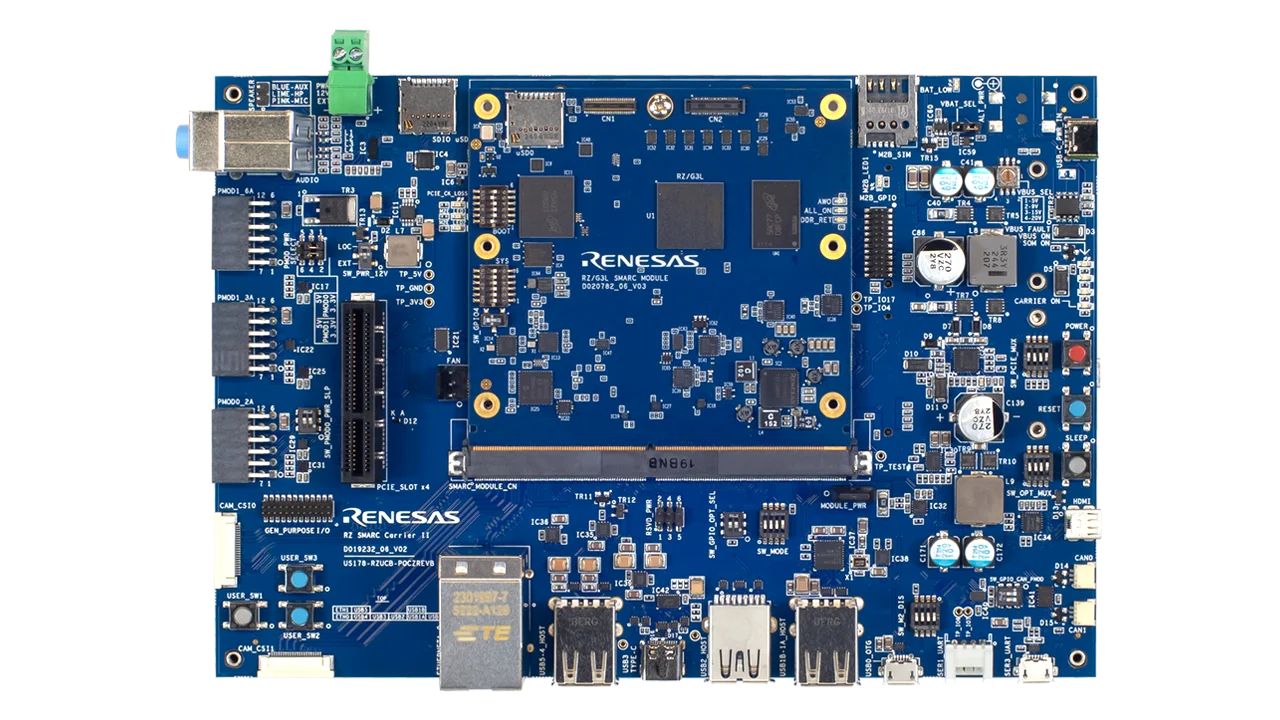

In terms of software, both RZ/G3L and RZ/G3SE 64-bit microprocessor units are supported by Renesas’ Yocto-based Linux stack, including Linux BSP Plus for the current Long-Term-Support (LTS) kernels and Verified Linux Package (VLP). The Cortex-A55 cores run Linux while the Cortex-M33 was used for real-time operations, with Zephyr RTOS named as one of the launch partners. Atmark Techno’s Armadillo Base OS is also available for the RZ/G MPUS. For the Human-Machine Interface (HMI) development, the MPUS are supported by the RZ/G HMI SDK and GUI frameworks, such as LVGL graphics library, Embedded Wizard, Slint and Candera, Spyrosoft and Qt. Both processors can enter deep standby with Linux retained in-memory for fast wake-up. Both the RZ/G3L and RZ/G3SE are available with a RZ/G3L Evaluation Board Kit which includes a single RZ/G3L SMARC 2.1.1 module board, common carrier board, and necessary adapter boards and cables. Another option is to take advantage of a pre-installed Linux image along with the HMI SDK that can be booted up and start testing the platform in no time. The RZ/G3L and RZ/G3SE processors each come in four different variants, and although Renesas stated that both families were available for sale, the stocks at distributors were low a day after the launch.
Evaluation Board Kit for RZ/G3L MPU
