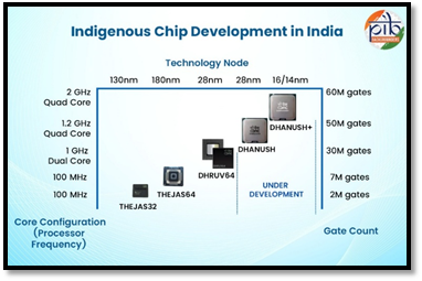

India consumes nearly 20% of the world’s microprocessors, and DHRUV64 offers the country’s large engineering talent base a modern indigenous platform to grow the domestic semiconductor ecosystem. It builds on earlier Indian processor initiatives such as SHAKTI (IIT Madras) for strategic and defence use, AJIT (IIT Bombay) for industrial and robotics applications, VIKRAM (ISRO–SCL) for space missions, and THEJAS64 (C-DAC) for industrial automation. Together, these processors play a key role in establishing a strong and independent Indian processor ecosystem.

DHRUV64 Driving India’s Indigenous Chip Roadmap
