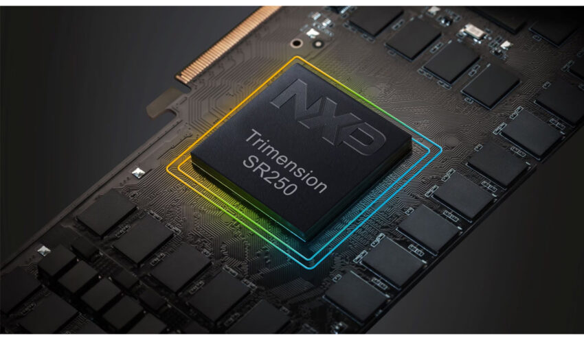

NXP just made a new chip called the Trimension SR250 IC using ultra-wideband (UWB) technology and radar to help things know where they are and is good for home automation and industrial use. Operates at 6 GHz - 8.5 GHz, it provides secure 3D ranging Angle of Arrival (AoA), Time Difference of Arrival (TDOA), and motion sensing, enabling new experiences in asset tracking, home automation, and industrial safety.
NXP just made a new chip called the Trimension SR250 IC using ultra-wideband (UWB) technology and radar to help things know where they are and is good for home automation and industrial use. Operates at 6 GHz – 8.5 GHz, it provides secure 3D ranging Angle of Arrival (AoA), Time Difference of Arrival (TDOA), and motion sensing, enabling new experiences in asset tracking, home automation, and industrial safety. With UWB technology, the SR250 achieves precise location accuracy of ±5 cm, supporting features like hands-free home access, appliance control, access management, and dangerous zone detection.
The SR250’s on-chip radar processing lowers power use, boosting efficiency, and it can run AI/ML algorithms on host processors like NXP’s i.MX, RW61x, and MCX families. Supported by firmware, middleware, and sample apps, it simplifies development. It is used in smart automation projects (for example home or kitchen automation), secure access, safety monitoring, and industrial tasks like worker tracking, collision avoidance, and danger zone detection. Development support is provided through SDKs for evaluation and development kits.

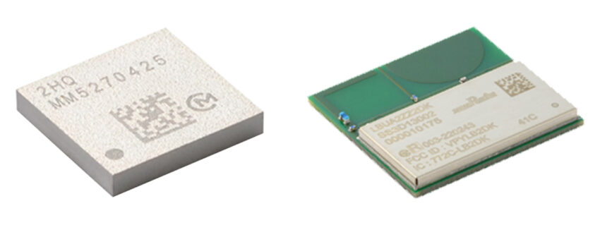

Murata Type 2HQ and Module
Trimension SR250 A UWB IC For Home and Industrial IoT Specifications:
  • Ultra-wideband (UWB) Technology
    • ±5 cm location accuracy
    • Secure ranging and precise positioning
    • Minimal interference with low power consumption
  • Radar Sensing
    • On-chip radar processing for presence and motion detection
    • Off-chip radar support for advanced AI/ML algorithms
  • Key Features
    • 3D secure ranging and motion sensing
    • Supports 360-degree AoA (Angle of Arrival) and TDOA (Time Difference of Arrival)
    • Direct battery connection support
    • Based on FiRa 3.0 specifications
  • Applications
    • Smart home: hands-free access, home automation, energy-saving appliances
    • Industrial IoT: asset tracking, worker safety, collision avoidance, and danger zone detection
  • Development Support
    • Compatible with NXP i.MX, RW61x, and MCX host processors
    • Firmware, middleware, and sample applications are provided for faster development
  • Power Efficiency
    • Reduced power consumption through on-chip radar processing
    • CAN functions as a wake-up signal for host systems

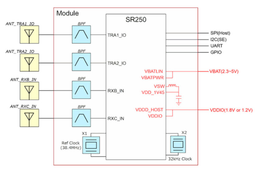

Murata Type 2HQ Block Diagram
After reviewing so far, I understand that the Trimension SR250 IC simplifies product development by combining multiple functions in one chip, reducing hardware costs and design complexity. According to the datasheet, NXP UWB chipsets are highly integrated and reliable UWB solutions, Murata’s modules integrate NXP UWB chipsets. Additionally, NXP is partnered with MURATA, and the Type2HQ module is also under development. This UWB IC is perfect for Home Automation and industrial IoT applications.
Currently, this product is available on NXP’s official site. However, it is not available for sale yet. You may find the additional information in the datasheet.
