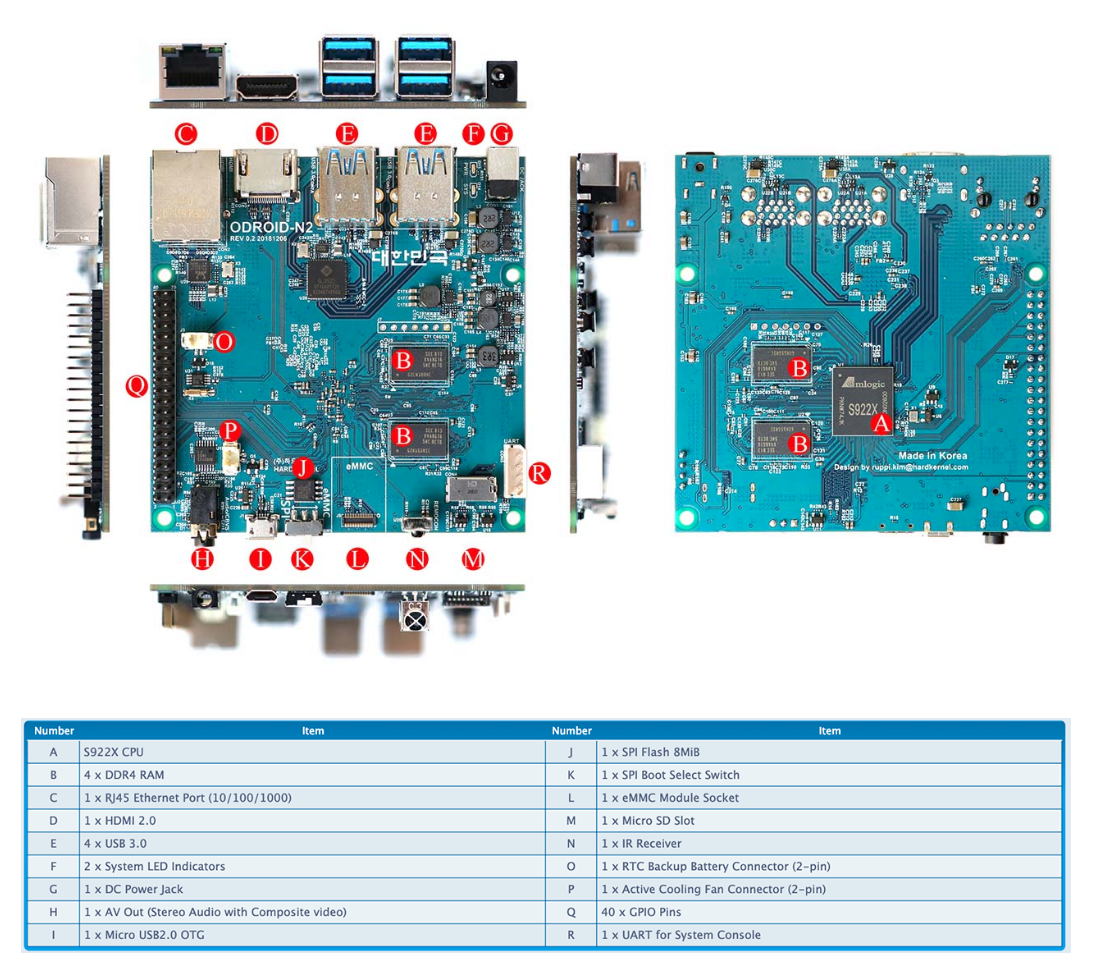

ODROID-N2 block diagram

Specifications listed for the Odroid-N2 include:
  • Processor — Amlogic S922X (4x Cortex-A73 @ 1.8GHz, 2x Cortex-A53 @ 1.9GHz); 12nm fab; Mali-G52 GPU with 6x 846MHz EEs
  • Memory/storage:
    • 2GB or 4GB DDR4 (1320MHz, 2640MT/s) 32-bit RAM
    • eMMC socket with optional 8GB to 128GB
    • MicroSD slot with UHS-1 SDR104 support
    • 8MB SPI flash with boot select switch and Petitboot app
  • Wireless — Optional USB WiFi adapter
  • Networking — Gigabit Ethernet port (Realtek RTL8211F); about 1Gbps
  • Media I/O:
    • HDMI 2.1 port for up to 4K@60Hz with HDR, CEC, EDID
    • Composite video jack with stereo line-out and 384Khz/32bit audio DAC
    • SPDIF audio via 40-pin
  • Other I/O:
    • 4x USB 3.0 host ports (340MB/s typical)
    • Micro-USB 2.0 OTG port (no power)
    • Serial console interface
    • Fan connector
  • Expansion — 40-pin GPIO header (25x GPIO, 2x i2C, 2x ADC, 6x PWM, SPI, UART, SPDIF, various power signals, etc.)
  • Other features — RTC (NXP PCF8563) with battery connector; IR receiver; metal heatsink; 2x LEDs; optional $4 acrylic case
  • Power — 7.5-20V DC jack; 12V/2A adapter recommended; consumption: 1.8W idle to 5.5W stress
  • Dimensions — 90 x 90 x 17mm
  • Operating system — Ubuntu 18.04 LTS with Kernel 4.9.152 LTS and Android 9 Pie BSPs
