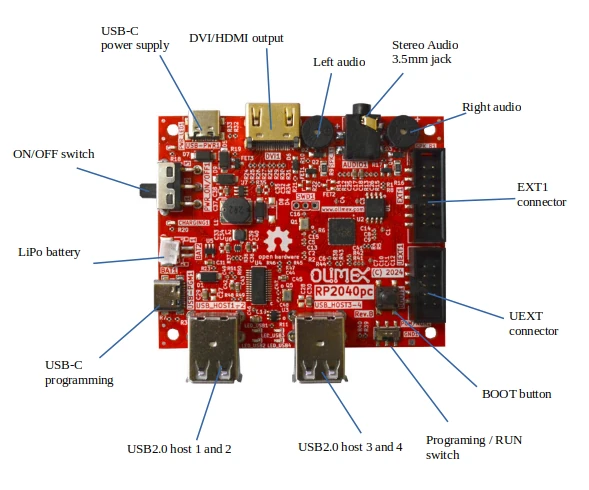

The board features an HDMI port for DVI video output, stereo audio with buzzers and a 3.5mm jack, four USB host ports, two UEXT expansion connectors, and a LiPo battery charger. It includes 16MB SPI Flash storage and operates on a 5V USB-C power supply. The deve board is open-sourced and can be used for applications including vintage computing, gaming, and educational projects.
Olimex RP2040pc Dev Board Specifications
  • Microcontroller – Raspberry Pi RP2040
  • dual-core Cortex-M0+ MCU @ 133 MHz with 264 KB SRAM
  • Storage – 16MB SPI Flash
  • Video Output – HDMI port (DVI output)
  • Audio
    • 2x buzzers for stereo audio output
    • 3.5mm audio jack for external amplifier
  • USB
    • 4x USB host ports
    • 1x USB-C port for programming
    • 1x USB-C port for power supply
  • Expansion – 2x UEXT connectors
  • Controls & Switches
    • Power switch
    • Programming/Execution switch
    • RP2040 bootloader button
  • Power Supply
    • 5V via USB-C port
    • LiPo battery charger
  • Dimensions – 80 x 65 mm (four mounting holes with 3.3mm diameter)
