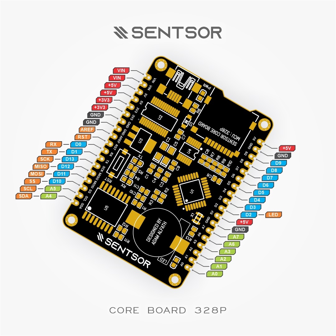

The all-in-one tiny SENTSOR 328P Core development board is one of the recent solutions by hobbyist/ electronics developer, Adam Alfath, to sensor management needs during data collection;  from sensing to monitoring and finally to logging. Designed to optimize data logging in projects, the compact and powerful Core 328P development board packs in an ATMEGA328P microcontroller unit running at 16 MHz, memory card adapter for microSD size, DS3231 precision RTC with around 3.5ppm accuracy and UART-to-USB chip for connection via USB. It also has castellated holes and pin headers that provide connection options which make it easier to apply the SENTSOR Core board to each of your data logging projects.
Features of the Core 328P include:
  • 2x 18P pin layout and pitch 2.54 mm for power, programming, and communication
  •  About 22 GPIOs at 5V pin levels
  • FT232RL serial UART to USB for data connection needs via USB without installing additional drivers.
  • AMS1117 5V regulator
  • MicroSD socket (connected via SPI)
  • Built-in LED and,
  • Arduino Nano 3.0 bootloader support
  • Board dimensions: 5.84 x 4.06 cm
