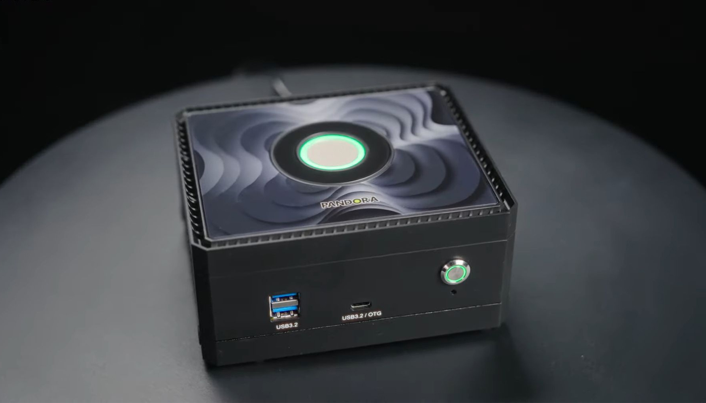

Palit has introduced Pandora, a compact AI computer powered by the NVIDIA Jetson Orin NX Super, available in 8GB and 16GB configurations with 117 and 157 AI TOPS, respectively. Measuring 123mm x 145mm x 66mm and weighing 470g, designers created it for space-constrained environments, featuring an active cooling system for reliable performance.

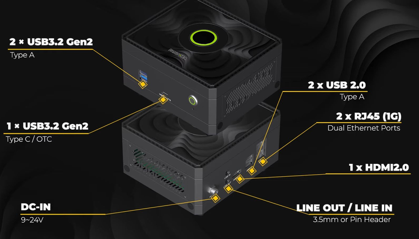

Pandora is used for smart retail, education, robotics, and generative AI. It offers extensive connectivity with dual 1G Ethernet ports, four USB ports, HDMI 2.0, audio I/O, and MIPI inputs. It comes with a pre-installed 128GB SSD and supports expandability through four M.2 slots for SSDs, Wi-Fi, and 5G/LTE modules.

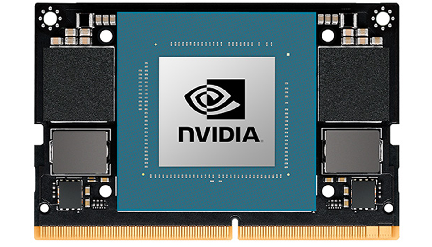

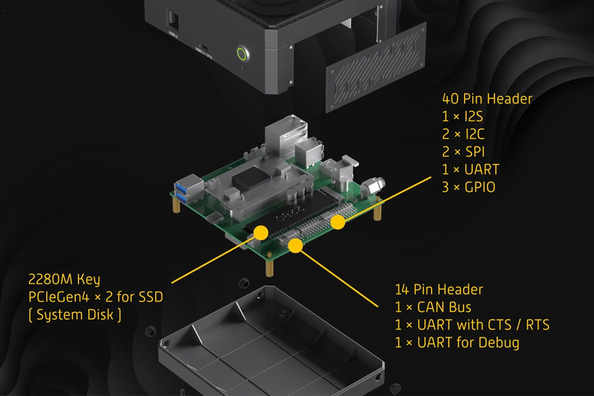

Additionally, it has a 14-pin UART, CAN bus for industrial use, and a removable base for easy changes. 3D-printed cases for custom projects can be made by developers, which is great for testing ideas. Software built-in helps manage devices, check performance, and fix issues quickly, making things run smoother with less downtime.

Palit Pandora AI Edge Computer Specifications:
  • SoC:
    • NVIDIA Jetson Orin NX Super
      • 8GB model: 117 AI TOPS
      • 16GB model: 157 AI TOPS
  • Memory:
    • 8GB or 16GB LPDDR5 RAM
  • Storage:
    • 128GB pre-installed SSD
    • 4x M.2 slots for SSD
  • Display and Video:
    • 1x HDMI 2.0
    • MIPI CSI-2 inputs for cameras
  • Connectivity:
    • 2x Gigabit Ethernet ports
    • 4x USB ports (OTG support)
    • Audio input/output through a 3.5mm jack or pin header
  • Expansion:
    • 1x I2S
    • 2x I2C
    • 2x SPI
    • 1x UART
    • 3x GPIO
    • 4x M.2 slots (for SSD, Wi-Fi, 5G/LTE modules)
  • I/O:
    • 14-pin Header
    • 1x CAN Bus
    • 1x UART with CTS/RTS
    • 1x USRT for Debug
    • CAN bus for industrial and automotive applications
  • USB:
    • 4x USB Type-A port
  • Misc:
    • Active cooling system
    • OTG Compatible USB ports
  • Power Supply: 12V or 19V DC power input
  • Dimensions: 123mm x 145mm x 66mm
  • Weight: 470g
