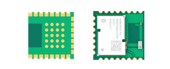

Panasonic Industry has launched the PAN B511-1C, a small, cost-effective Bluetooth 6.0 module designed for high-performance Bluetooth Low Energy applications and ultra-low-power wireless communication. Built around the Nordic nRF54L15 single-chip controller, it offers impressive performance and memory while keeping power consumption to a minimum.
PAN B511-1C nRF54L15 module
Featuring a hybrid Castellated holes and LGA footprint design, the module supports both Bluetooth 6.0 and 802.15.4. At its core, a 128 MHz Arm Cortex-M33 microcontroller is paired with 1.5 MB of non-volatile RAM and 256 KB of SRAM. A built-in chip antenna, 8 dBm output power, and certifications for CE RED, FCC, ISED, and MIC ensure strong performance and regulatory compliance. With a reception sensitivity of -98 dBm at 1 Mbit/s and -106 dBm at 125 kbit/s in long-range (LE) mode, the PAN B511-1C is a powerful solution for next-generation wireless applications.
