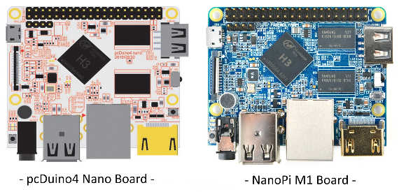

You might notice that this board is very similar to another one called NanoPi M1. They have the same design, features, ports and schematic and according to CNXSoft the manufacturer is the same. The main difference we can detect is that pcDuino4 has a white PCB and the other has a blue one.
pcduinonanopi
