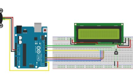

Schematics
The schematics for today’s project is almost similar to the one of the last tutorial. We will take out the three push-buttons and add a rotary encoder. Connect the components as shown in the schematics below.
Schematics
The rotary encoder used is an analog device, and for that reason all its three output pins are connected to analog pins on the Arduino.
To make the connections easier to follow, a pin map between the components is provided below.
LCD – Arduino
Reset - D3
pin2 - D4
pin3 - D5
pin4 - D11
pin5 - D13
VCC - 3.3v
Backlight - D7
GND - GND
Rotary Encoder – Arduino
GND - GND
VCC - VCC
SW - A2
DT - A1
CLK - A0
You can check out our previous tutorials on the Nokia 5110 LCD Display and the Rotary Encoder to better understand how they work.
Go over the schematics once again to ensure everything is as it should be then let’s proceed to write the code.
