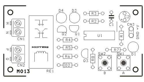

DC Motor Direction Control project offers direction control using digital logic gates and a DPDT relay. Features Supply input 12 VDC @ 75 mA Power LED DC Motor Direction LED Yellow/Green Relay Output: up to 7 A Onboard tactile switch for direction control Relay based drive design with diode protection LED indicator for direction indication Power-On LED indicator Terminal pins and screw terminal connector for easy input / output connection Four mounting holes of 3.2 mm each PCB dimensions 41 mm x 81 mm Schematic Parts List
DC_Motor_Direction_Controller_IMG
  • Supply input 12 VDC @ 75 mA
  • Power LED
  • DC Motor Direction LED Yellow/Green
  • Relay Output: up to 7 A
  • Onboard tactile switch for direction control
  • Relay based drive design with diode protection
  • LED indicator for direction indication
  • Power-On LED indicator
  • Terminal pins and screw terminal connector for easy input / output connection
  • Four mounting holes of 3.2 mm each

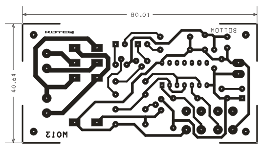

  • PCB dimensions 41 mm x 81 mm

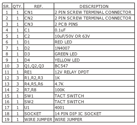

Parts List
DC_Motor_Direction_Controller_BOM
