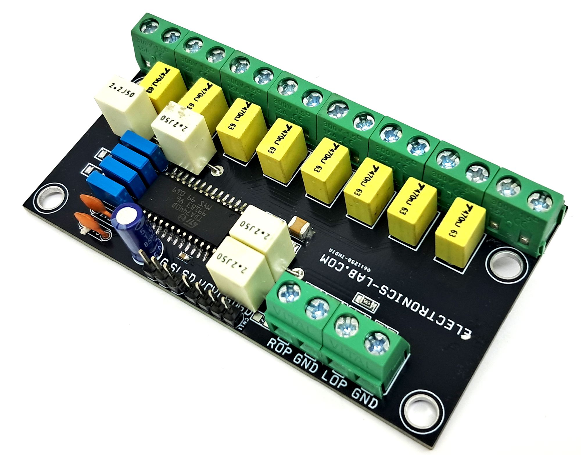

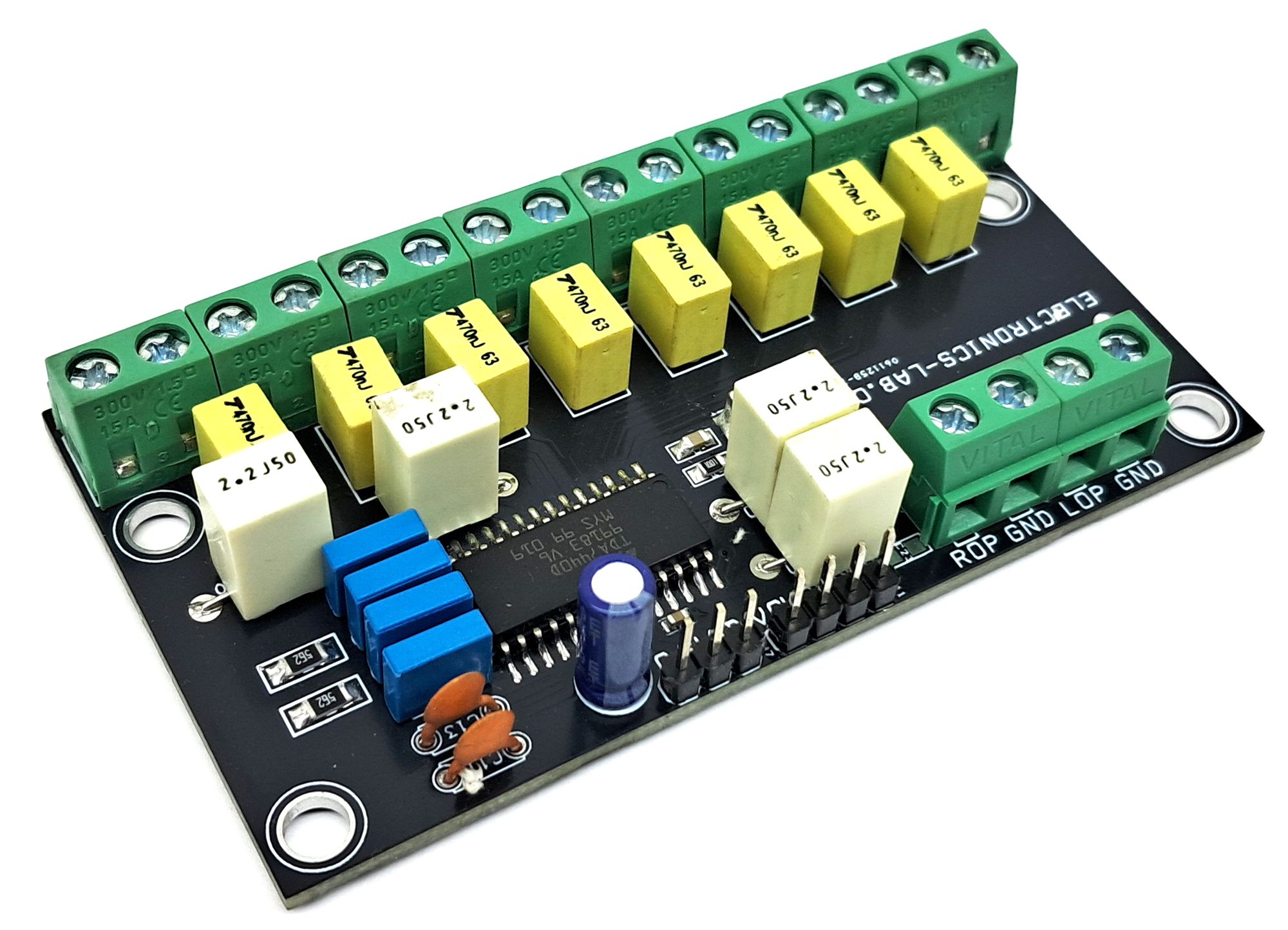

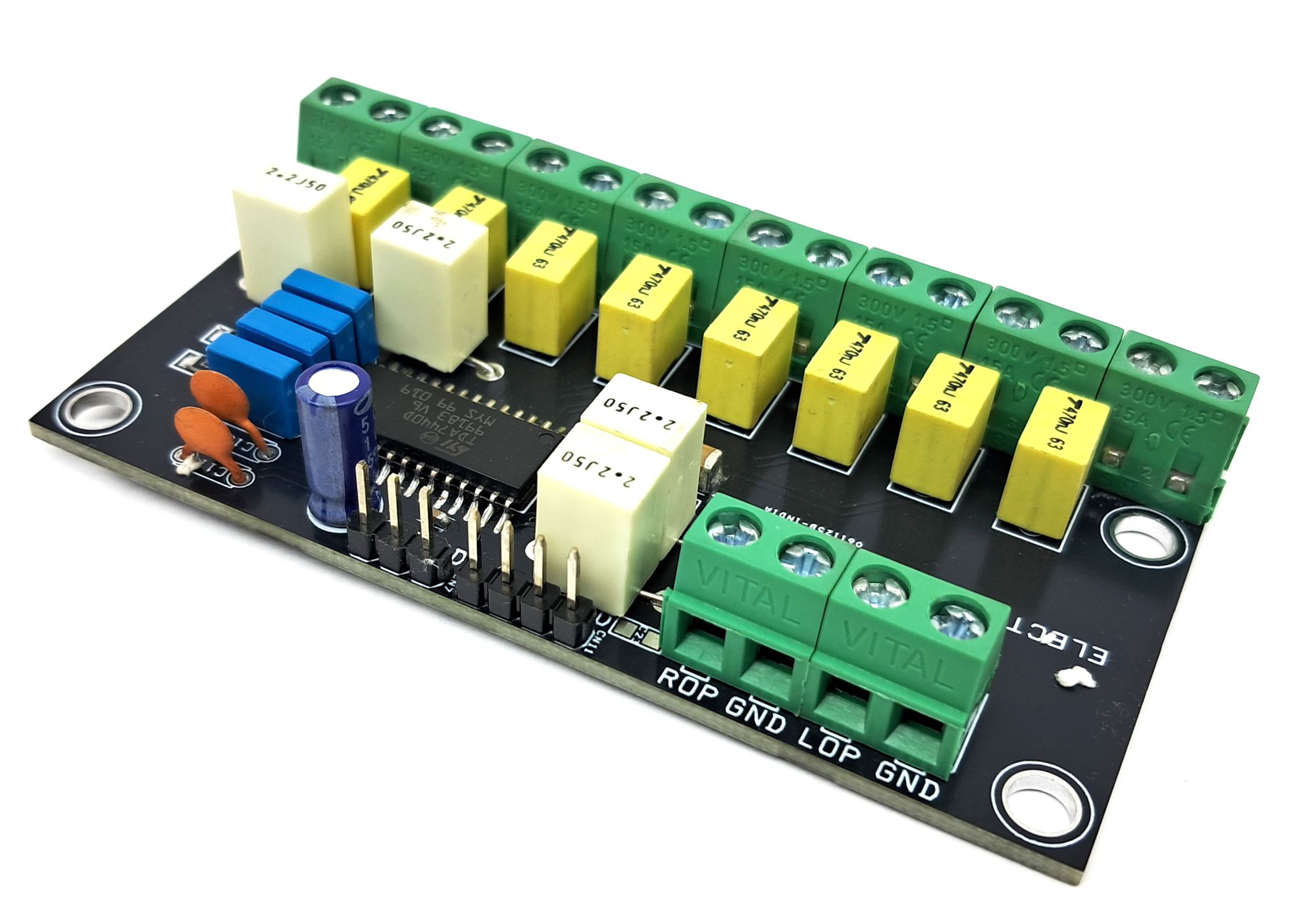

Digitally Controlled Audio Processor using TDA7440
TDA7440 Audio: I2C-based Hi-Fi volume, tone, and balance control with selectable input gain.

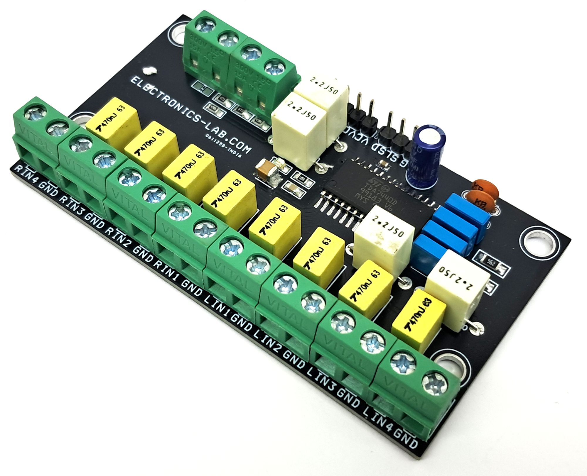

This Audio Processor designed using TDA7440 chip from ST. The chip is a volume tone (bass and treble) balance (Left/Right) processor for quality audio applications in Hi-Fi systems. A selectable input gain is provided. Control of all the functions is accomplished by serial bus I2C. The AC signal setting can be altered by resistor networks and switches combined with operational amplifiers.
- Supply 9V DC (Range 6V to 10V)
- All functions Programmable Via I2C Serial Bus
- 4 Channel Stereo Inputs, Multiplexer, I2C Selectable
- Treble and Bass Control 2.0dB Steps
- One Channel Stereo Output
- Two Speaker Attenuators, Two Independ Speaker Control In 1.0dB Steps for Balance
- Volume Control In 1.0dB Steps
- Screw Terminals for Audio Inputs and Outputs
- Header Connector for I2C Digital Interface
- Header Connector for Power Input
- On Board Power LED

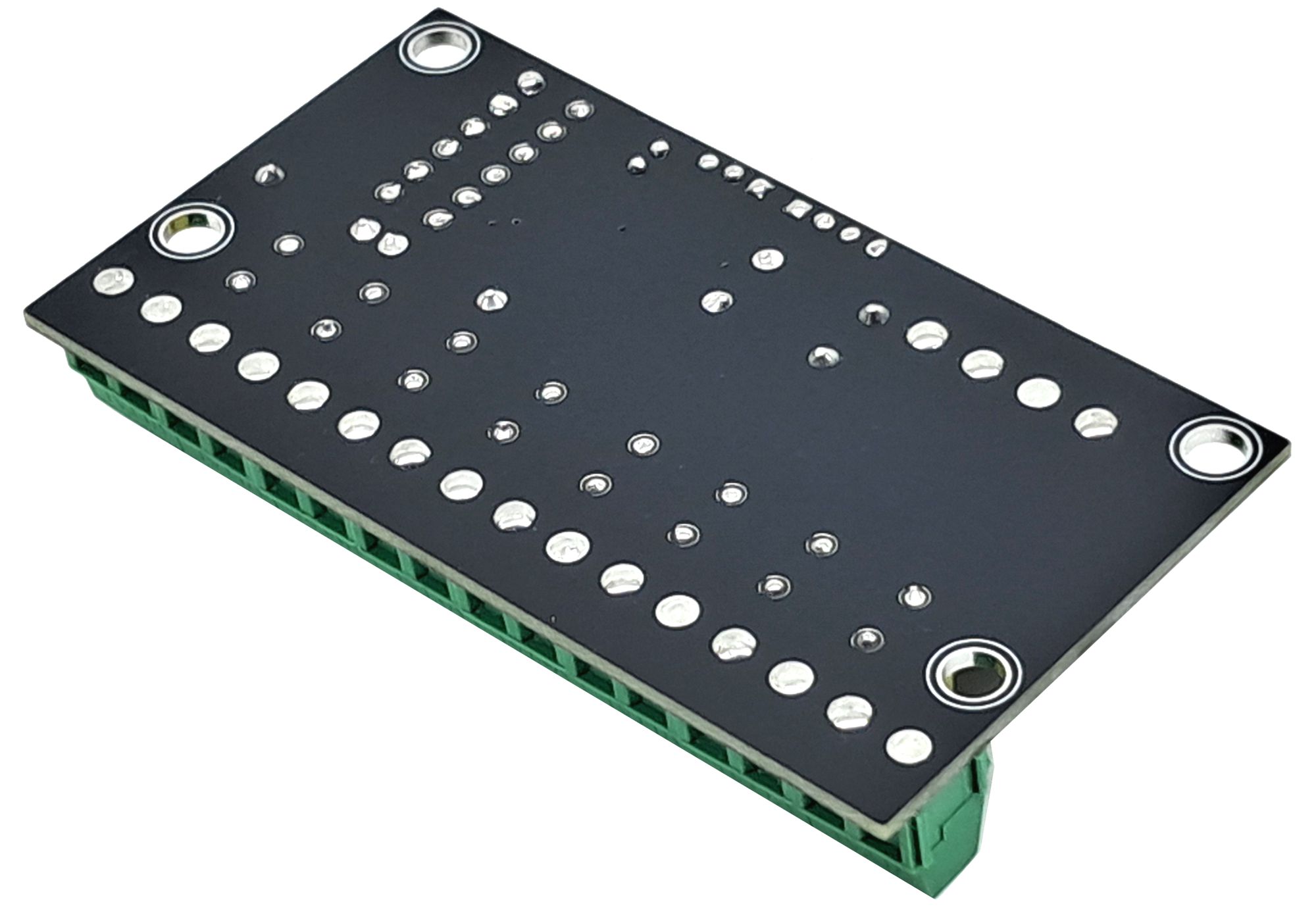

- 4 x 4MM PCB Mounting Holes
- PCB Dimensions 82.55 x 44.93 mm

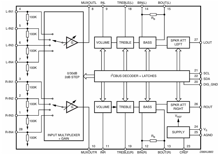

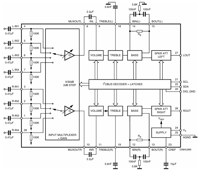

TDA7440
The first and the last stages are volume control blocks. The control range is 0 to -47dB (mute) for the first one, 0 to -79dB (mute) for the last one. Both of them have 1dB step resolution. The very high resolution allows the implementation of systems free from any noisy acoustical effect. The TDA7440D audio processor provides 3 bands tones control.
Treble Stage
The treble stage is a high pass filter whose time constant is fixed by an internal resistor (25KΩ typical) and an external capacitor connected between treble pins and ground.

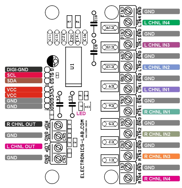

Connections
- CN1: Pin 1 = Right Channel Audio In4, Pin 2 = GND
- CN2: Pin 1 = Right Channel Audio In3, Pin 2 = GND
- CN4: Pin 1 = Right Channel Audio In2, Pin 2 = GND
- CN6: Pin 1 = Right Channel Audio In1, Pin 2 = GND
- CN8: Pin 1 = Left Channel Audio In1, Pin 2 = GND
- CN9: Pin 1 = Left Channel Audio In2, Pin 2 = GND
- CN10: Pin 1 = Left Channel Audio In3, Pin 2 = GND
- CN12: Pin 1 = Left Channel Audio In4, Pin 2 = GND
- CN3: Pin 1 Left Channel Audio Output, Pin 2 = GND
- CN5: Pin 1 Right Channel Audio Output, Pin 2 = GND
- CN7: Pin 1 SDA Digital Pin, Pin 2 = SCL Digital Pin, Pin 3 = Digital GND
- CN11: Pin 1,2 = VCC, Pin 3,4 = GND
- D1: Power LED

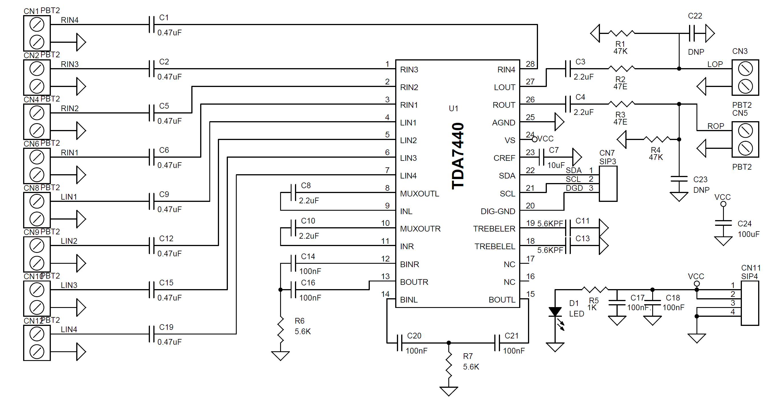

Schematic
Parts List
| NO. | QNTY. | REF. | DESC. | MANUFACTURER | SUPPLIER | SUPPLIER PART NO |
| 1 | 10 | CN1,CN2,CN3,CN4,CN5,CN6,CN8,CN9,CN10,CN12 | 2 PIN SCREW TERMINAL PITCH 5.08MM | PHOENIX | DIGIKEY | 277-1247-ND |
| 2 | 1 | CN7 | 3 PIN MALE HEADER PITCH 2.54MM | WURTH | DIGIKEY | 732-5316-ND |
| 3 | 1 | CN11 | 4 PIN MALE HEADER PITCH 2.54MM | WURTH | DIGIKEY | 732-5317-ND |
| 4 | 8 | C1,C2,C5,C6,C9,C12,C15,C19 | 0.47uF/63V FILM CAPACITOR 5X7MM | DIGIKEY | ||
| 5 | 1 | C7 | 10uF/50V ELECTROLYTIC 5X11MM | DIGIKEY | ||
| 6 | 4 | C3,C4,C8,C10 | 2.2uF/50V 7X11MM THT | DIGIKEY | ||
| 7 | 2 | C11,C13 | 5.6KPF/50V CERAMIC DISC TYPE | DIGIKEY | ||
| 8 | 4 | C14,C16,C20,C21 | 100nF/63V FILM CAPACITOR 2.5X7MM THT | DIGIKEY | ||
| 9 | 1 | C17 | 100nF/16V CERAMIC SMD SIZE 0603 | YAGEO/MURATA | DIGIKEY | |
| 10 | 2 | C22,C23 | DNP | |||
| 11 | 1 | C24 | 47uF OR 100uF/16V CERAMIC SMD SIZE 1210 | YAGEO/MURATA | DIGIKEY | |
| 12 | 1 | D1 | LED RED SMD SIZE 0805 | OSRAM | DIGIKEY | 475-1278-1-ND |
| 13 | 2 | R1,R4 | 47K 5% SMD SIZE 0805 | YAGEO/MURATA | DIGIKEY | |
| 14 | 2 | R2,R3 | 47E 5% SMD SIZE 0805 | YAGEO/MURATA | DIGIKEY | |
| 15 | 1 | R5 | 1K 5% SMD SIZE 0805 | YAGEO/MURATA | DIGIKEY | |
| 16 | 2 | R6,R7 | 5.6K 5% SMD SIZE 1206 | YAGEO/MURATA | DIGIKEY | |
| 17 | 1 | U1 | TDA7440 SOIC28 | ST | DIGIKEY | 497-8883-1-ND |
| 18 | 1 | C18 | 100nF/16V CERAMIC SMD SIZE 0805 | YAGEO/MURATA | DIGIKEY |
