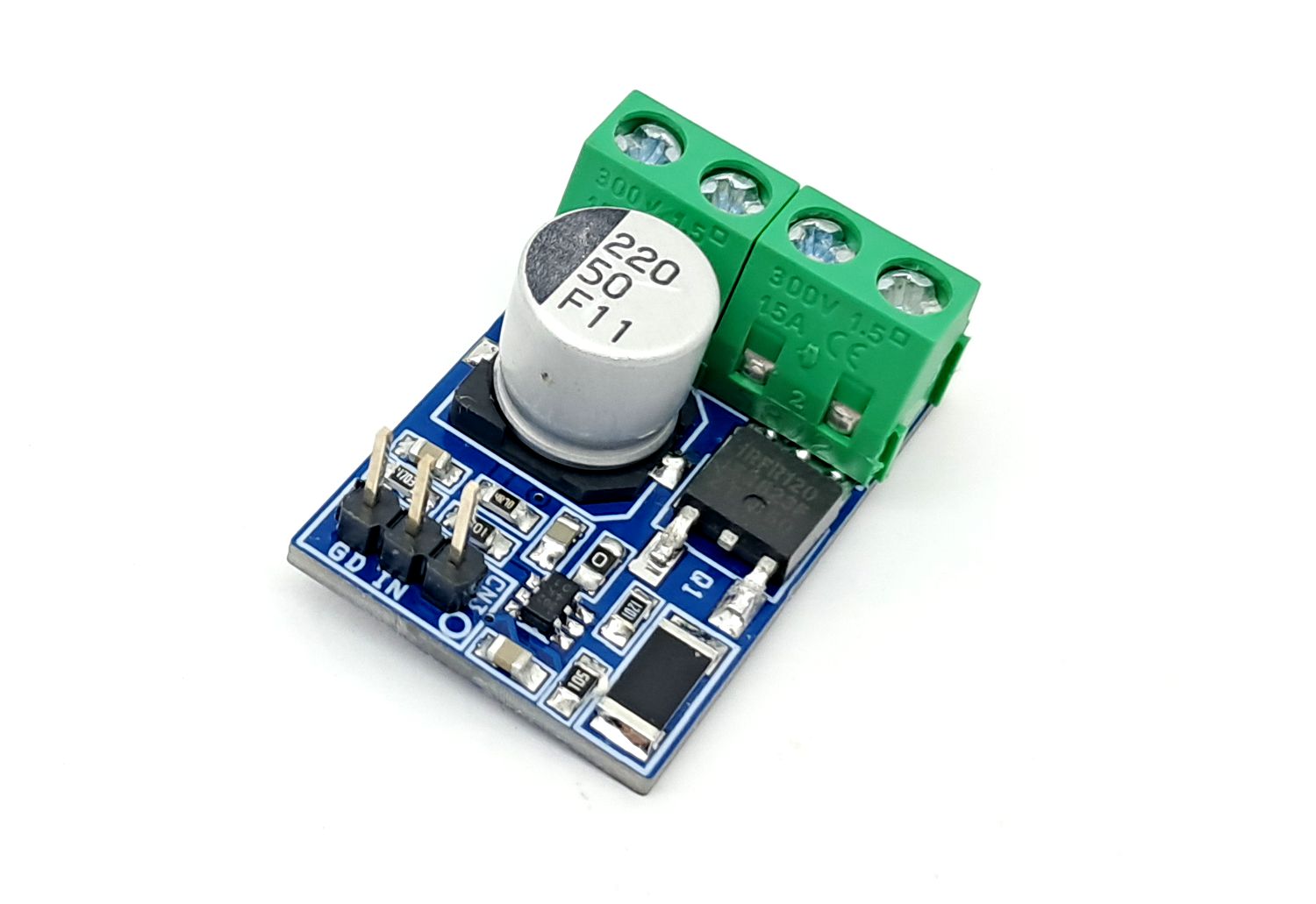

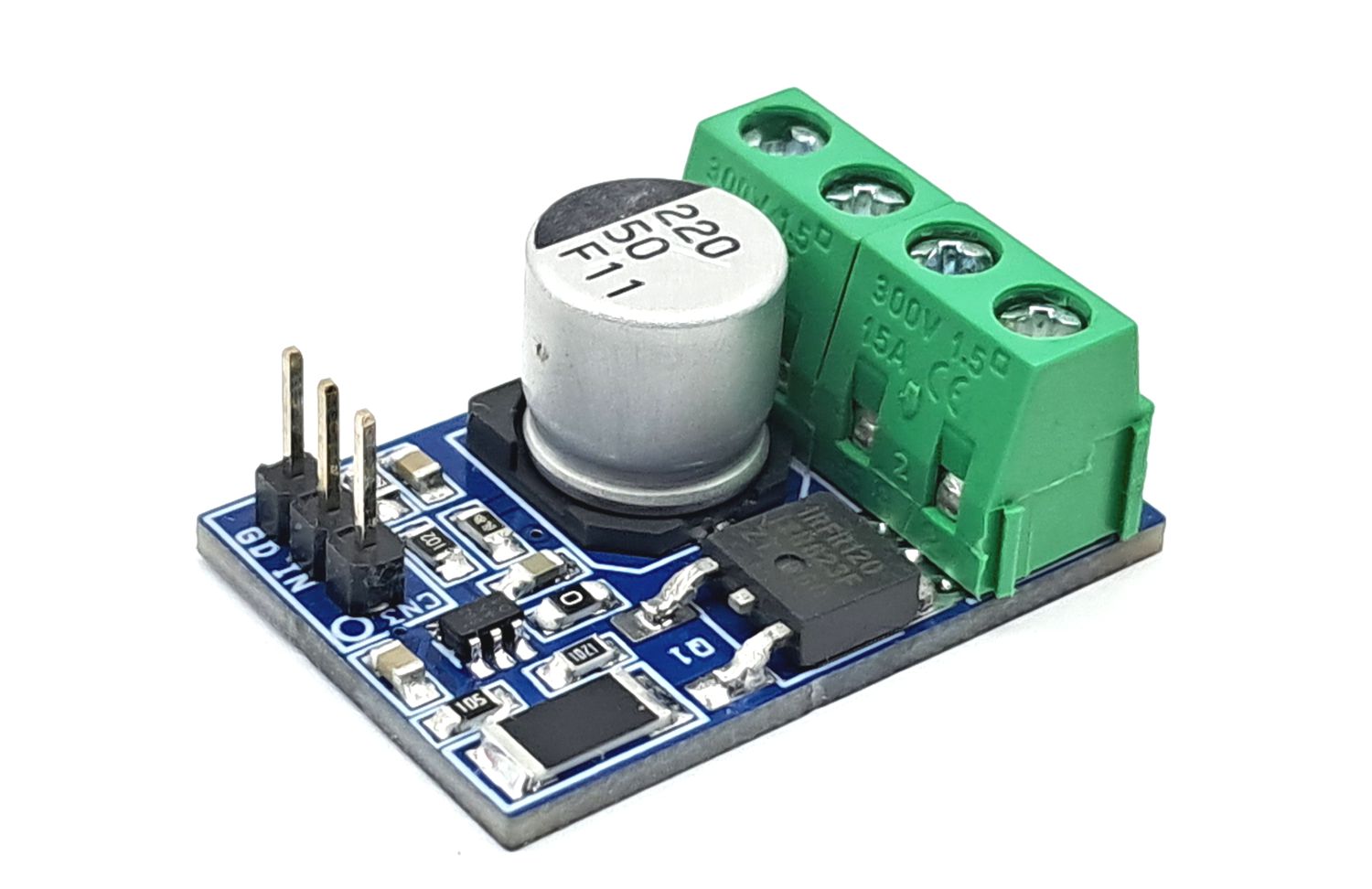

This 48V, 200mA dimmable linear LED driver is a highly reliable solution for various LED applications. The project features the BCR602 chip, which supports LED engines, LED modules, and LED strips.
This 48V, 200mA dimmable linear LED driver is a highly reliable solution for various LED applications. The project features the BCR602 chip, which supports LED engines, LED modules, and LED strips. The driver utilizes a MOSFET (Q1) and the BCR602 chip to provide constant current control, and it can also be equipped with a Bipolar Junction Transistor (BJT).
The BCR602 chip regulates the LED current using the power Q1 transistor, allowing for precise control over the current level. The LED current is fully scalable by adjusting the external Current Sense (CS) resistor (R6), providing flexibility in design. Additionally, the BCR602 chip suppresses voltage ripple from the power supply, ensuring a constant LED current that results in better light quality.
The LED current can be dimmed using a resistor (Rset R7) or by applying an analog PWM signal to the Multi-Function Input Output (MFIO) pin. The embedded hot plug protection feature enables safe plug-in and plug-out of any LED load during operation, without compromising the driver’s performance.
The LED current level is configured to 200mA and has been thoroughly tested. The shunt resistors define the maximum LED current, which can be adjusted down to an effective resistor R6. The voltage drop at the VSENSE pin, caused by the shunt resistors, is 400mV, or less in case of dimming, resulting in improved overall system efficiency and providing extra voltage headroom to compensate for tolerances in LED forward voltage or supply voltage.
Furthermore, the driver features a smart Over-Temperature Protection (OTP) function, which reduces the LED current when the junction temperature of the BCR602 chip exceeds a certain threshold, ensuring safe and reliable operation.

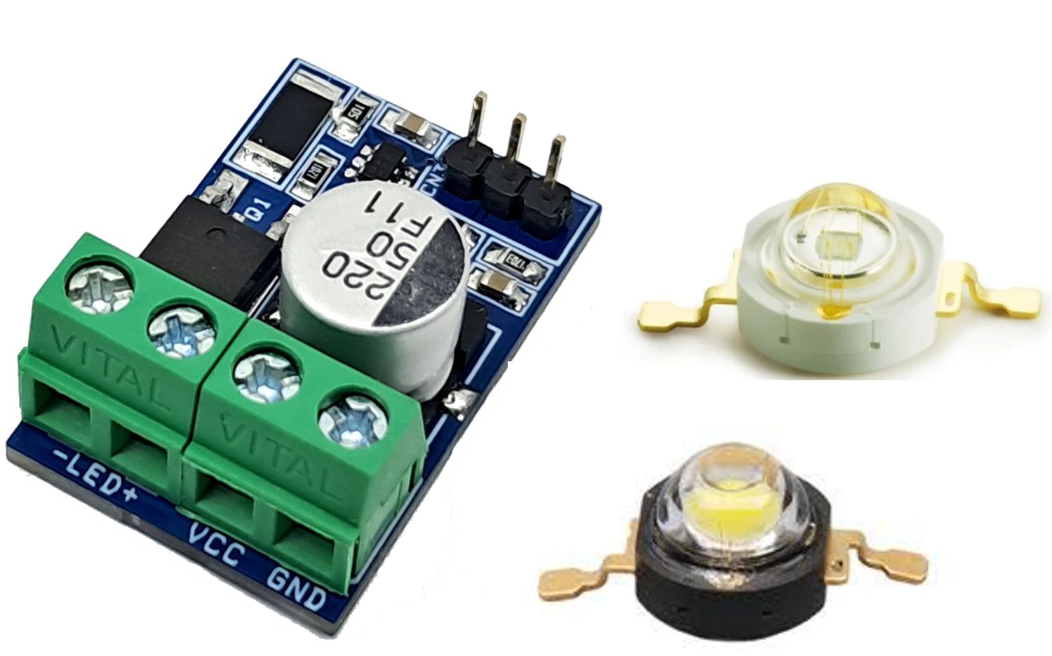

  • Supply 8V to 48V (Supports Up to 60V -> Read Note)
  • Load Current 200mA (Supports Higher Current -> Read Note)
  • Project can drive 20 Series LEDs (With 60V Power Supply)
  • LED current precision ±3%
  • BCR602 Supports MOSFET and BJT (DPAK or SOT-223
  • 100 Hz/120 Hz supply ripple suppression
  • 3 percent analog dimming or 1 percent PWM dimming of LED current at the MFIO pin
  • Board suitable for assembly with transistor packages of types SOT-223, DPAK
  • Rset functionality at the MFIO pin (R7)
  • Hot-plug protection to minimize LED inrush current
  • OTP function vs junction temperature
  • Screw Terminals for LED and Power Input
  • Header Connector for Dimmer Voltage Input 0 to 3.3V or PWM Input

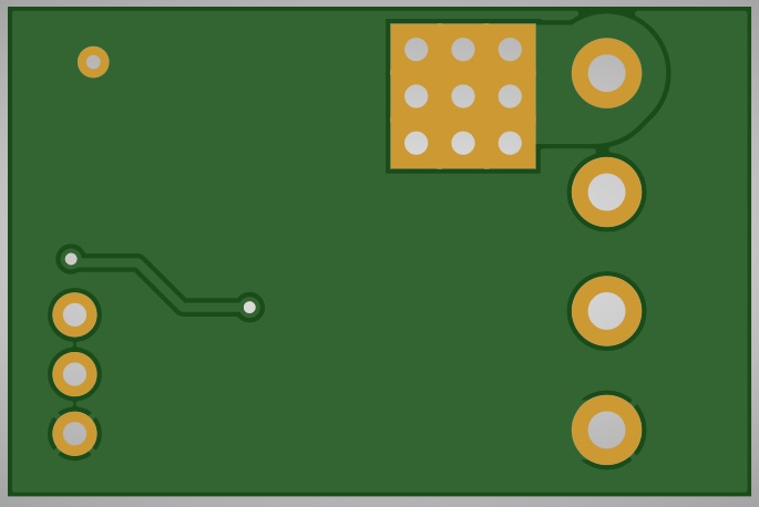

  • PCB Dimensions 31.75 x 20.96 mm
Note 1: The board supports a power up 48VDC. The board also can support supply input up to 60V, In this case, change the capacitor C1, C2, C3 voltage to 63V or more
Note 2: The board is configurable up to 1.5 A LED current control, precise current set-up via shunt resistor R6. Read the datasheet for more info.

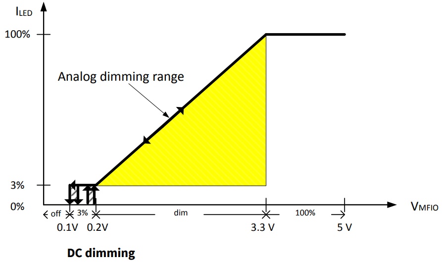

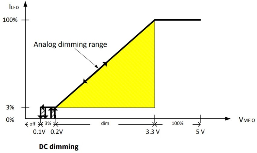

Note 3: Default Current is set 200mA maximum, change the resistor R7 to set the lower current (R6 can be between 10K to 470K), Rset = 470 kΩ allows 100 percent LED current according to the VSENSE resistor configuration. Technically, there is no upper limit for this resistor. A suitable range is between 10 kΩ for minimum dimming and 470 kΩ  for maximum.  3% analog dimming of LED current by resistor Rset or DC voltage
Note 4: Feed 0 to 3.3V to Pin 1,2 of CN3 for dimmer control. (3% analog dimming of LED current by resistor Rset R7 or DC voltage)
Note 5: Project tested with IRFR120 MOSFET, user can use Opti-MOS BSP716N or BJT Transistor. Refer to the datasheet of BCR602 for more info.
Note 6: Dimming at pin MFIO 3% analog dimming of LED current by resistor Rset or DC voltage 1% PWM dimming of LED current by PWM signals

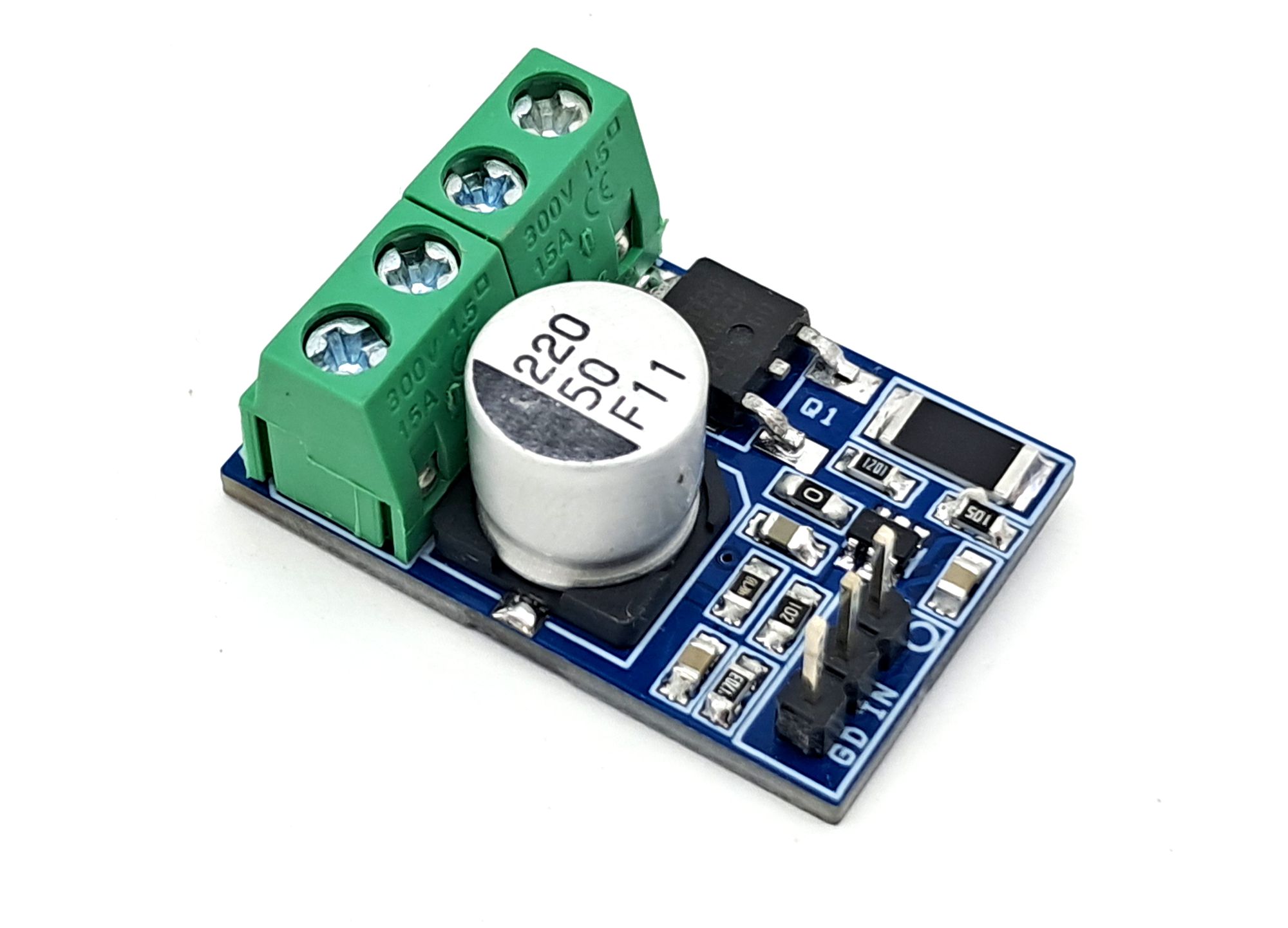

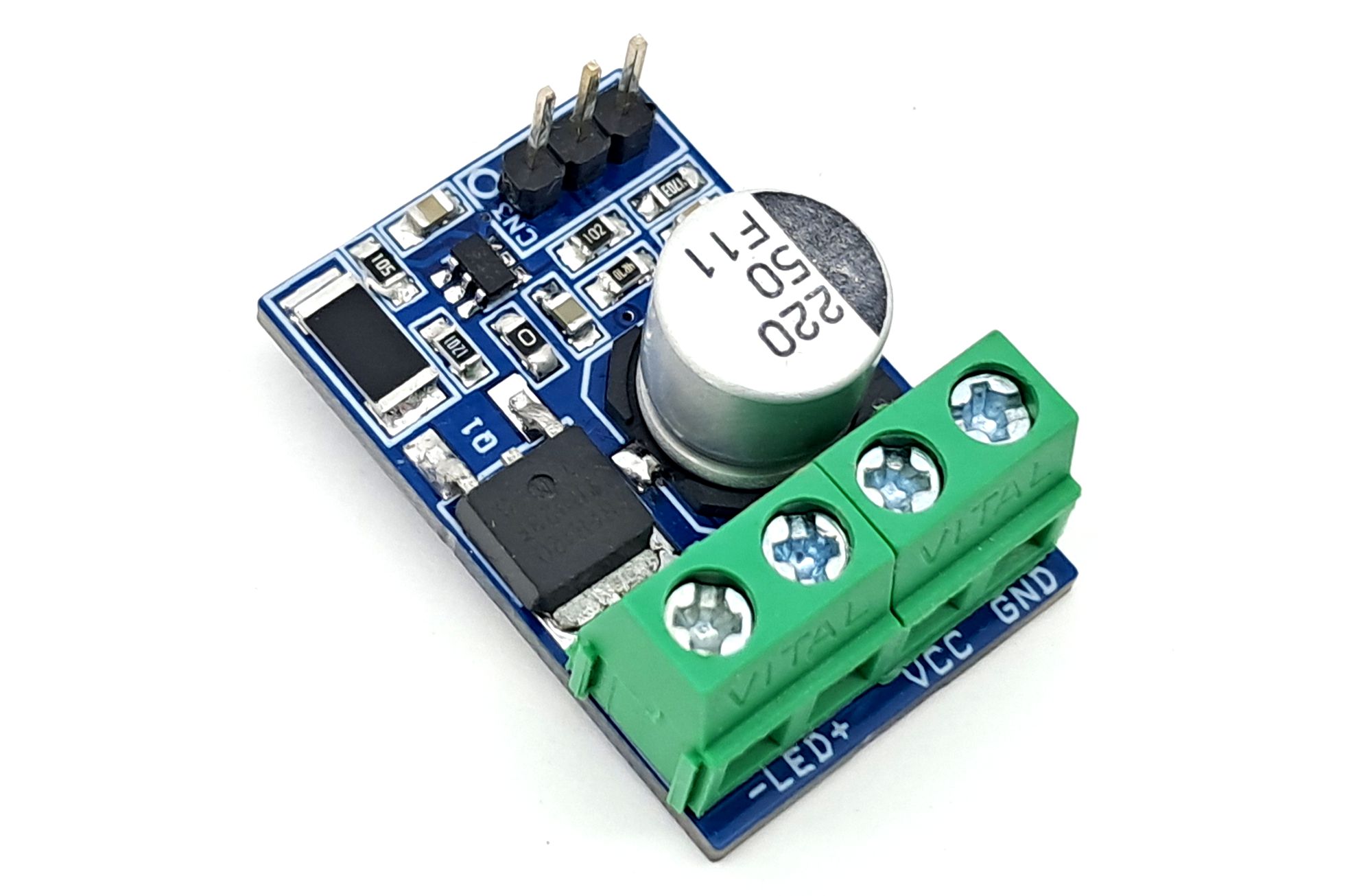

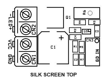

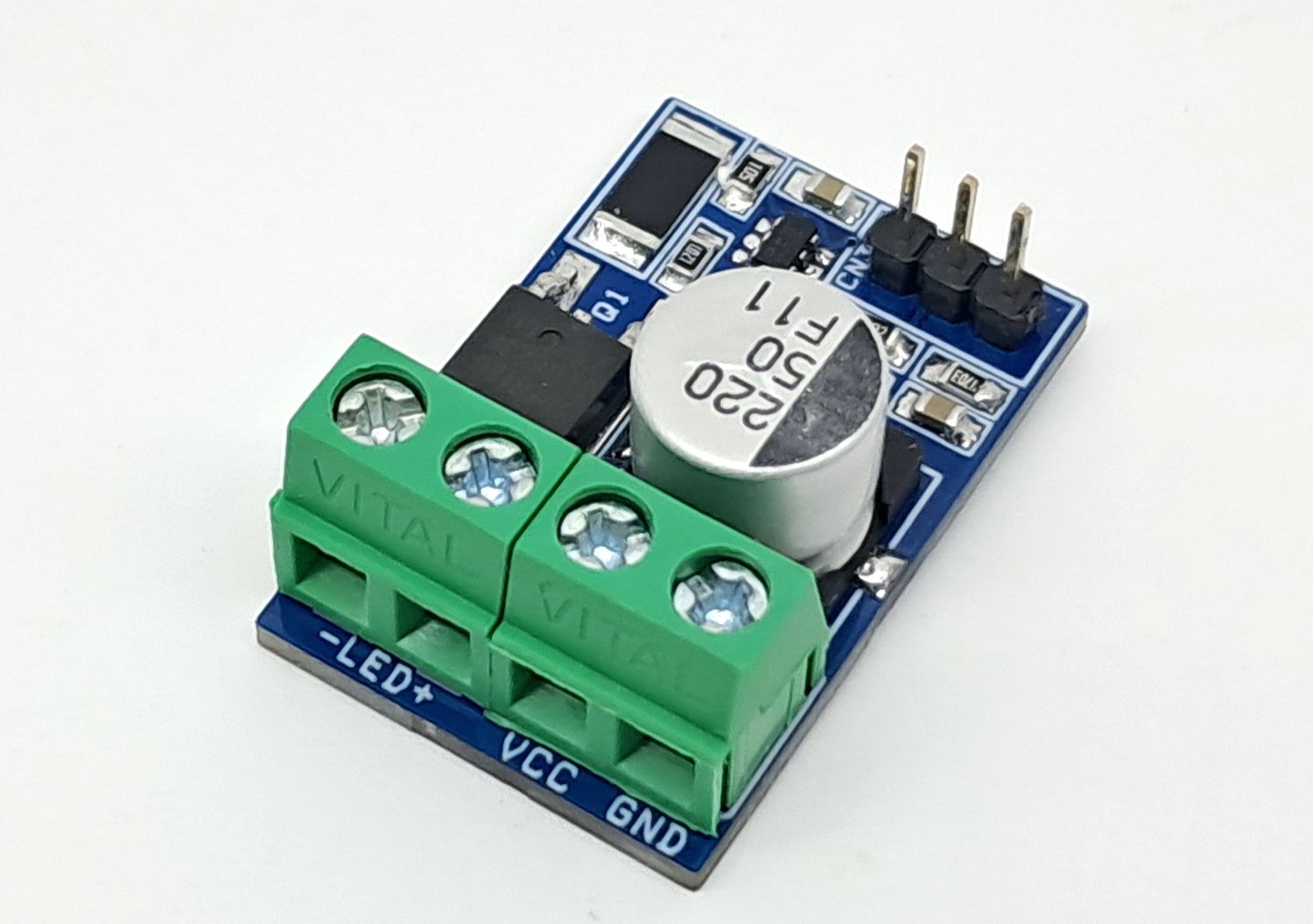

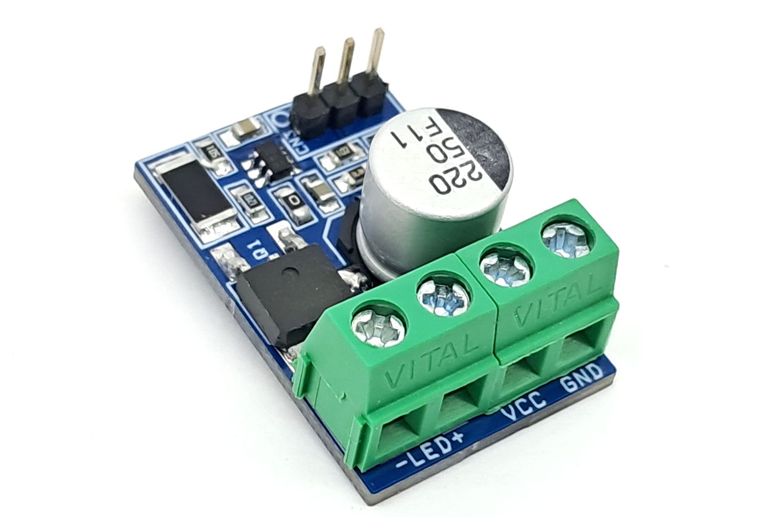

Connections
  • CN1 Power Input: Pin 1 + 48V DC, Pin 2 GND
  • CN2 LED: Pin 1 + LED, Pin 2 -LED (Supports up to 20 Series LEDs with 60V Power Input)
  • CN3 Dimmer Control Voltage Input: Pin 1,2= Dimmer Voltage Input 0 to 3.3V, Pin 3 = GND
  • Resistor R7: Default Load Current is set to 200mA, Choose 10K ohms to 470K for Current Change (Fixed Dimmer)

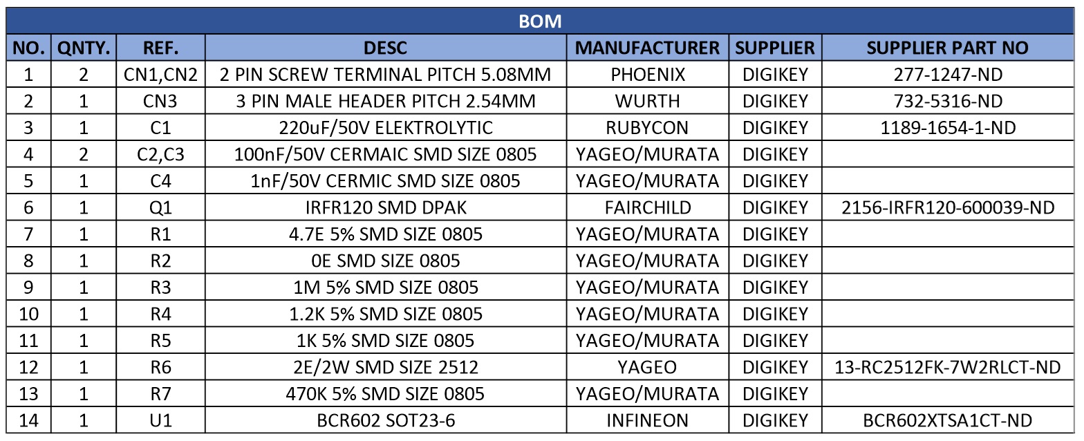

Parts List
NO.QNTY.REF.DESCMANUFACTURERSUPPLIERSUPPLIER PART NO
12CN1,CN22 PIN SCREW TERMINAL PITCH 5.08MMPHOENIXDIGIKEY277-1247-ND
21CN33 PIN MALE HEADER PITCH 2.54MMWURTHDIGIKEY732-5316-ND
31C1220uF/50V ELEKTROLYTICRUBYCONDIGIKEY1189-1654-1-ND
42C2,C3100nF/50V CERMAIC SMD SIZE 0805YAGEO/MURATADIGIKEY
51C41nF/50V CERMIC SMD SIZE 0805YAGEO/MURATADIGIKEY
61Q1IRFR120 SMD DPAKFAIRCHILDDIGIKEY2156-IRFR120-600039-ND
71R14.7E 5% SMD SIZE 0805YAGEO/MURATADIGIKEY
81R20E SMD SIZE 0805YAGEO/MURATADIGIKEY
91R31M 5% SMD SIZE 0805YAGEO/MURATADIGIKEY
101R41.2K 5% SMD SIZE 0805YAGEO/MURATADIGIKEY
111R51K 5% SMD SIZE 0805YAGEO/MURATADIGIKEY
121R62E/2W SMD SIZE 2512YAGEODIGIKEY13-RC2512FK-7W2RLCT-ND
131R7470K 5% SMD SIZE 0805YAGEO/MURATADIGIKEY
141U1BCR602 SOT23-6INFINEONDIGIKEYBCR602XTSA1CT-ND

Dimming Diagram

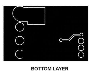

Gerber View
