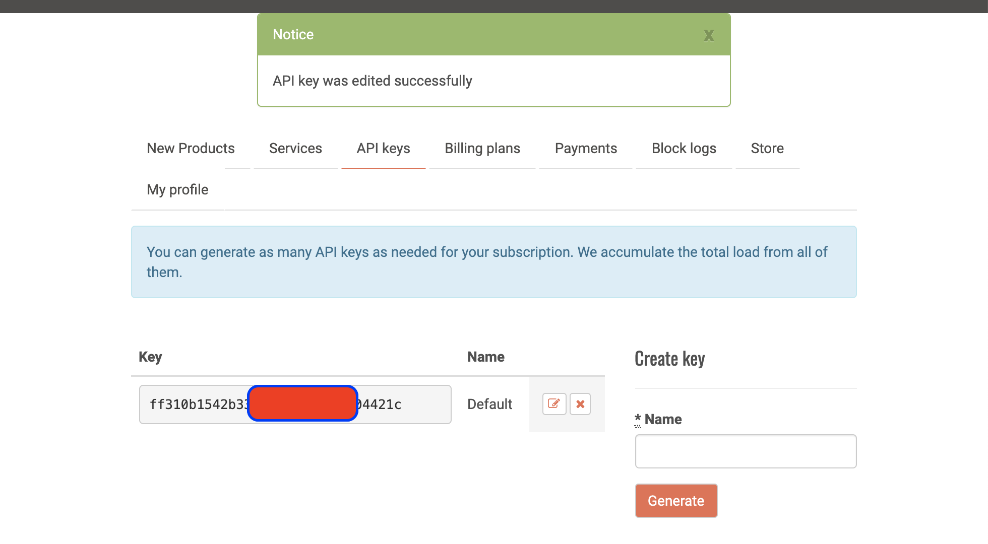

Obtain OpenWeatherMap Credentials
As mentioned during the introduction, the weather information to be displayed on the OLED will be obtained from OpenWeatherMap, as such, before we proceed to write the code for this project, it is important to Signup and obtain the credentials, in this case, an API key, that will be used by our device to connect to the service.
To do this follow the steps below:
1. Point your web browser to OpenWeatherMaps Website and hit the “Sign up” button. If you already have an OpenWeatherMap account, just skip to the 3rd step.
2. Once the signup page opens, fill in all the necessary details and click on create an account. If successful, you will be automatically subscribed to the free OpenWeatherMap plan which will allow you to perform up to 60 API calls per minute among other perks. Since this is just a demo project, I believe this to be good enough but if you’d like more access, you can check out some of the other packages and subscribe to them if needed.
3. With registration complete, select the API Keys tab at the top of the resulting page. It should lead to a page with your API Key displayed as shown in the image below:
Copy the API key and paste in a notepad or any other safe place. We will need it for our code.
With this done successfully, we can proceed to write the code for the project.

Sean`
I just keep getting error 401 back from the API call.. I checked 3x to make sure I had right API Key?
Jan
Same issue, error 401. Tried multiple api keys. Any suggestions?
Dave
I am also getting the same error 401. Something in the code is amiss. Please help!
Daniel R
There is a problem at the end of the line because you have to add space betwenn “APIKEY” and “HTTP”, the final line will be like this:
client.println(“GET /data/2.5/weather?q=” + NameOfCity + “&units=metric&appid=” + APIKEY + ” HTTP/1.1″);
